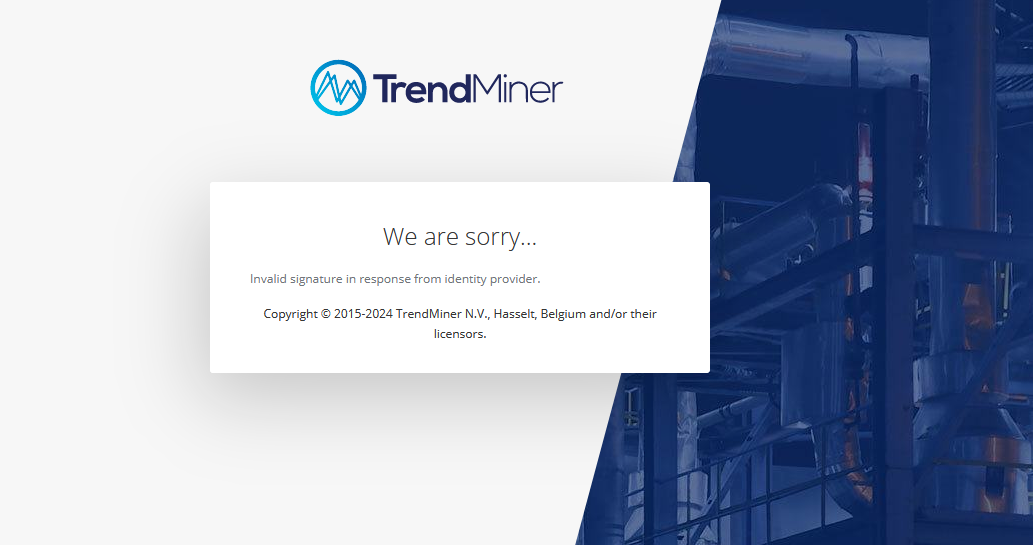

When you try to log in in TrendMiner but you see the following message on the login page: "Invalid signature in response from identity provider" it is likely that your SAML/SSO certificate is expired.
saml-sso-invalid signature in response from service provider

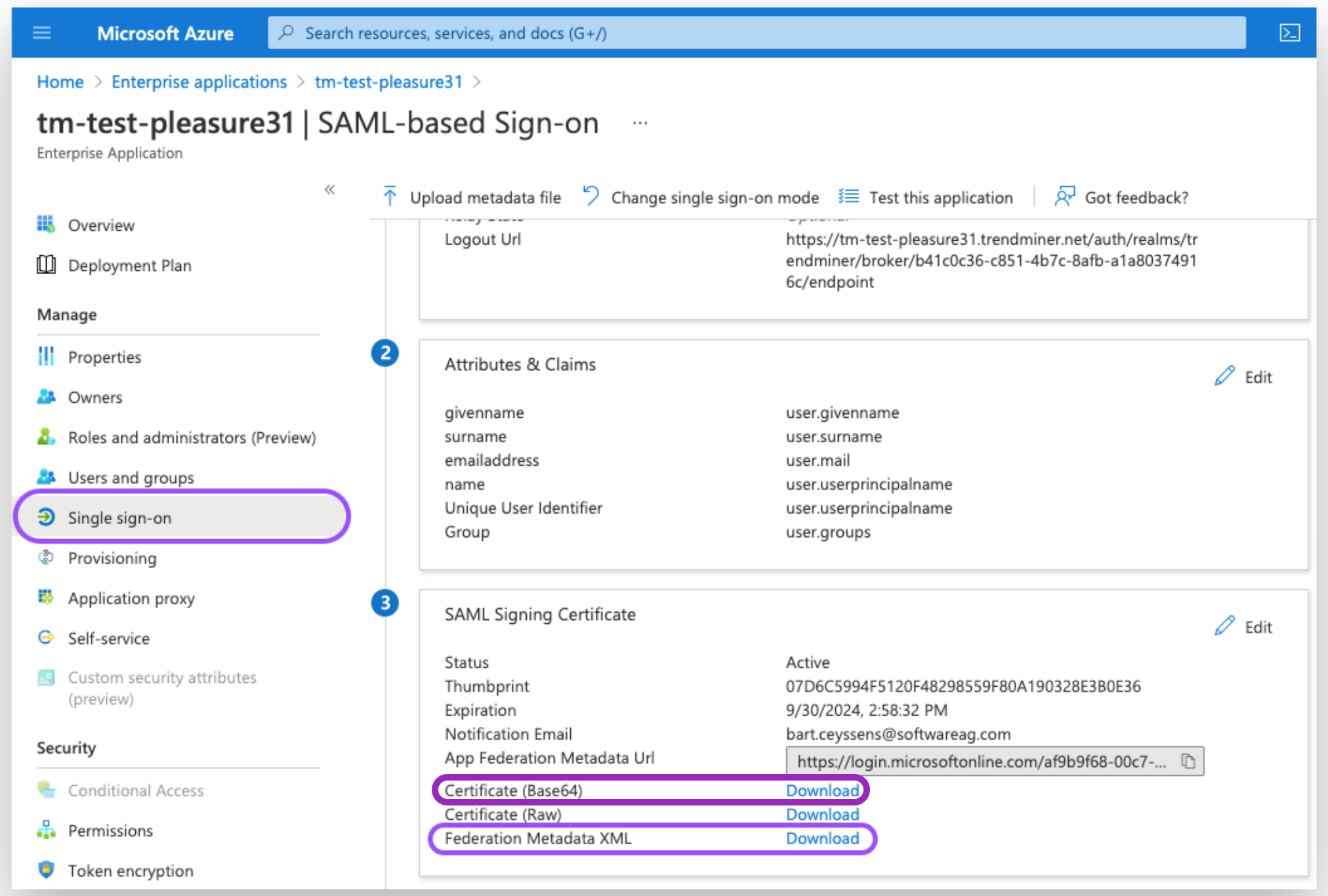

To renew the certificate, download a new certificate and federation data xml file from your SAML provider and upload it in TrendMiner. The following procedure documents this in detail for Entra ID (Microsoft Azure):
  1. Download the Base64 certificate and Federation Metadata XML file from Azure

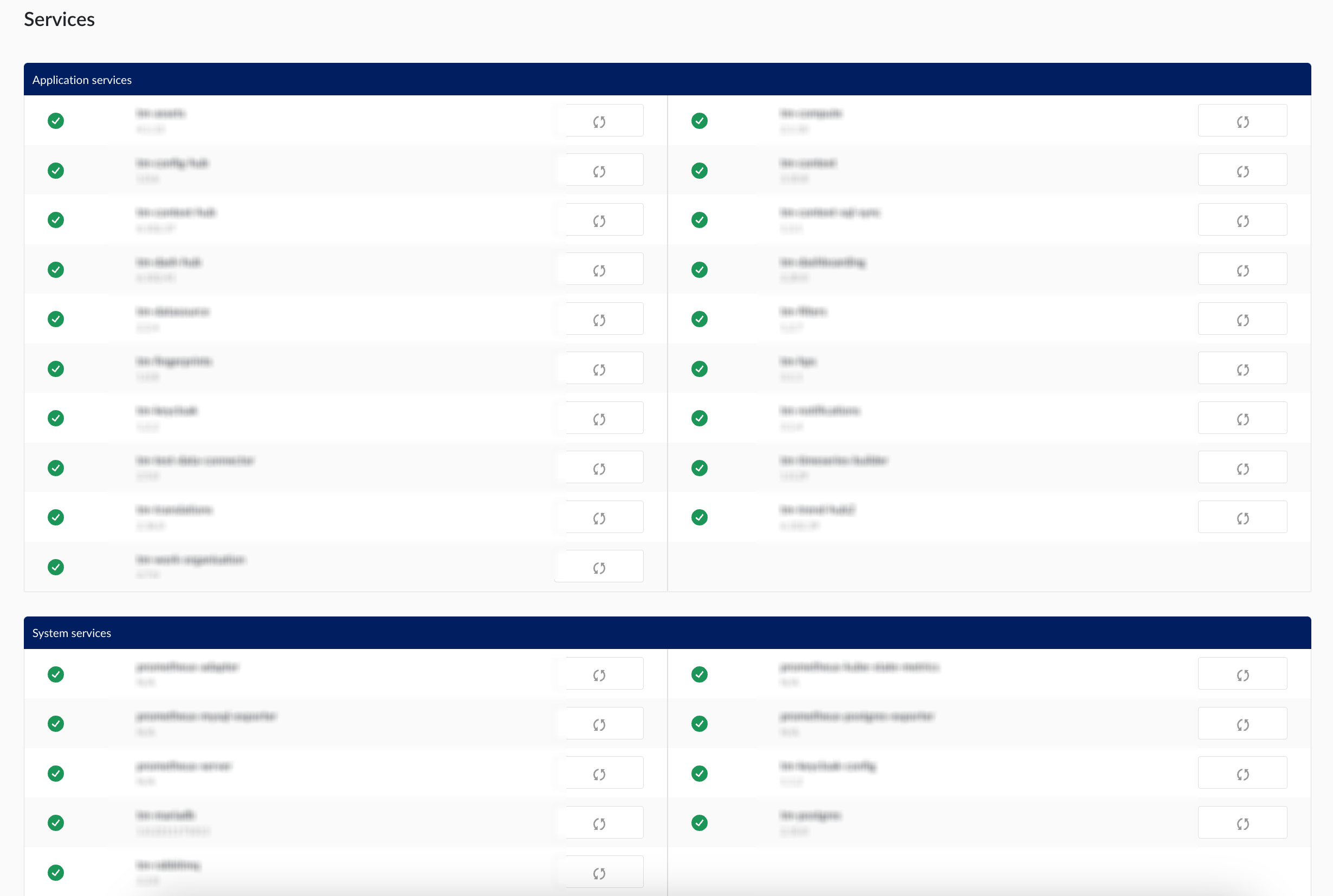

  3. Restart the tm-keycloak service in ConfigHub/Edge Manager -> Services for the certificate to show up

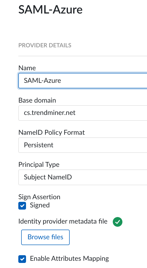

  4. In ConfigHub, go to Identity Providers and click on your SAML IdP. Click on options and edit the connection, browse files and upload the new metadata here and hit save
    saml provider details

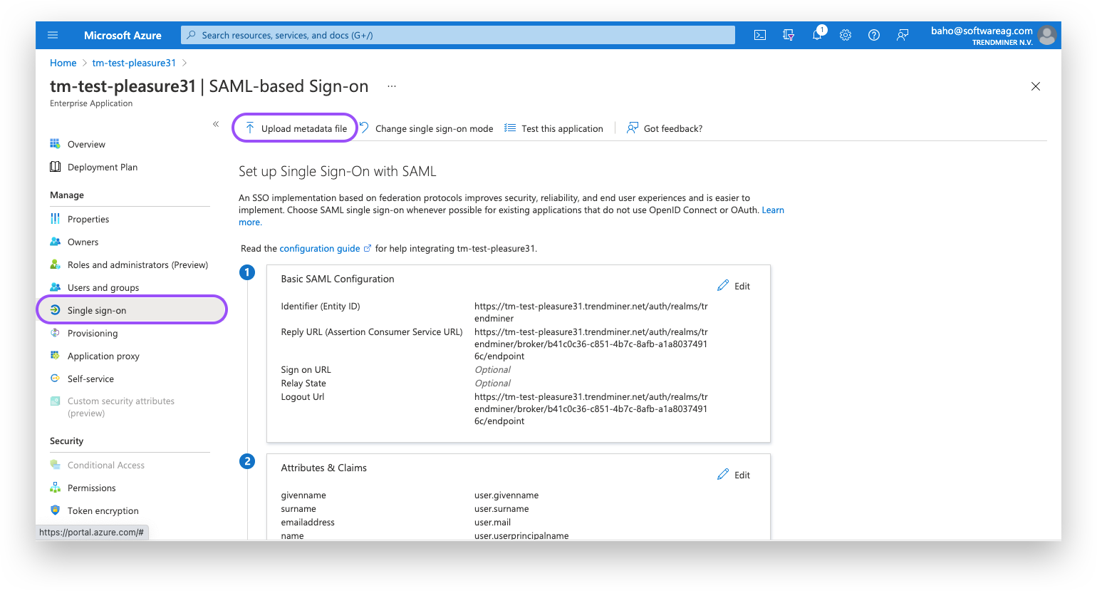

  6. Upload the TrendMiner metadata in Azure
    saml azure upload metadata
  7. Restart the tm-keycloak service in ConfigHub/Edge Manager
