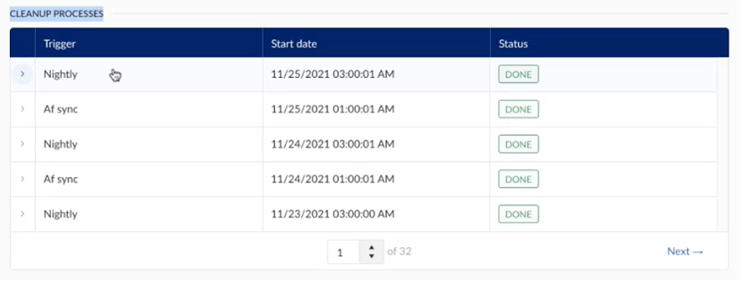

There are two automatic triggers for cleanup processes: the nightly cleanup, which runs every night, and the automatic resync of items without a component, triggered after an AF sync finishes.
Nightly sync
The automatic nightly resync of open items appears as an active job on the diagnostics screen once it starts. Every night, the system checks for context items that have been open for more than 24 hours, meaning they have a start date but no end time, indicating they are still open.
Items open longer than 24 hours may suggest the start event was successful, but an issue occurred during the closing event, preventing the context item from closing properly.
During the nightly cleanup, context items that should be closed will be updated. If they are not closed, they will remain open until an end event is received from the source.
Nightly syncs run automatically by default. If needed, you can trigger a manual cleanup from the data source settings in ConfigHub. For more details, refer to the "Data Source" section above.

A cleanup process for context items is triggered when either an AF sync, started from asset-capable data sources in ConfigHub, or an AF import, initiated by TrendMiner admins in ContextHub, completes successfully.
When assets are added or removed from the source AF, the AF sync identifies the differences and updates the TrendMiner AF accordingly. This triggers an automatic resync of context items without an associated component, which will appear as a scheduled job in the diagnostics screen.
