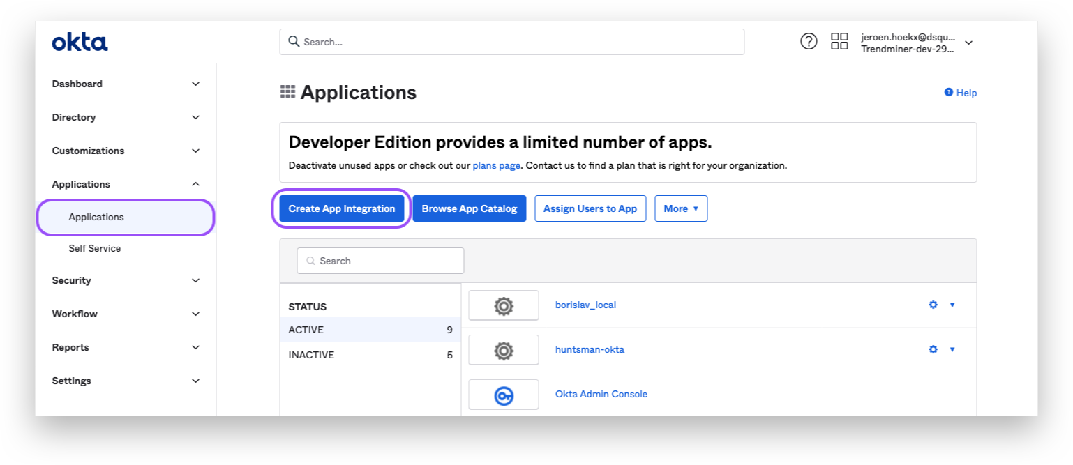

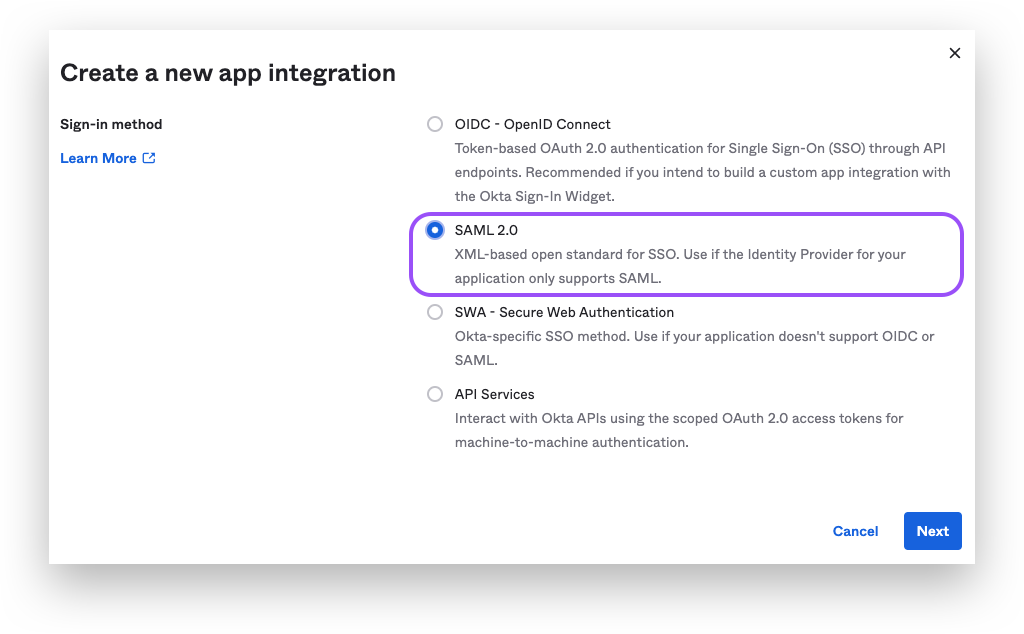

  1. Create a new App Integration via the application menu.
  2. Choose the SAML2.0 option.

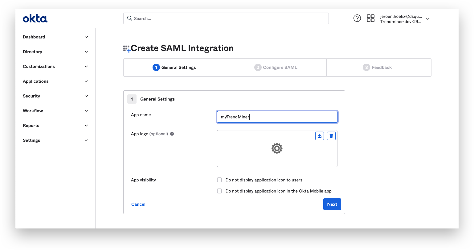

  3. Fill in your "App Name" and click next.

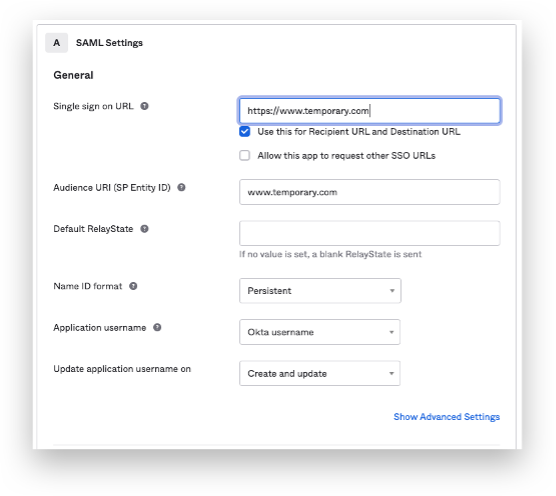

  4. Fill out the details for the SAML settings and click on next when finished.
    1. General settings:
      • Single sign on URL: Start by entering a temporary value. This will be overwritten at a later time.
      • Audience URI: Start by entering a temporary value. This will be overwritten at a later time.
      • Name ID format: Set to format of choice.
      • Application username: Okta username

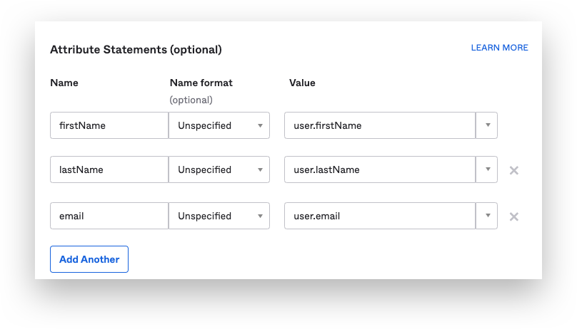

    2. Add the following Attribute statements:
      • firstName / unspecified / user.firstName
      • lastName / unspecified / user.lastName
      • email / unspecified / user.email

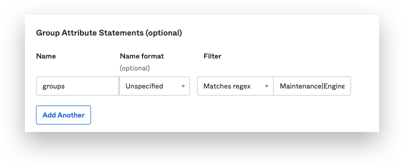

    3. Add a Group statement. This is required when you want to use Okta groups to set up data permissions in TrendMiner. You have the choice of entering different types of Filters. In the example below, groups that match the regular expression "Maintenance|Engineering" will be sent to TrendMiner. Note that this is just an example and needs to be modified to match the specific groups and structure of your organization.

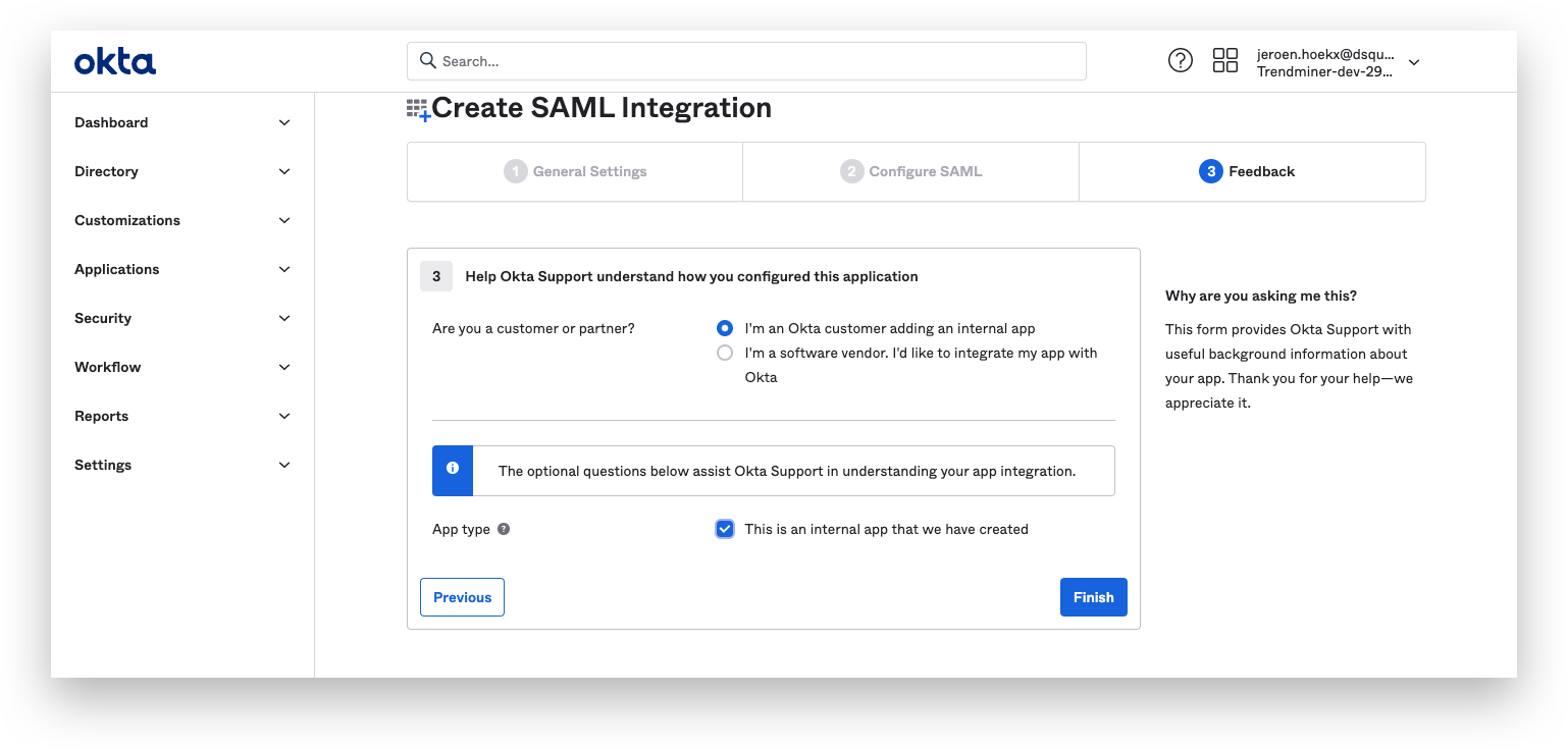

  5. Select "I'm an Okta customer adding an internal app" + the "This is an internal app that we have created"-checkbox and click "Finish".

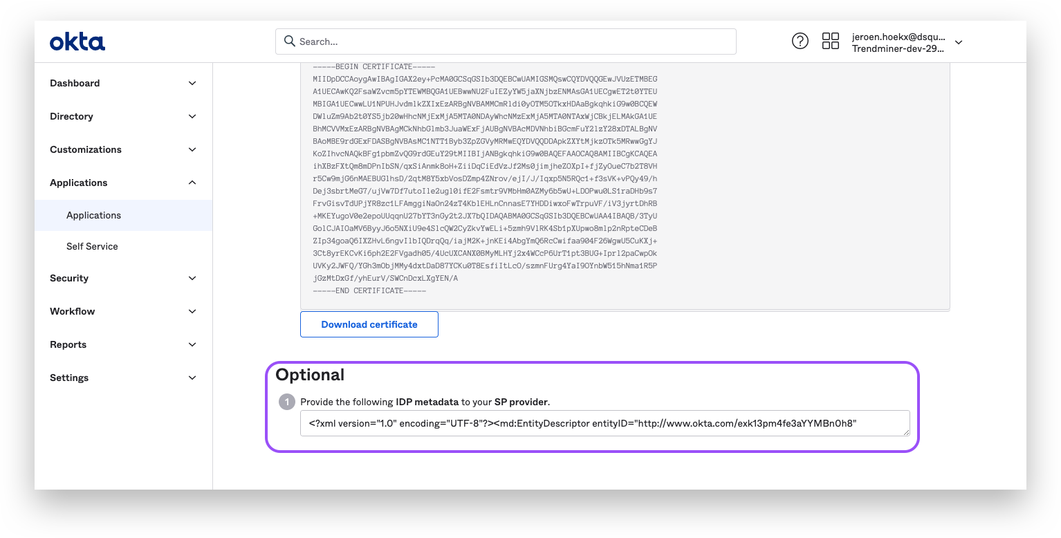

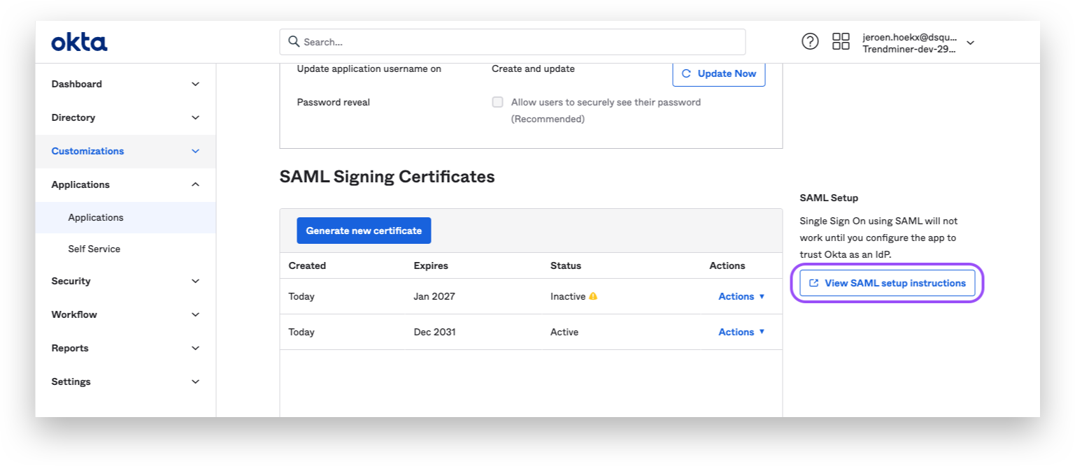

  6. Fetch the Federation Metadata XML:
    1. Click the "View SAML setup instruction"-button from the "sign on"-tab of your application.
    2. Scroll down and copy the IDP metadata.
    3. Paste the IDP metadata in a text file and save it with a ".xml"-extension.

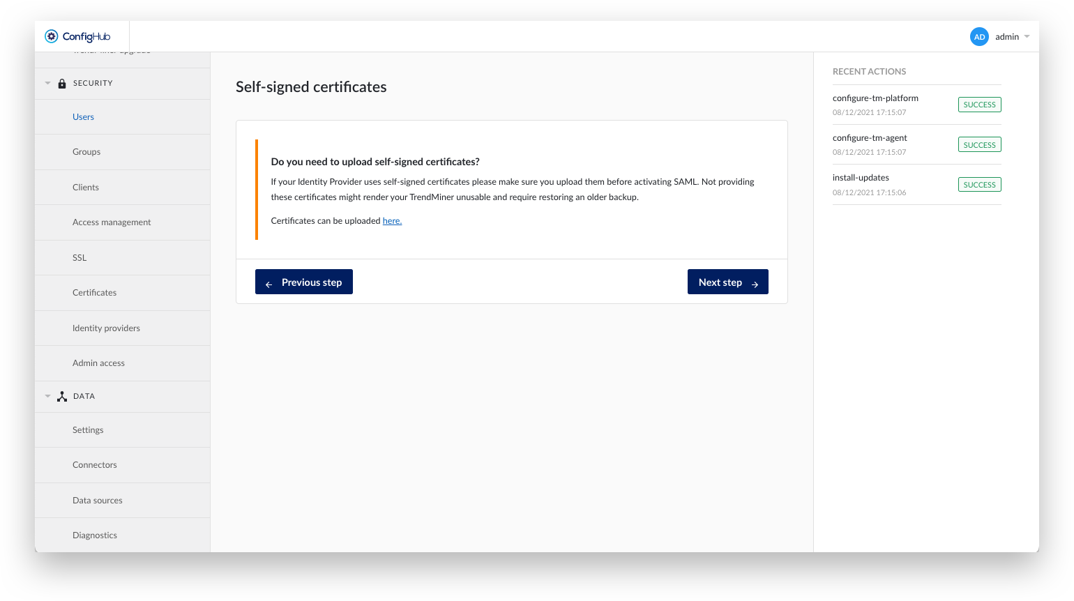

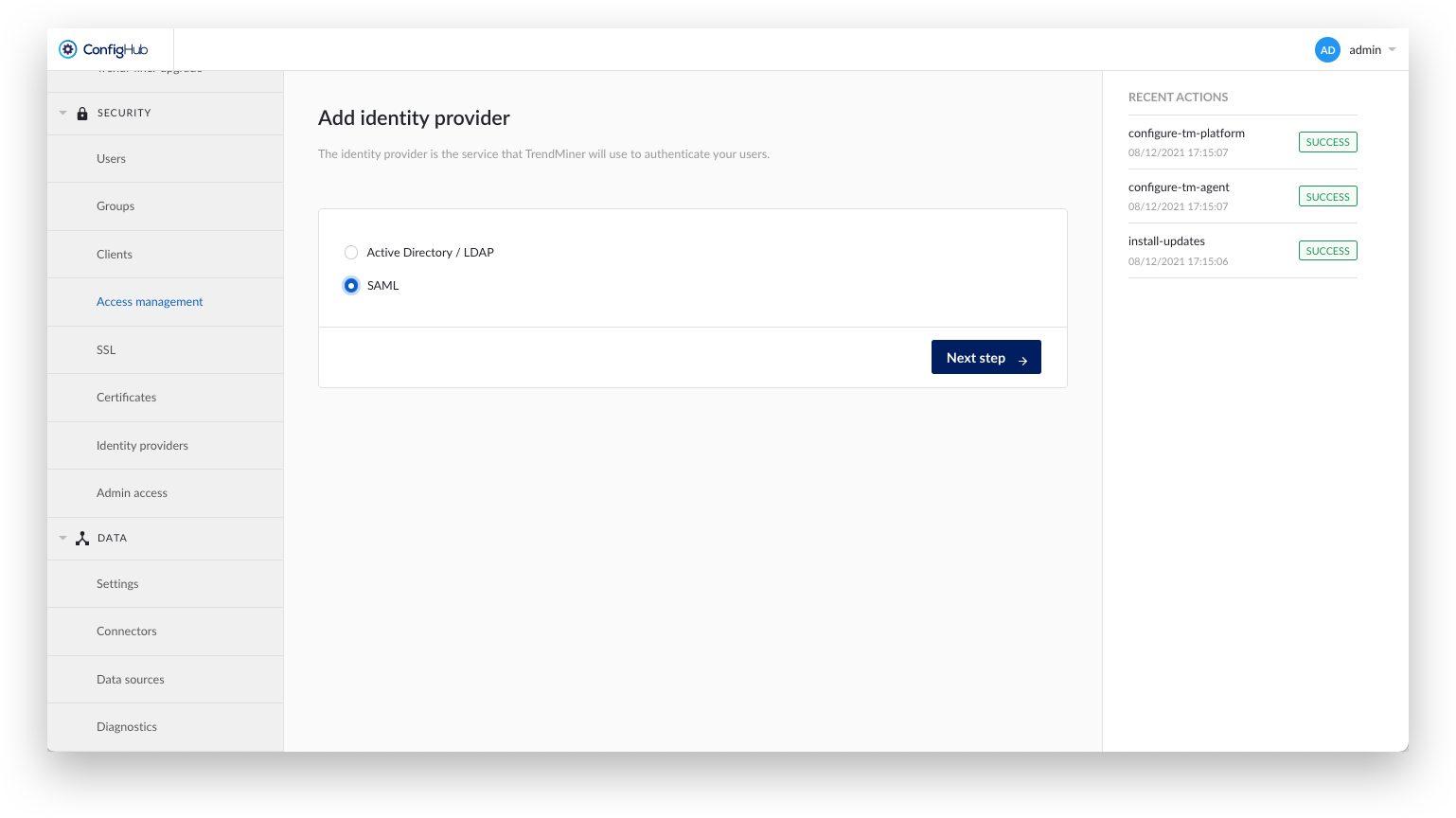

  3. Select the SAML option.

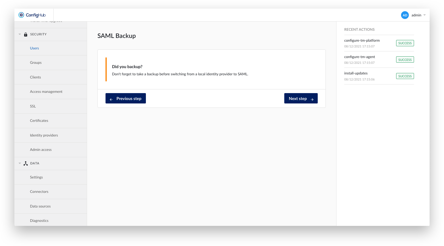

  4. Create a TrendMiner backup.

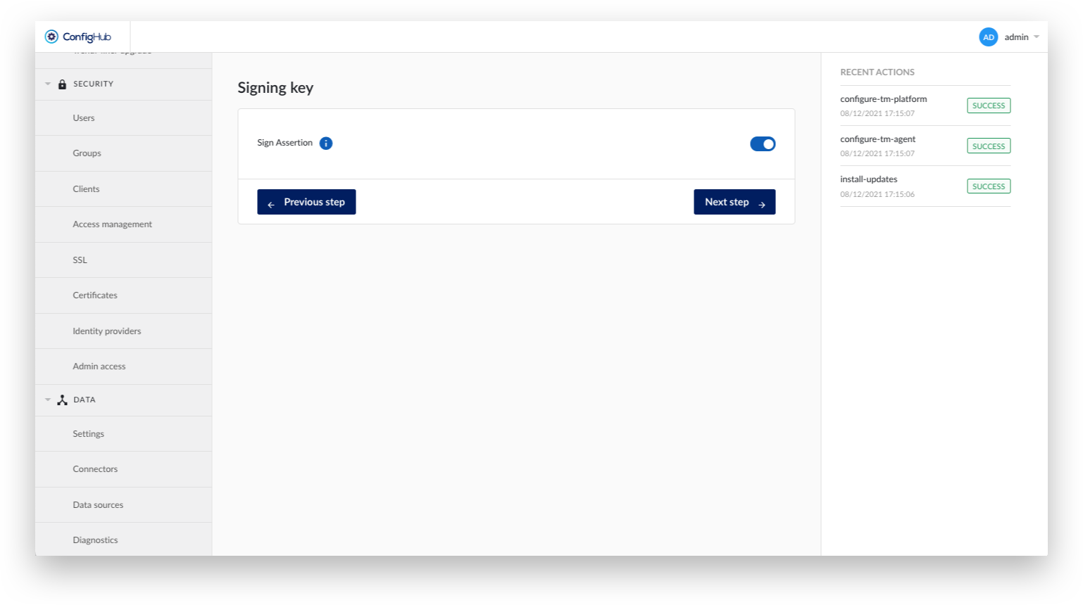

  6. Indicate whether a signed Assertion is expected.

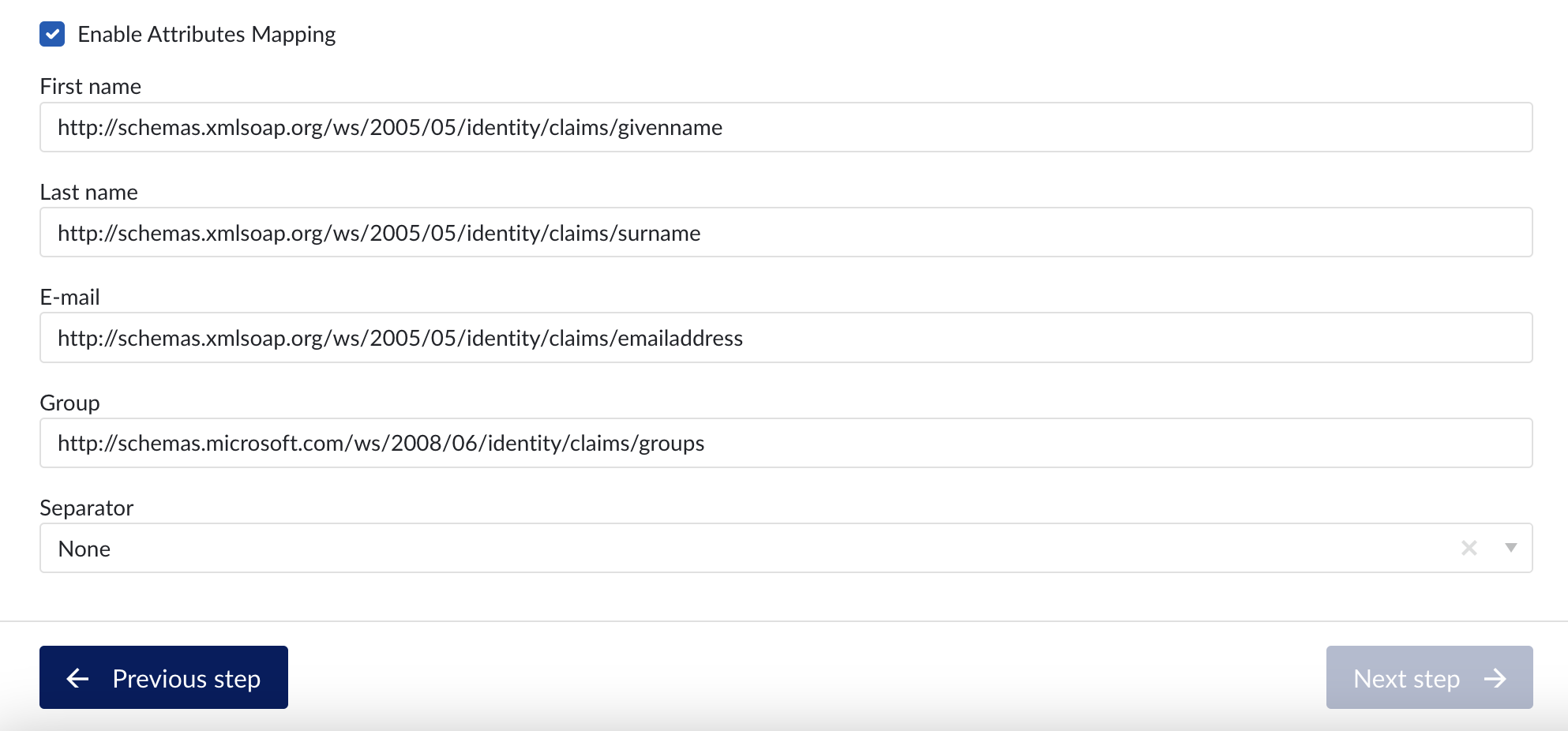

    • Enable Attributes Mapping: Optional setting to map SAML assertions into ConfigHub. Note that the mappings need to correspond with the attribute names used from the IdP (see previous section).
      For Azure, this corresponds to the claim name, e.g.
      • First name: http://schemas.xmlsoap.org/ws/2005/05/identity/claims/givenname
      • Last name: http://schemas.xmlsoap.org/ws/2005/05/identity/claims/surname
      • E-mail: http://schemas.xmlsoap.org/ws/2005/05/identity/claims/emailaddress
      • Group: http://schemas.microsoft.com/ws/2008/06/identity/claims/groups
      For Okta this corresponds to the given names in the previous steps (e.g. firstName, groups,…).

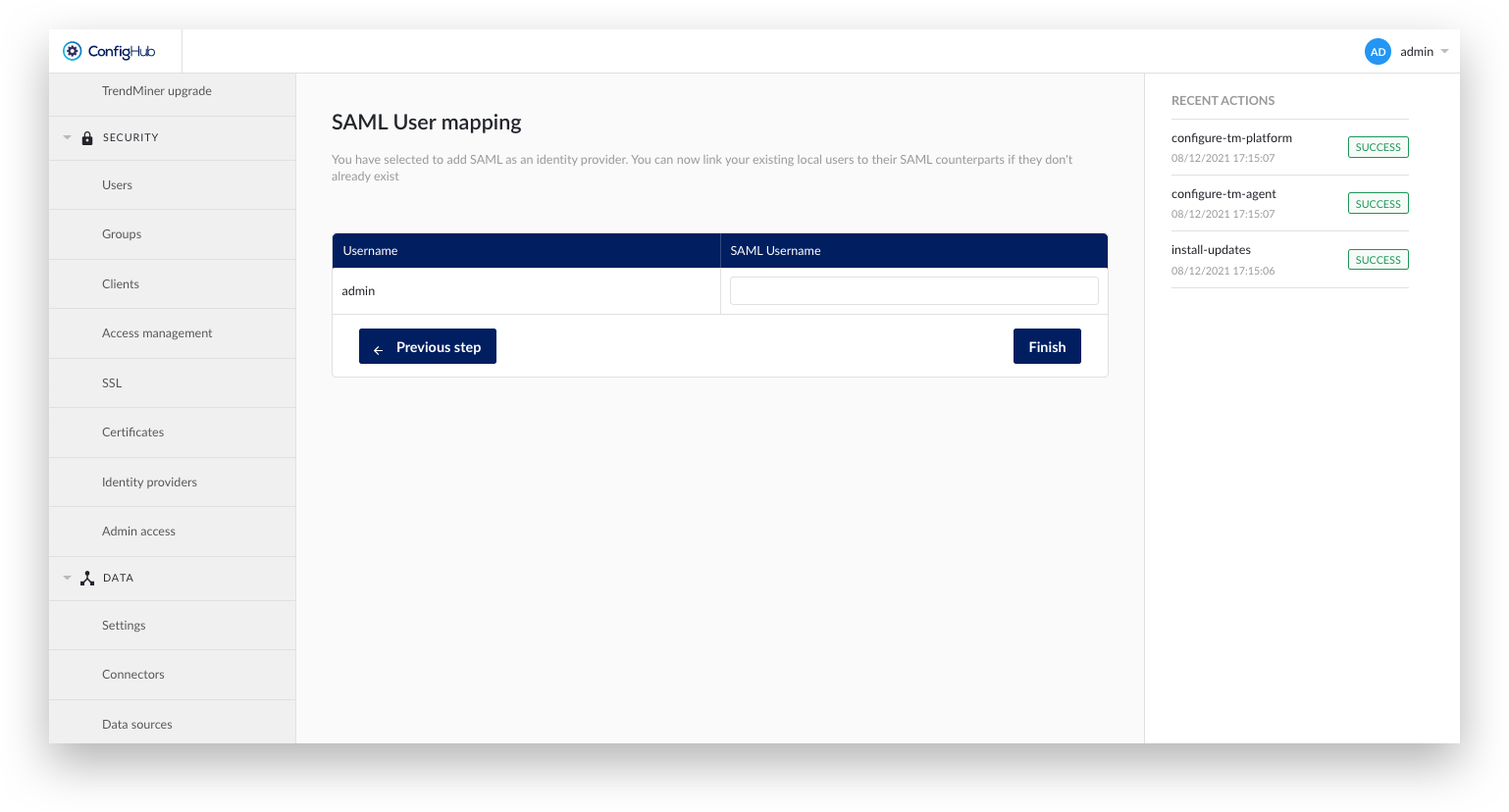

  8. The next screen allows mapping existing (local) TrendMiner users to the SAML provider. The SAML username should correspond to the value returned by the IdP in the Subject-NameID tags. TrendMiner requests the NameId in the following format:

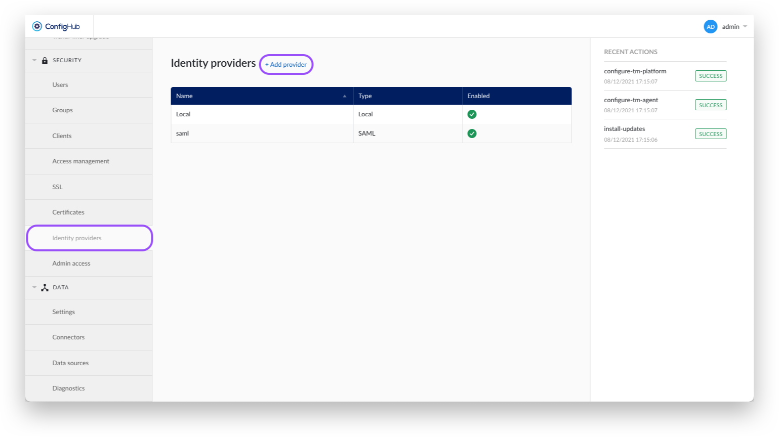

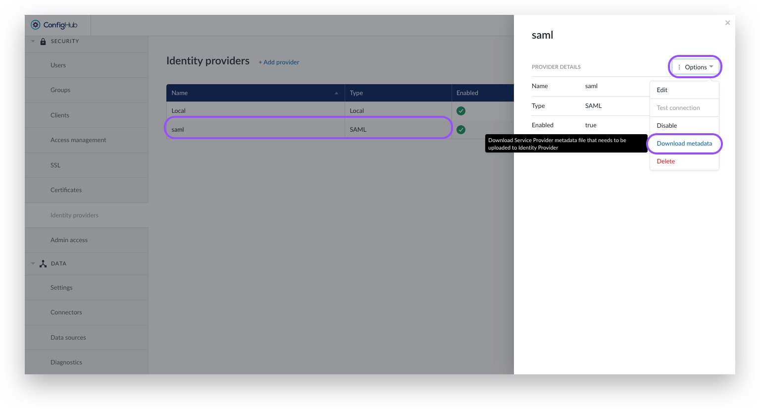

  9. After creating the identity provider in ConfigHub it is time to download the metadata file and go back to the identity provider.
    1. Go back to the "Identity Providers" tab in the "Security" section in ConfigHub. You should be able to see your created provider listed.
    2. Click on your newly created provider. A side panel will pop open.
    3. Click the options-button.
    4. Click the download Metadata button. This metadata file contains the remaining configuration on the IdP side.
      saml download metadata

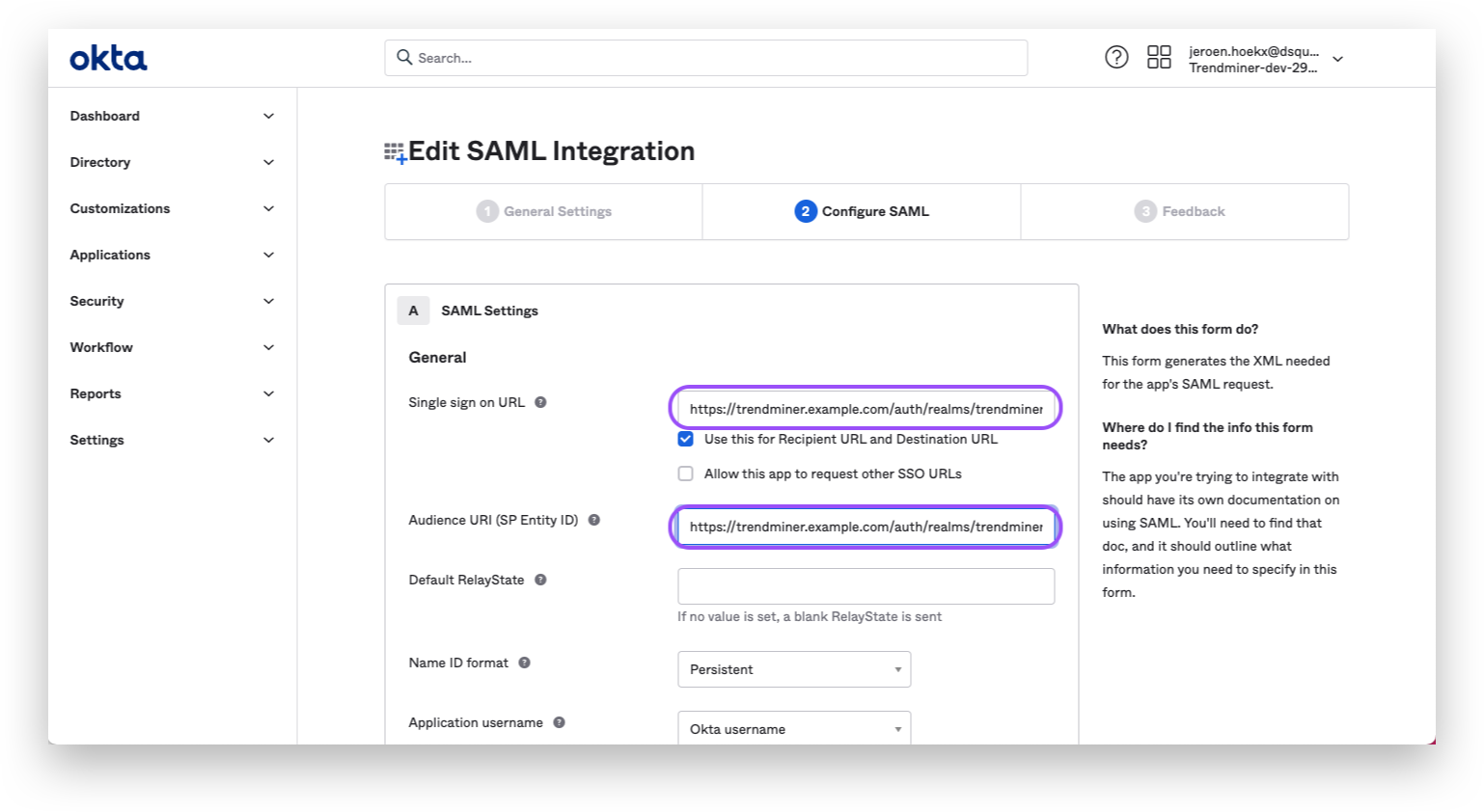

  2. Copy the Location value from <md:SingleLogoutService>. In this example, this corresponds to: https://trendminer.example.com/auth/realms/trendminer/broker/7fc6524e-3d55-4ae2-9edf-3d678e376063/endpoint. This URL needs to be added in OKTA.

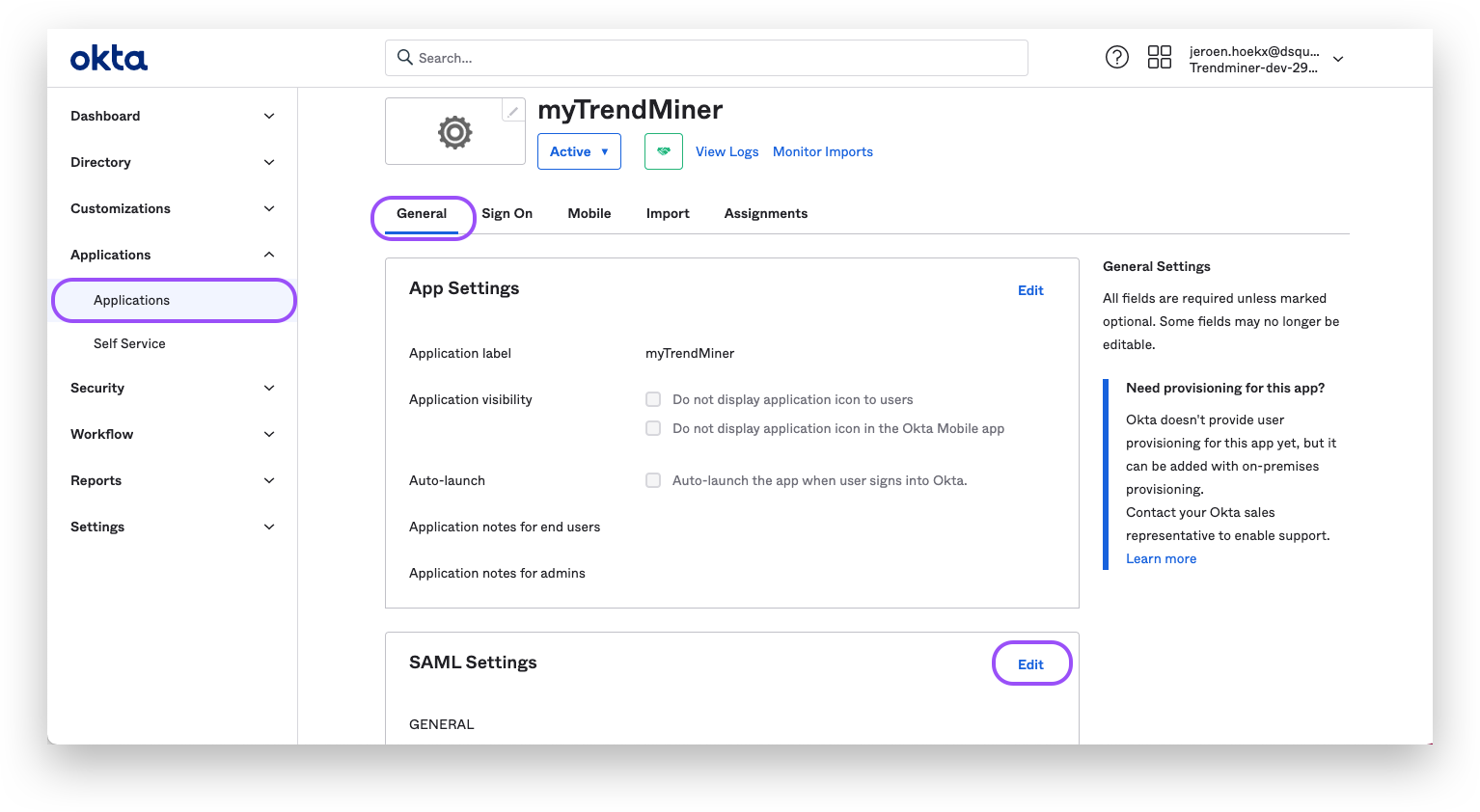

  3. Navigate to your application in Okta and open the "General"-tab.
  4. Click "edit" for the SAML settings and proceed to step 2 "Configure SAML".
  5. Change the "Single sign on URL" and "Audience URI" to the copied URL.
  6. The SAML setup is complete and you should be able to login in TrendMiner. After logging in with a SAML user in TrendMiner the assigned groups should be synced and ACLs can be configured.
