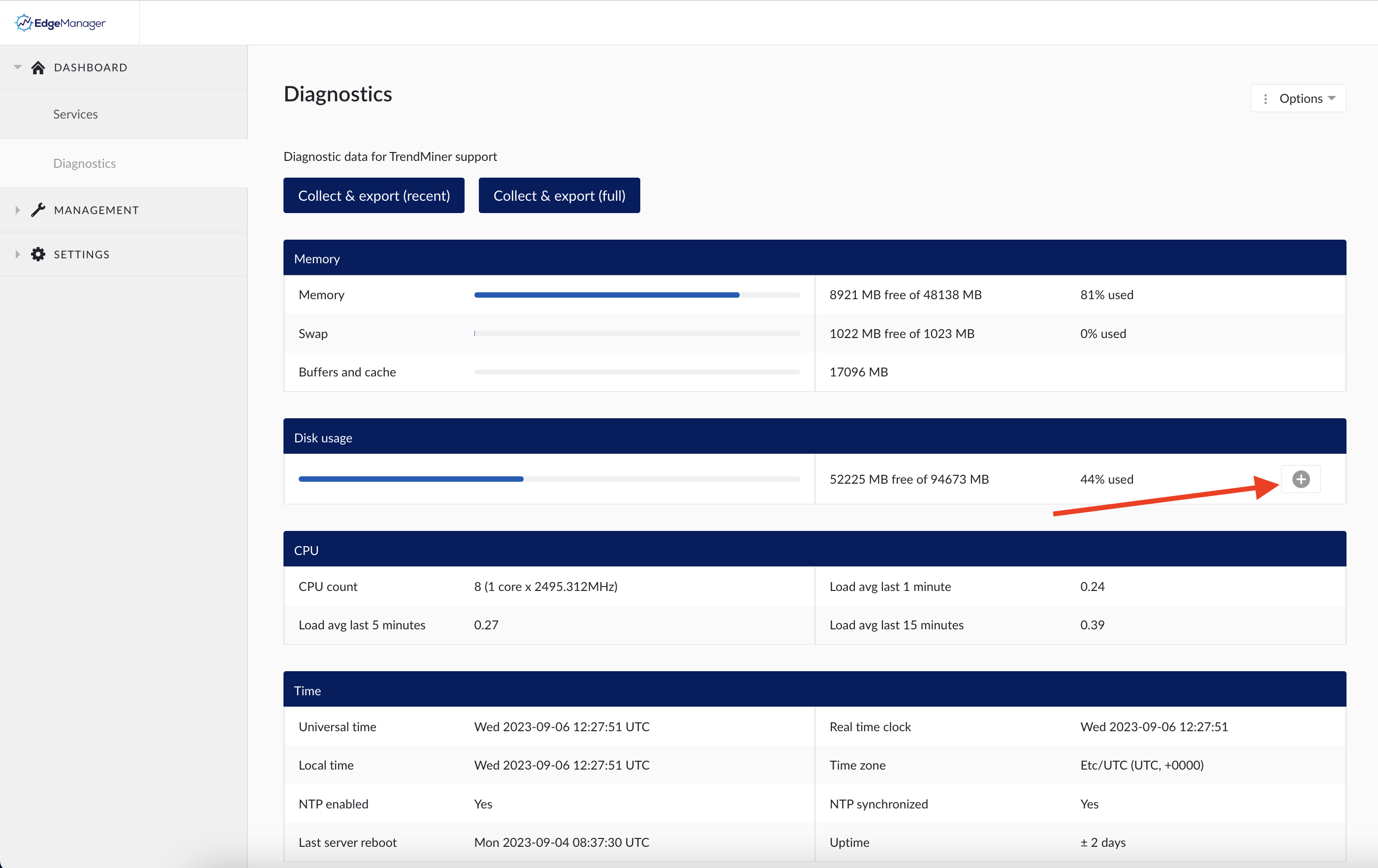

  2. Expand the ‘DASHBOARD’ section and click ‘Diagnostics’.
    edge_manager_diagnostics_2023.R3.0
  3. Under the ‘Disk usage’ section, click the ‘+’ icon to start the disk extension process.

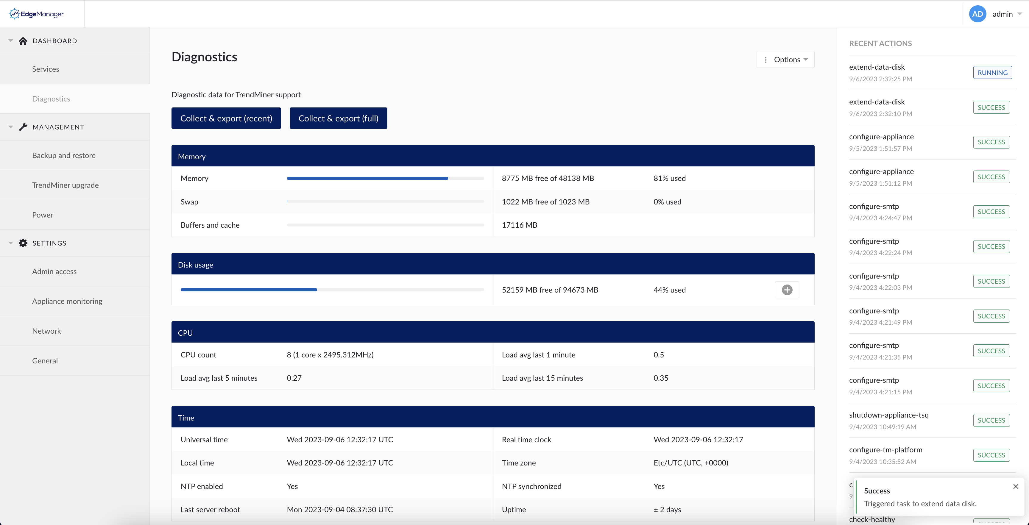

  4. Click ‘Yes, extend’ to confirm the choice.
  5. A green message on the bottom right will say ‘Triggered task to extend data disk’ and a new task 'extend-data-disk' will show up in the ‘Recent Actions’ panel on the right.
    extend_disk_confirmation-2023.R3.0
  6. Wait until the ‘extend-data-disk’ status changes to ‘SUCCESS’. TrendMiner is now able to use the extra disk space.
