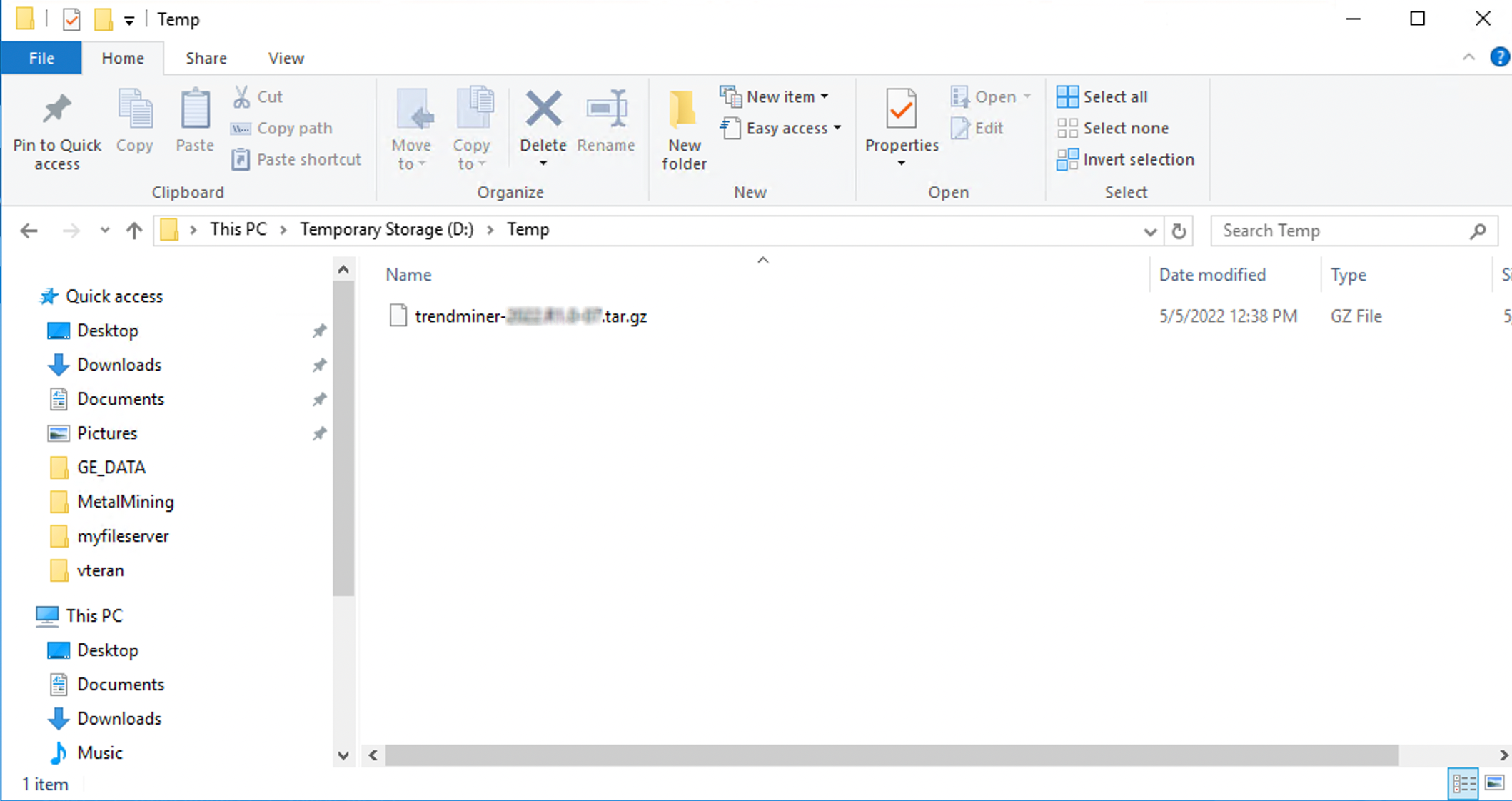

The TrendMiner Virtual Appliance does not yet contain the TrendMiner software. The TrendMiner software should be downloaded from the TrendMiner download site as a trendminer-<version>.tar.gz file.

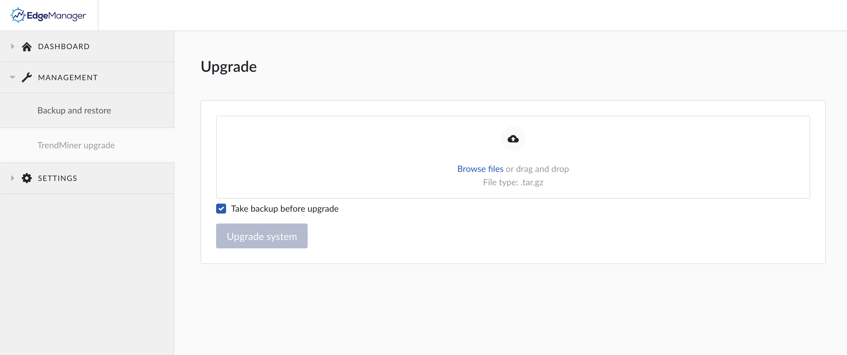

Browse to http://<ip>:8080
Under ‘TrendMiner upgrade’ click ‘Browse files’.
Select the .tar.gz file containing the TrendMiner software and choose 'Open'.
Click ‘Upgrade system’ to start the installation process.
