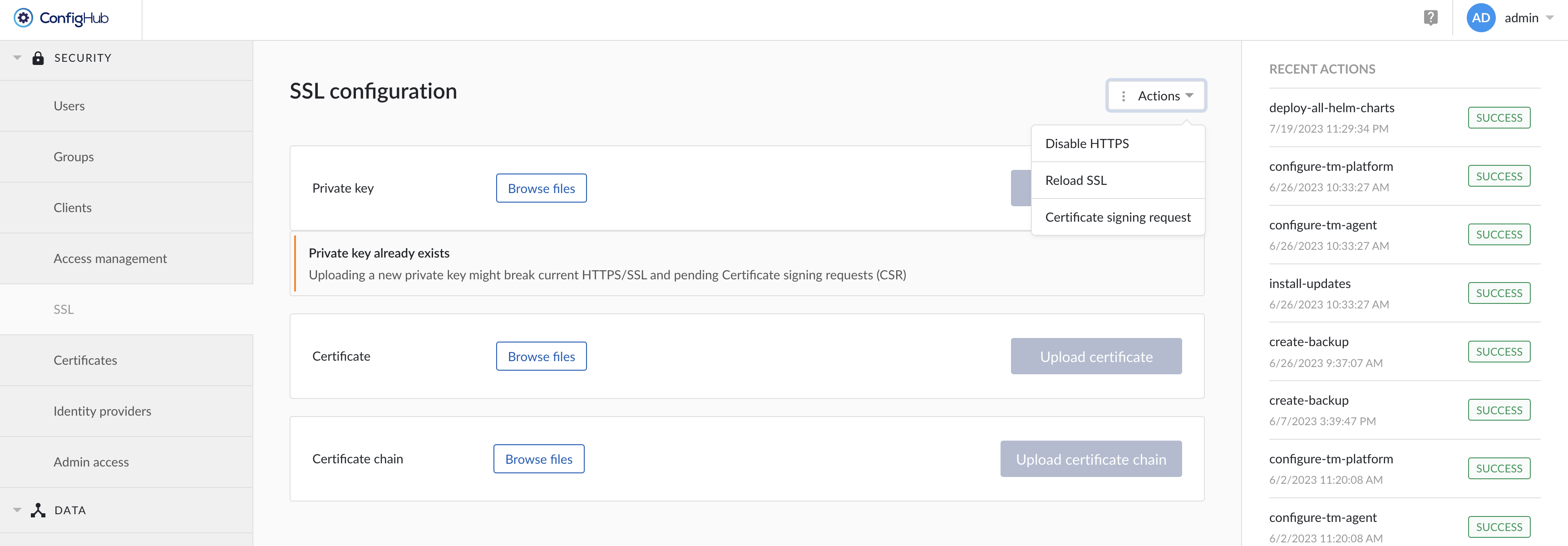

Option 2: In Edge Manager -> SSL -> Actions you'll find the option to generate and download a CSR.
When a CSR is generated on the TrendMiner server the private key stays on the server and does not need to be uploaded anymore when the SSL certificates are uploaded.
Uploading a new private key might break the current HTTPS/SSL and pending Certificate signing requests (CSR).
