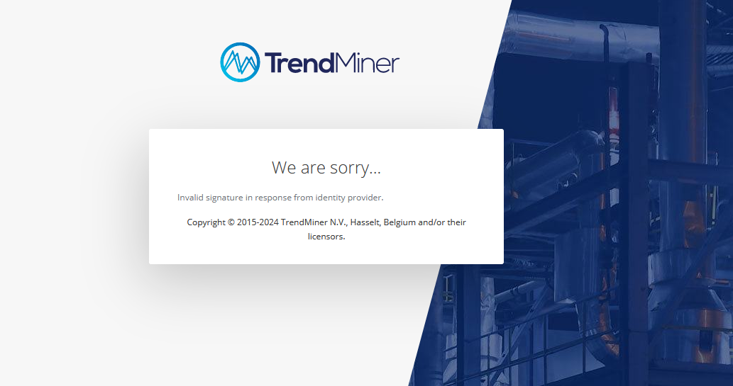

When you try to log in in TrendMiner but you see the following message on the login page: "Invalid signature in response from identity provider" it is likely that your SAML/SSO certificate is expired.

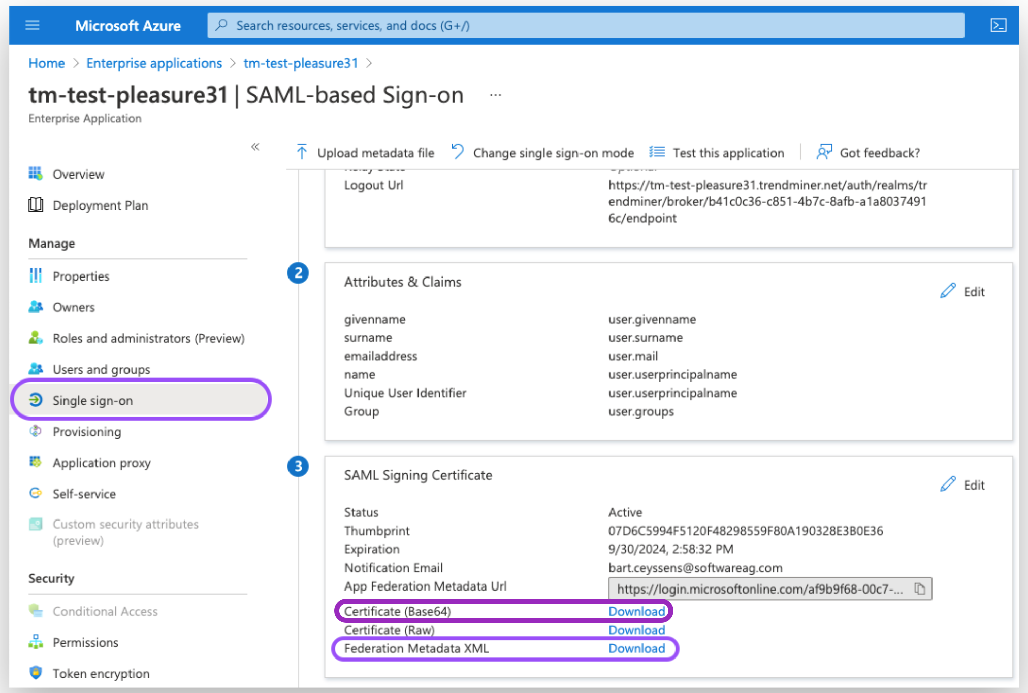

To renew the certificate, download a new certificate and federation data xml file from your SAML provider and upload it in TrendMiner. The following procedure documents this in detail for Entra ID (Microsoft Azure):
Download the Base64 certificate and Federation Metadata XML file from Azure

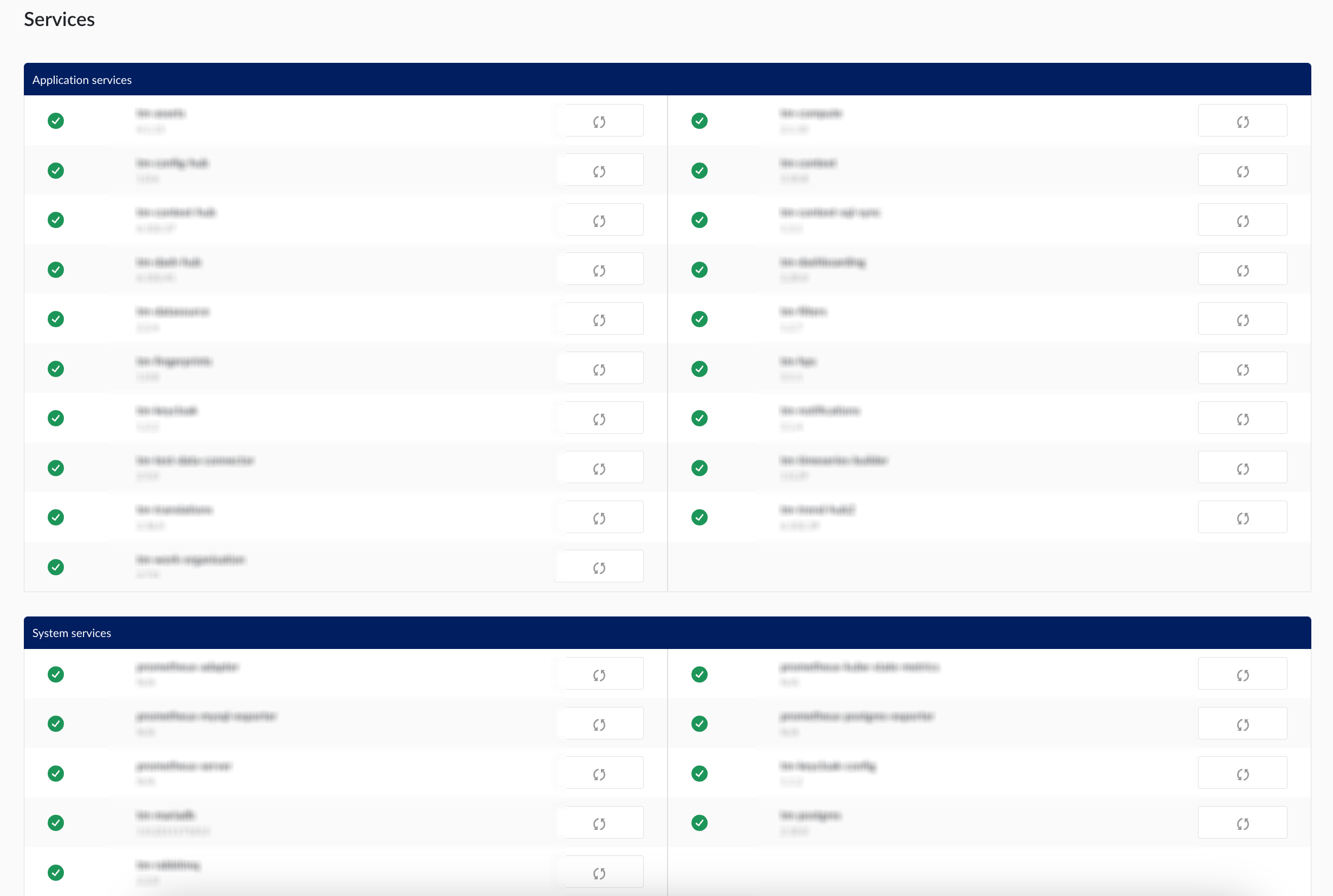

Restart the tm-keycloak service in ConfigHub/Edge Manager -> Services for the certificate to show up

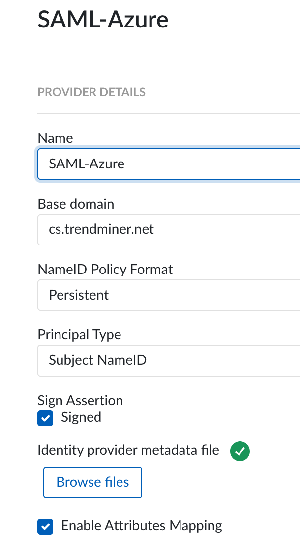

In ConfigHub, go to Identity Providers and click on your SAML IdP. Click on options and edit the connection, browse files and upload the new metadata here and hit save
