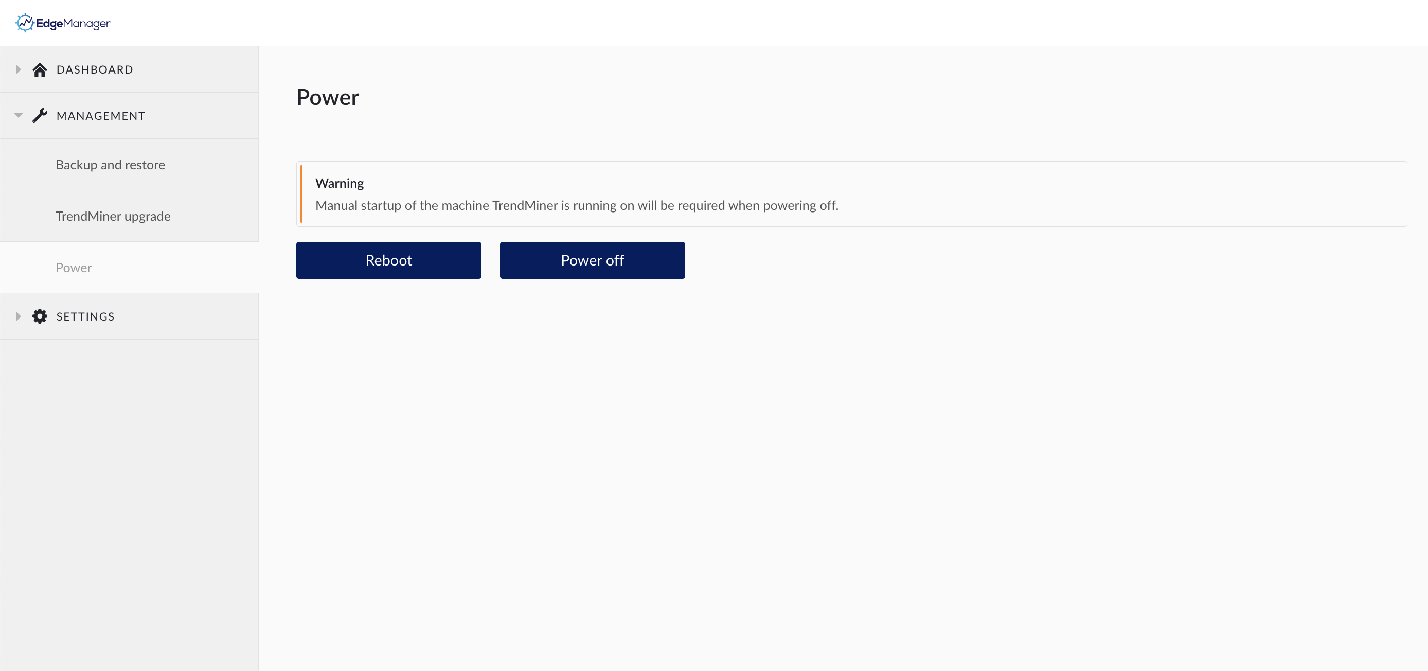

Reboot the TrendMiner Appliance after the upgrade to ensure OS patches are applied. Validate that TrendMiner is up and running after the reboot.
- When not using the TrendMiner Virtual Appliance, please follow the existing internal procedure to reboot the server. - When using the TrendMiner Virtual Appliance reboot from the Edge Manager portal. Expand the ‘MANAGEMENT’ menu and go to the ‘Power’ section. Click ‘Reboot’ button.
- Once rebooted, make sure all the services are healthy in the 'DASHBOARD' -> ‘Services’ page. - Without MLHub:  - With MLHub:
