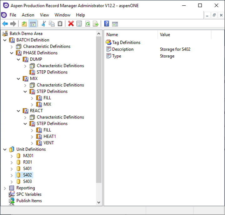

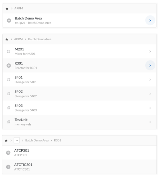

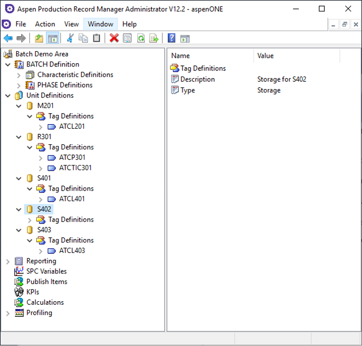

Our provider for Aspen Production Record Manager implements the asset capability and uses data from the area definition to populate the asset hierarchy in TrendMiner. The root node of the asset hierarchy is the area itself. The children nodes of an area node are created using “Unit Definitions". The “Tag Definitions“ are the children of the unit nodes, and the leaf nodes of the asset hierarchy. The asset hierarchy has a fixed depth of two or three.
Area, Unit and Tag Definitions in Aspen Production Record Manager Administrator

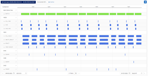

The link between the asset hierarchy and the context items is established using components in TrendMiner. The provider uses the Unit Characteristic from the subbatches of Aspen Production Record Manager to determine the component of a Context Item. The subbatch level where the Unit Characteristic is defined in Aspen Production Record Manager can be configured by the customer. Since a unit is generally a physical piece of process equipment, every child subbatch of the subbatch level which defines the Unit Characteristic is also conceptually linked to that unit. This is why the following logic is implemented in the provider:
- If a unit characteristic is defined on the subbatch level of the subbatch, the context item of this subbatch will be assigned to a component that represents the unit.
- If a unit characteristic is defined on a subbatch level lower than the subbatch - lower level means higher in the ancestor hierarchy, the unit characteristic is inherited from the unit of the ancestor.
- If a unit characteristic is not defined on a subbatch level lower than the subbatch, the context item will be assigned to a component that represents the area.
This comes into play when the user starts visualizing multiple subbatch levels at once. Together with the possibility to include the children of a component during filtering it would render the following Gantt, without the users knowing which units belong to the area.
Gantt

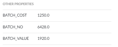

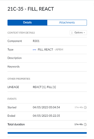

The provider generates Context Item properties based on the numeric Characteristics that are available on the subbatches of Aspen Production Record Manager. Only the numeric characteristics are included as Context Item properties, this is by design.
Since numeric characteristics are decimal values in Aspen Production Record Manager, Context Items properties are also formatted decimal numbers.
Context item properties

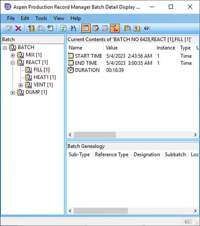

The Start Time, Duration and End Time Characteristics are available as Events. The existence of characteristics and the level on which they are defined is completely dependent on the configuration of the Subbatch Definition implemented on the customer environment.

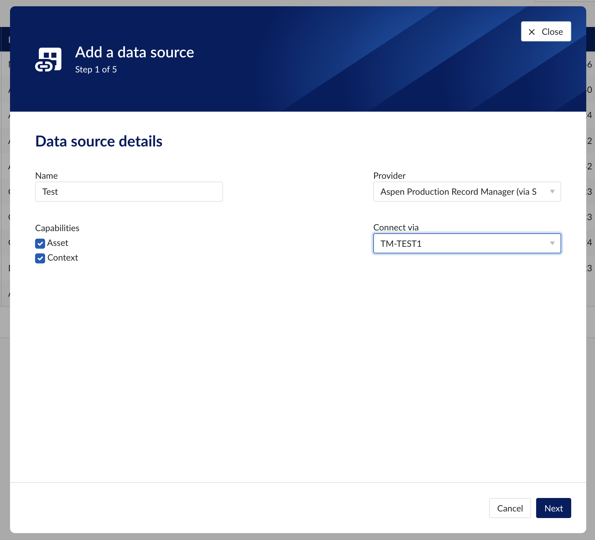

In ConfigHub go to Data in the left side menu, then Data sources, choose + Add data source. Fill out 'Data source details' on the first step of datasource creation wizard: type the name of a data source, select “Aspen Production Record Manager (via SDK)" from Provider dropdown, then select the configured connector from Connect via dropdown.

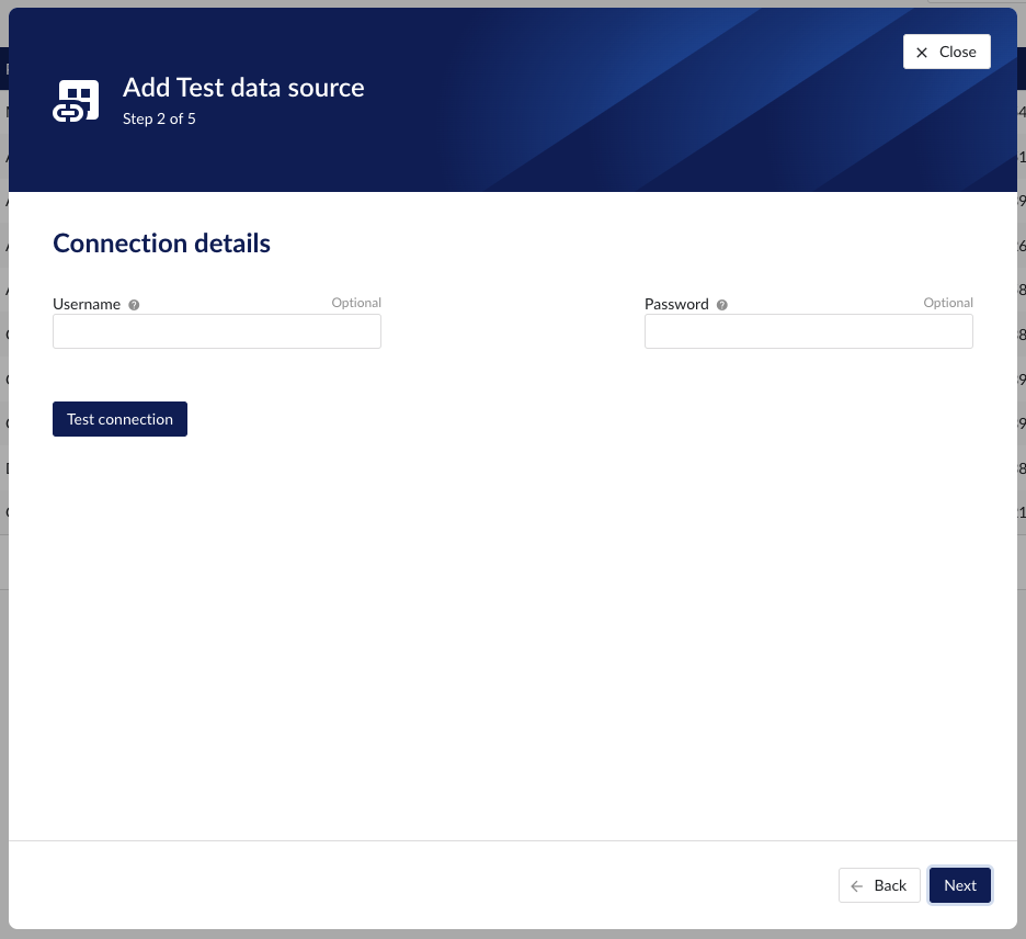

Connection details
To establish a connection 2 optional properties to be filled in:
| Property | Description |
| Username | Optional convenience field to enter the username used to establish a database connection. As an alternative this information can be entered through the driver properties. |
| Password | Optional convenience field to enter the password used to establish a database connection. As an alternative this information can be entered through the driver properties. |
Connection details step in datasource creation wizard

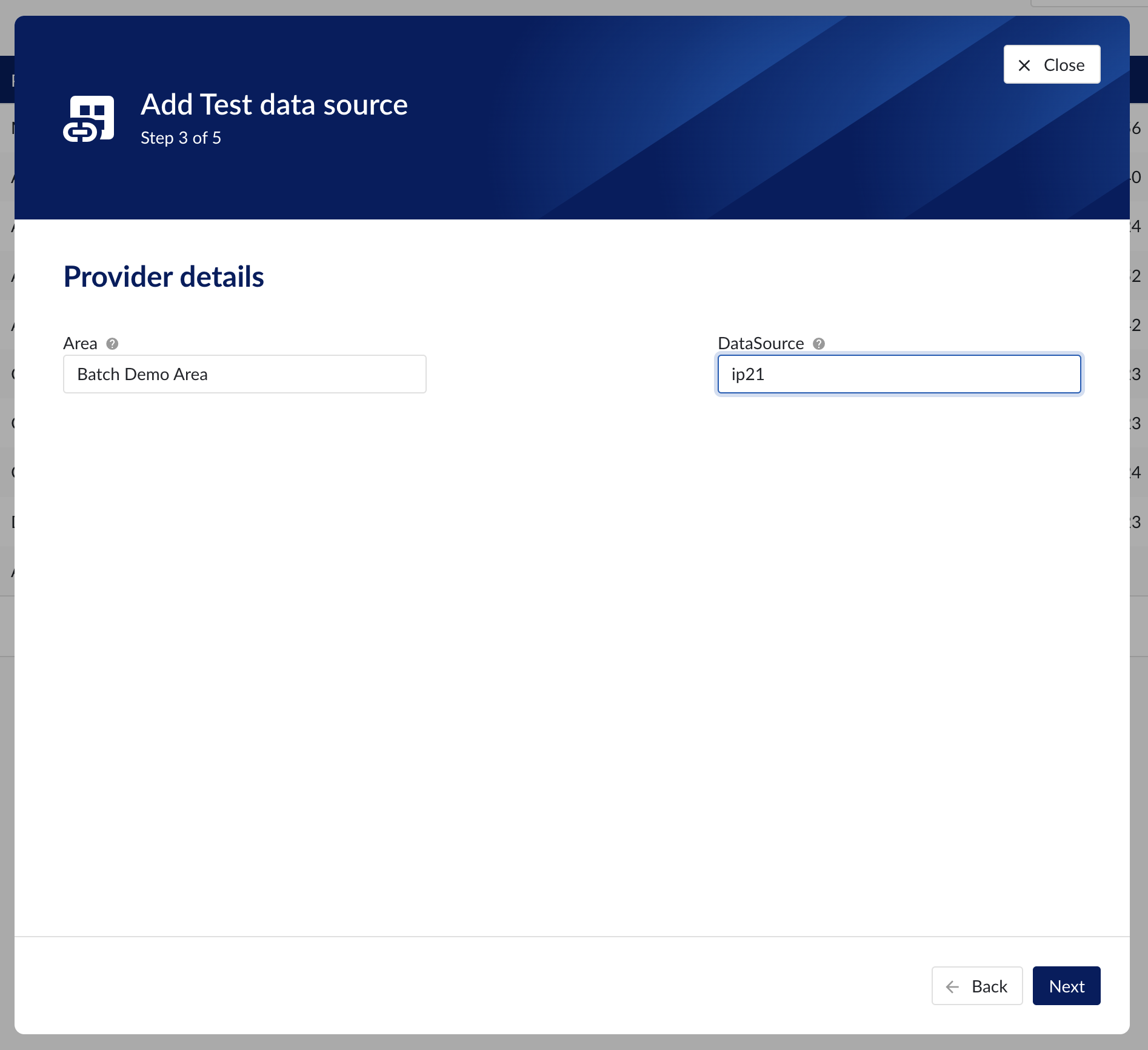

Provider details
The APRM provider implements both assets and context capability. These capabilities have two required provider properties to be filled in:
| Area | The name of the area inside the specified DataSource where the provider reads its data. |
| DataSource | The data source used by this provider. The AspenTech Production Record Manager can store multiple data sources on one server instance. |

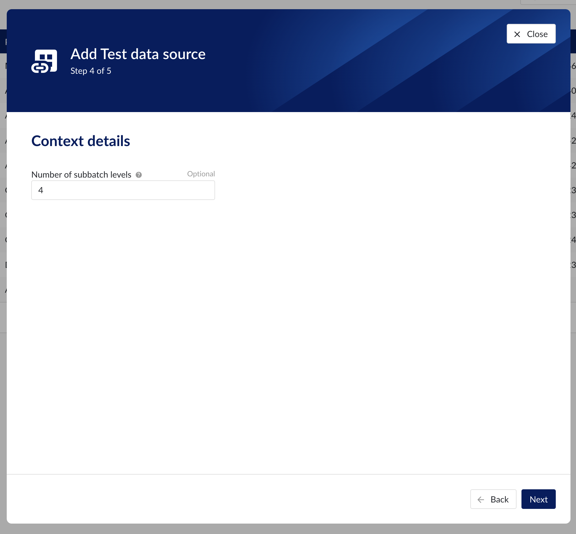

| NumberOfSubbatchLevels | Override the number of subbatches to read from the area.This must be a number between (inclusive) 1 and 5. By leaving this property empty, all the levels defined in the area are included (APRM has a limit of 5 levels). |
Context details step in datasource creation wizard
