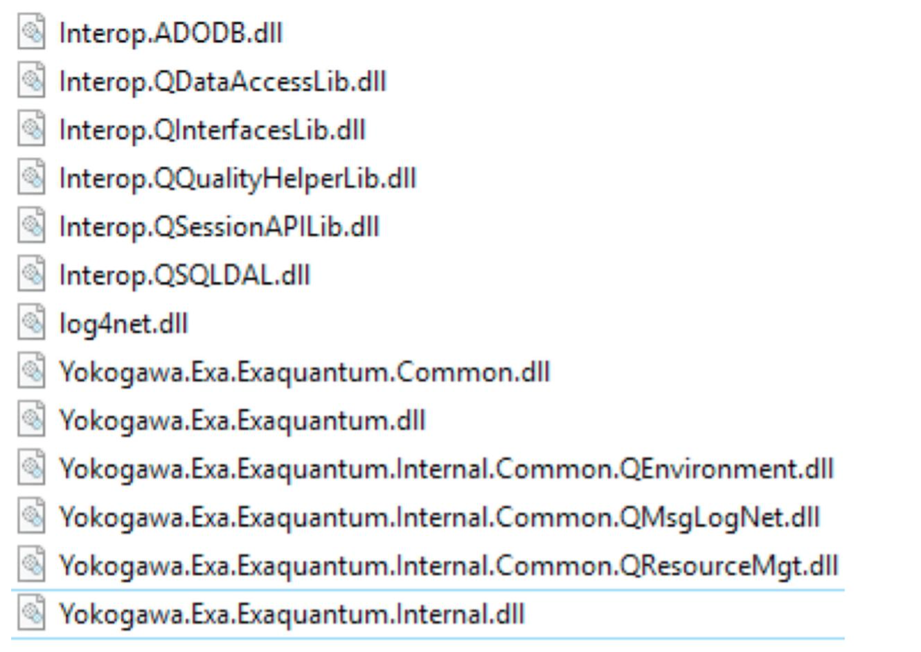

- Copy the following .dll files from Yokogawa Exaquantum server to the installation's bin folder. The default location would be: C:\inetpub\PlantIntegrations\bin
