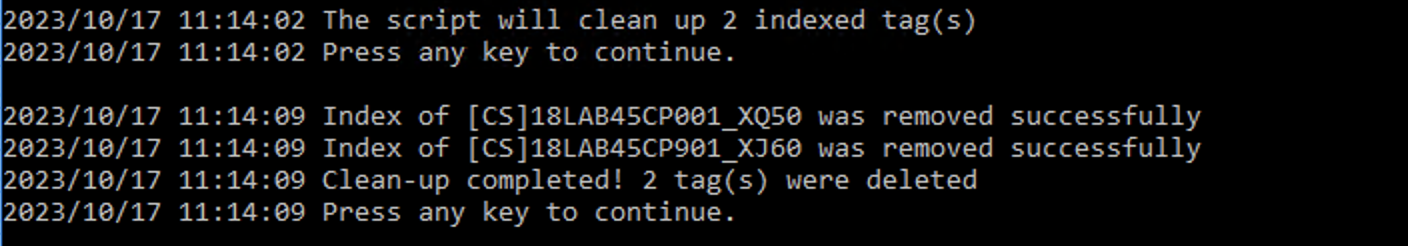

clean-index.exe -config config-clean.json -name "[CS]18LAB*" -status STALE
clean-index.exe -config config-clean.json -status FAILED
When the script runs it will first show feedback on how many indexes will be deleted. Press ENTER to proceed and clean these indexes.
