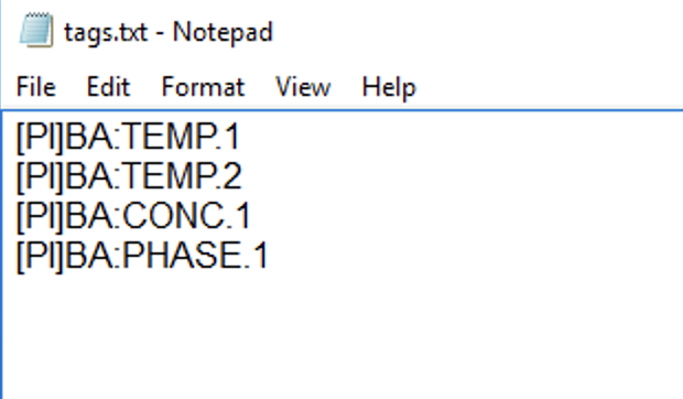

Prepare a tags.txt file containing all tags which need to be benchmarked.
File format requirements:
No header
One tag name per line
Tag prefix needs to be added!
Example of content of tags.txt:
