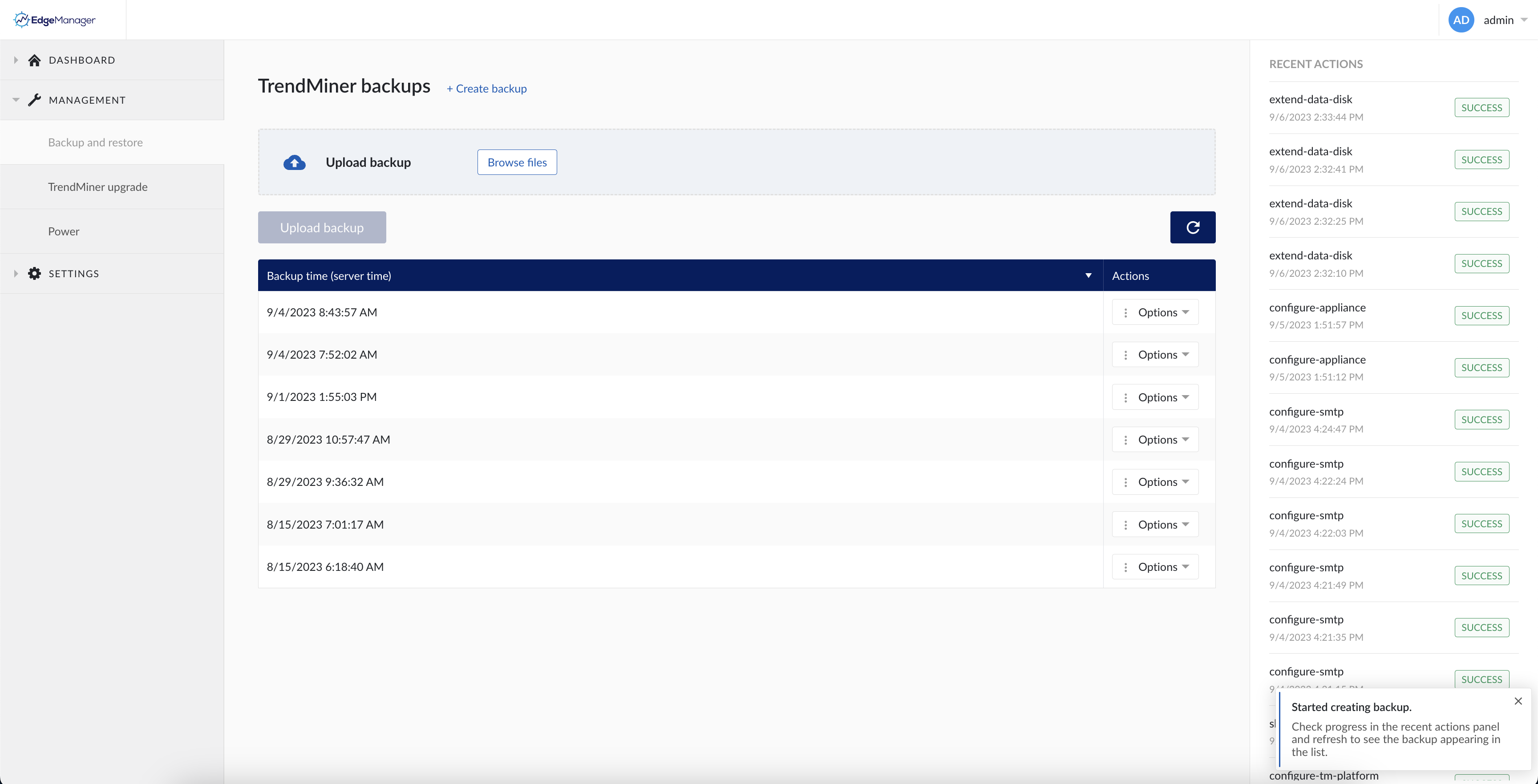

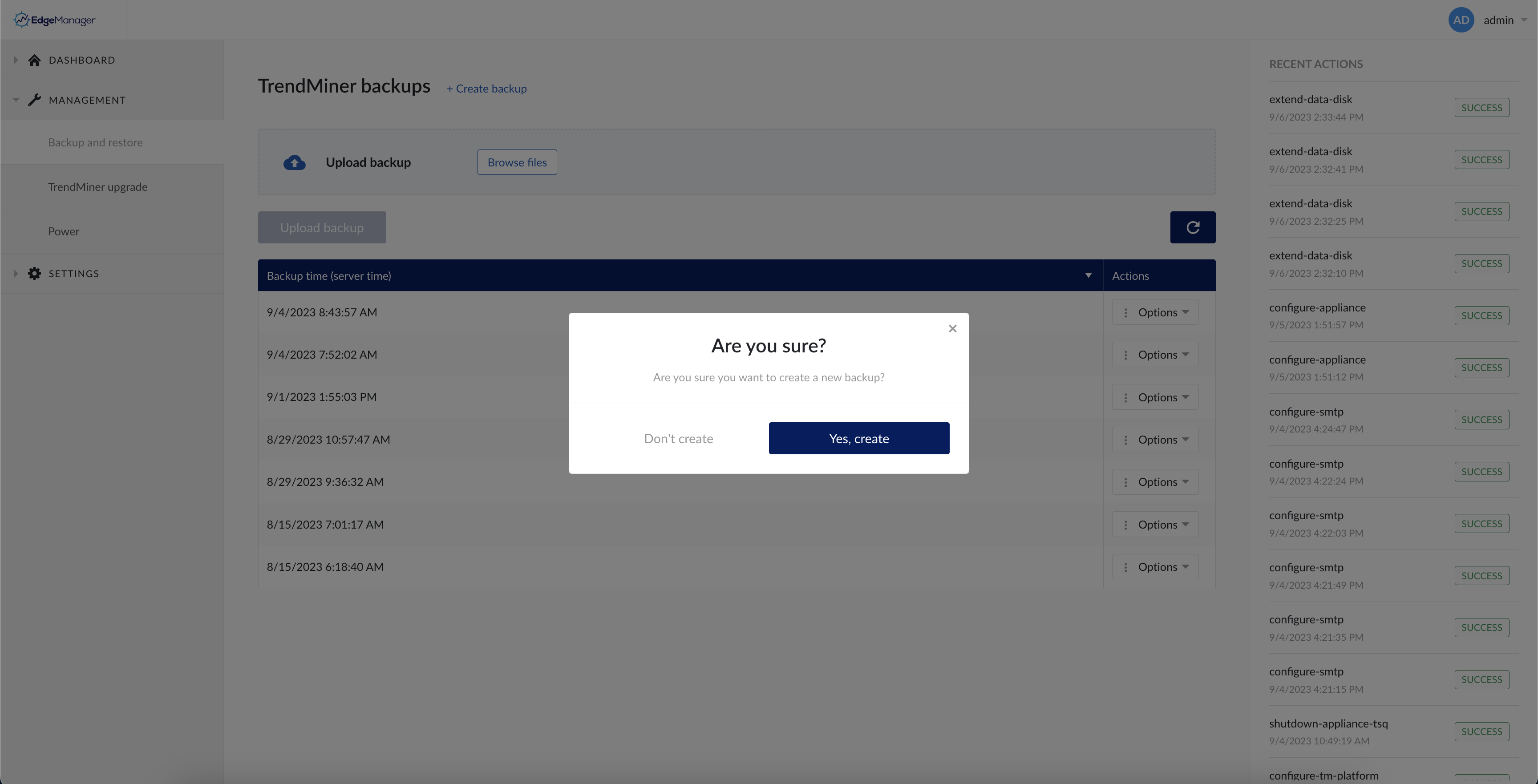

  5. Confirm the backup creation. A notification is shown on the bottom right to confirm that backup creation has started.
    create-backup-confirm-dialog
    edge_manager_create_backup_notification

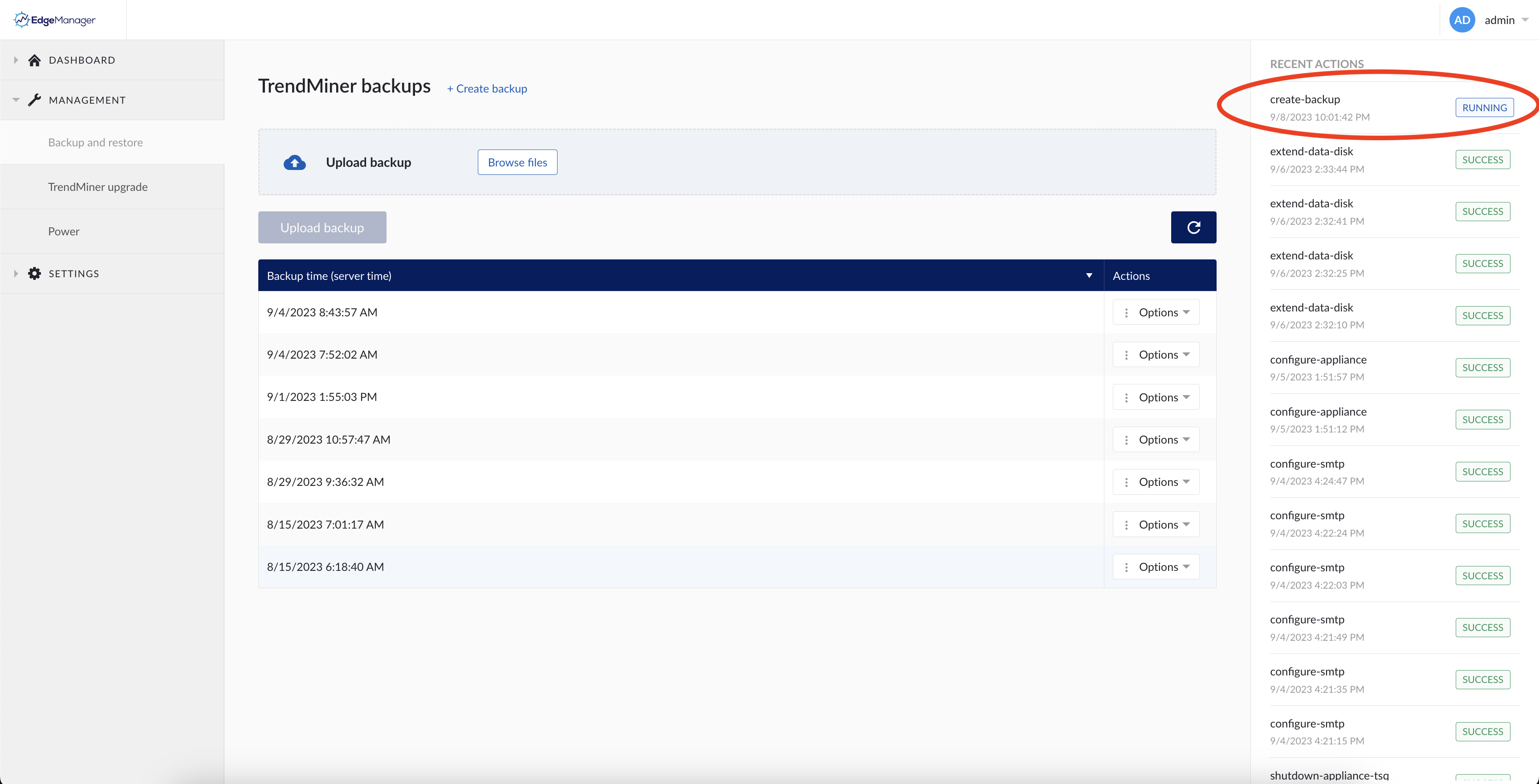

  6. Wait until the backup creation is finished. This can take from a few minutes to an hour or more, depending on the speed of the disk and the amount of data which needs to be backed up.
    create-backup-task-running
  7. When the backup creation is finished and the task is on 'success' refresh the page to show the newly created backup in the list of backups.

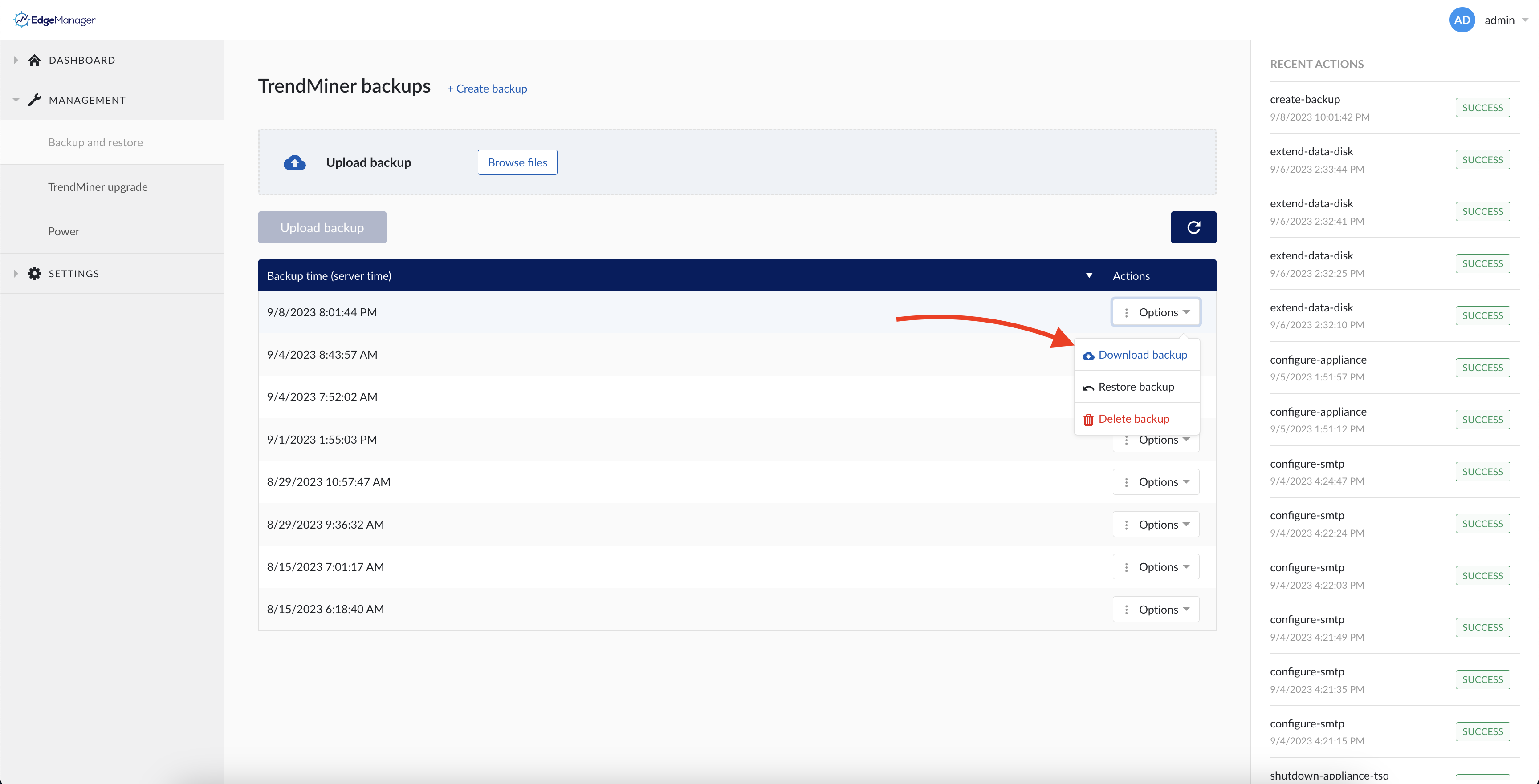

  8. To download the backup to your computer, click the options button of the created backup and select 'Download backup'.
    download-backup
