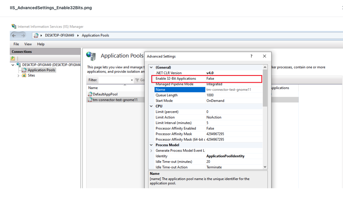

This is important since connectivity will only work when the target data source and the driver used to connect match each other. TrendMiner's plant integrations will by default run 64-bit. If your connectivity depends on a 32-bit driver, the application pool setting needs to be changed.
Figure 2.  Enable 32-Bit Applications attribute
[en] Enable 32-Bit Applications attribute
Change the property for "Enable 32-Bit Applications" to True and restart the application pool. The Plant Integrations will now run in 32-bit.
