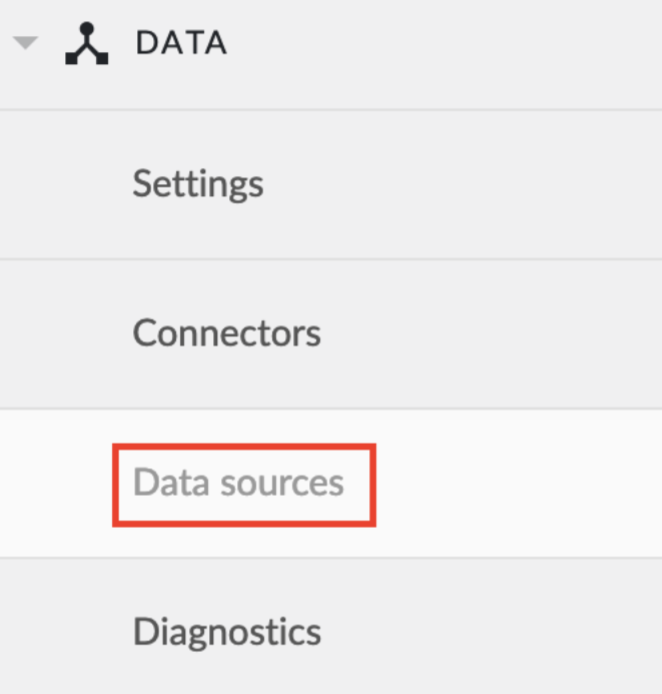

In ConfigHub select the tab "Data sources"

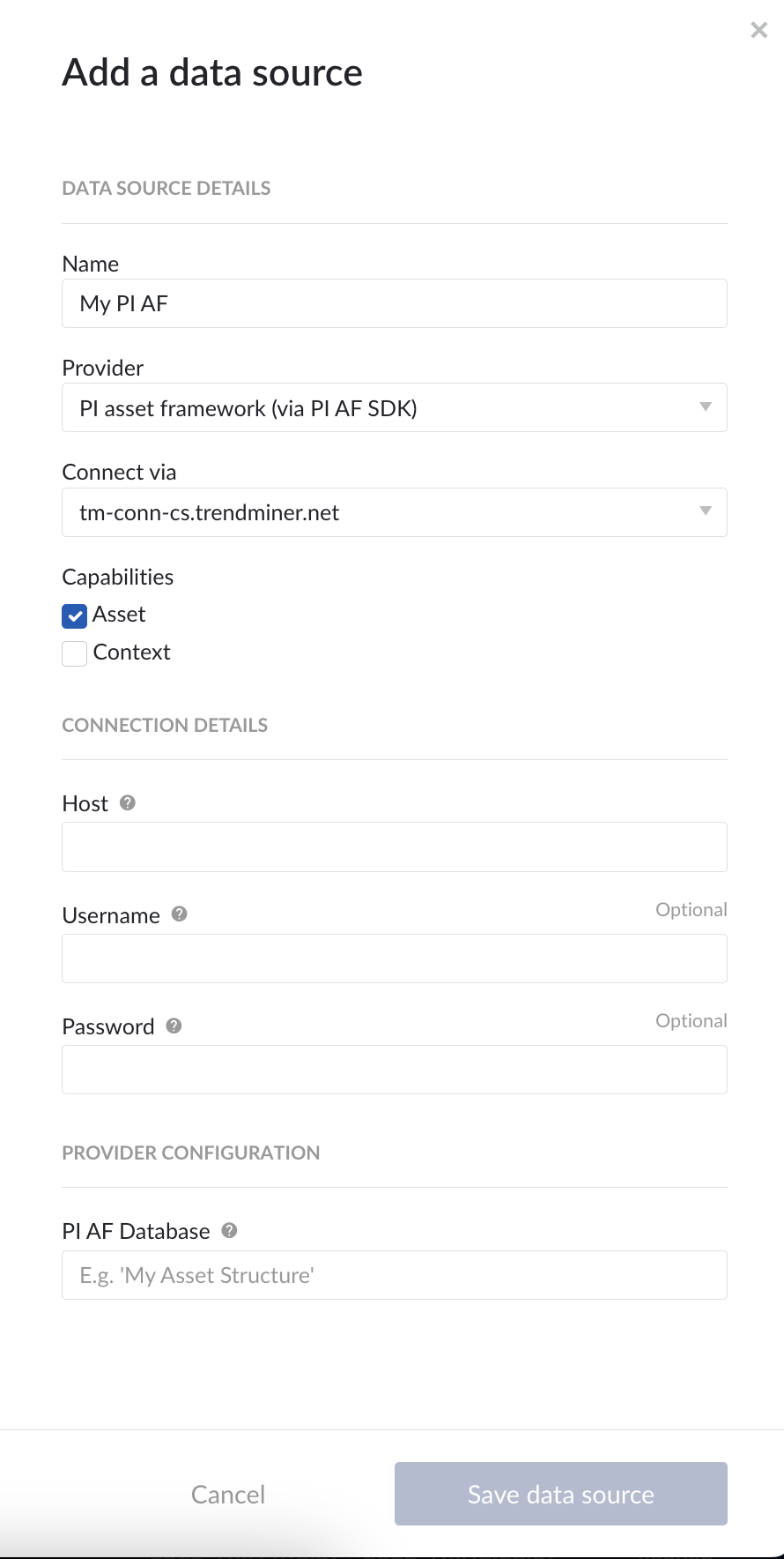

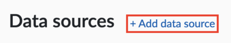

Click the "Add data source".
Name the data source.
Select the provider 'PI asset framework (via PI AF SDK)'.
Select the connector you want to use for connecting this data source via the 'Connect via' dropdown.
Make sure to select the "Asset" capabilities checkbox.
Fill out the Connection Details and Provider Configuration.
