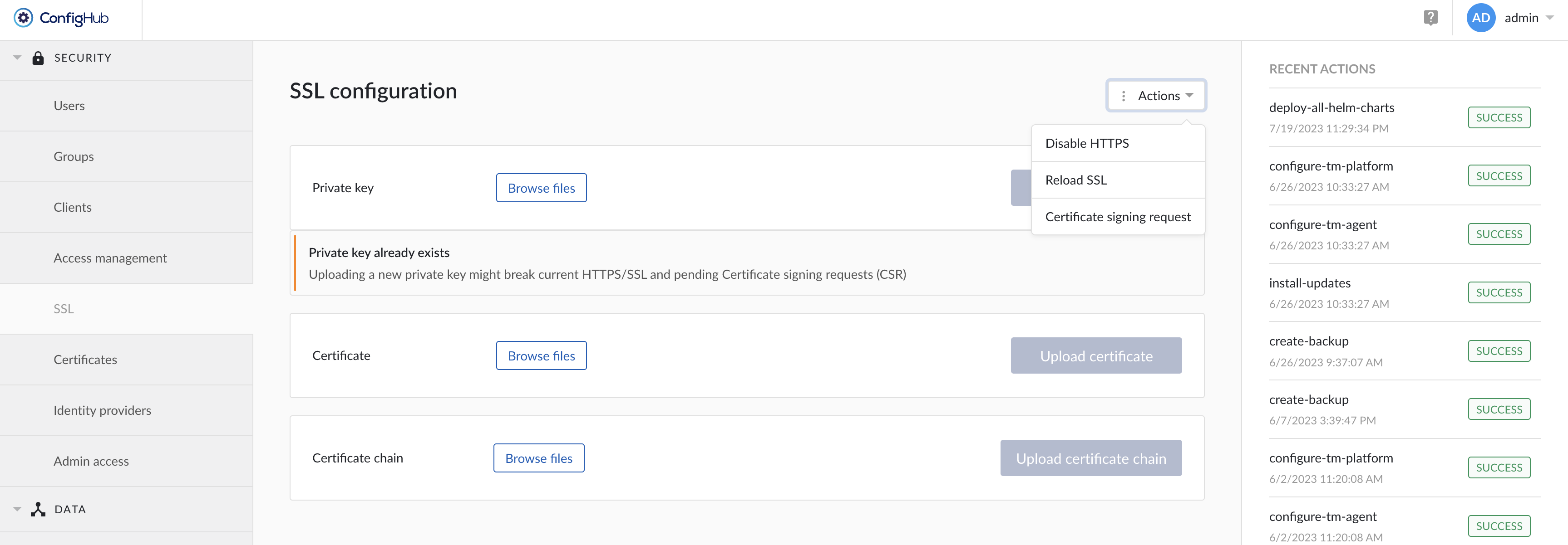

SSL can be configured in the 'SECURITY' section of ConfigHub. Via the 'SSL' menu a private key, a certificate and a certificate chain must be uploaded which will show up in the 'Certificates' menu under 'Trusted Certificates'.
Your company should have its own procedure for enabling SSL for their web applications. As part of this procedure, you might need to generate a Certificate Signing Request (CSR) which is explained here: How to get a CSR?. With this CSR your IT department will generate the key and certificates which you can use to enable SSL in TrendMiner.
Upload all three files (Private key, Certificate and Certificate chain)
It is important that 3 separate files are uploaded and that these files are in the correct format. More information on how to get these files can be found here:
Enable HTTPS from the 'Actions' dropdown button.
This action will trigger several tasks on the right side of the screen. Wait a few minutes until all the tasks change to the ‘SUCCESS’ status.
