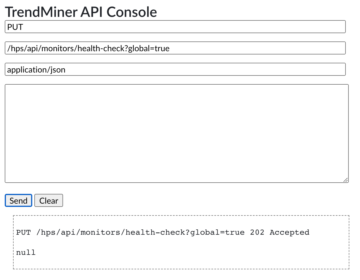

The monitor health check as provided in the UI can be triggered by individual users and also runs a health check on the monitors of an individual user only. If tag accessibility issues caused monitors of multiple users to go to system-disabled admins can trigger a global monitor health check via the TrendMiner API:
- Browse to the TrendMiner API Console
- Execute the following API call: - PUT /hps/api/monitors/health-check?global=true - After clicking "Send" the response shows a "202 Accepted".
- The global monitor health check is triggered. It can take a few minutes to complete. Once completed all admin users will receive a notification.
