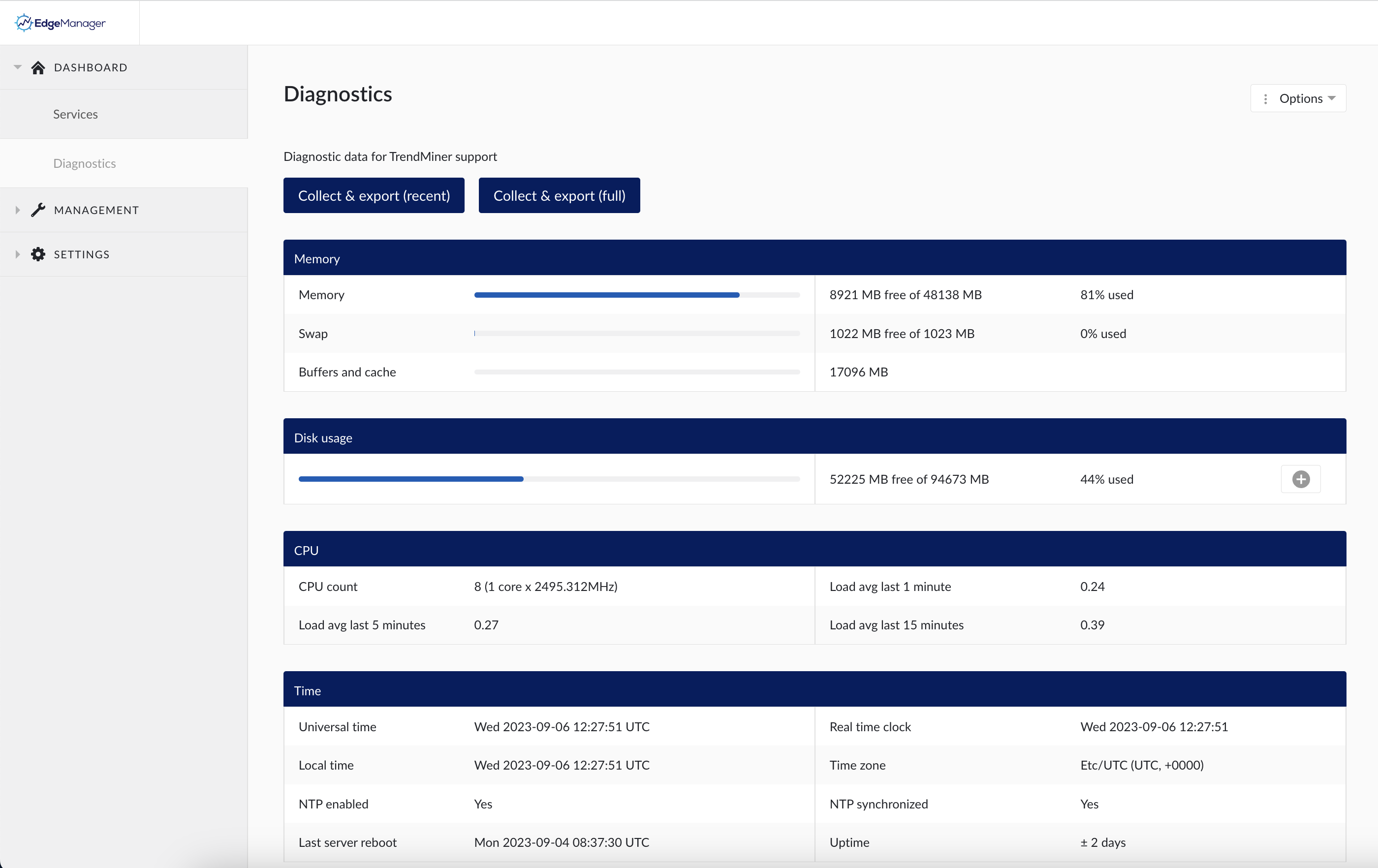

  3. Navigate to 'DASHBOARD' -> 'Diagnostics' and click on:
    1. 'Collect & export (recent)' for log files from an issue which just occurred (last hours).
    2. 'Collect & export (full)' for log files from the last 10 days for more elaborate investigation.
    edge_manager_diagnostics_2023.R3.0
