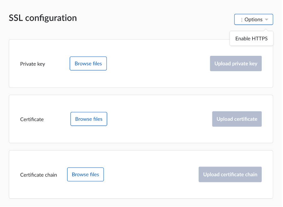

How to enable SSL in TrendMiner?
  • Private key
  • Certificate
  • Certificate chain
Typically, your IT department will be able to provide these. A (temporary) solution to create a certificate is offered in the next section, but make sure to align with your IT department first.

Once these prerequisites are fulfilled, browse to the ConfigHub > Security > SSL menu to upload them. After uploading, HTTPS can be enabled via the "Options" menu on the top right.
Enabling HTTPS will temporarily render ConfigHub unusable until the service restart has completed. A manual refresh of ConfigHub is necessary. Press F5 to try to load the interface again. Retry until this succeeds.
