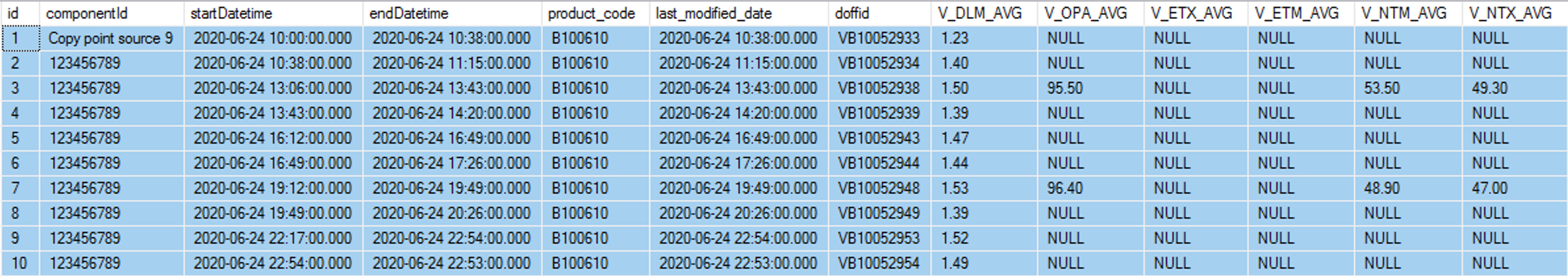

In the examples bellow, we will use the following tm_contextitems table as context items data source:
