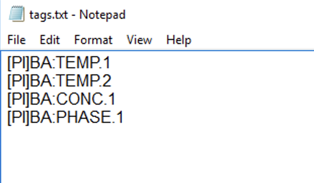

  3. Prepare a tags.txt file containing all tags which need to be benchmarked.
    File format requirements:
    • No header
    • One tag name per line
    • Tag prefix needs to be added!
    Example of content of tags.txt:
    batch indexing tags.txt 2023.R3.0
