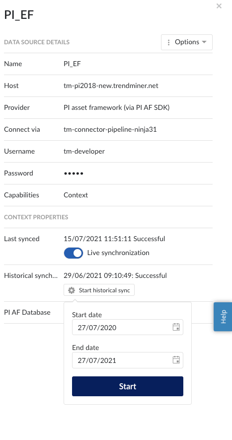

TrendMiner offers live synchronisation (with a 2 minute interval) of ALL event frames that are modified or created. If a lot of items are edited at the same time (e.g. a bulk action in PI EF), this interval is synced in a separate thread (excessive interval thread) to avoid a delay on the live sync. The live sync can be enabled in the context properties section of the data source.
Historical synchronisation
TrendMiner offers a historical synchronisation of ALL event frames that are edited or creating within a predefined timeframe. The start and end date can be selected in the data source detail panel.
