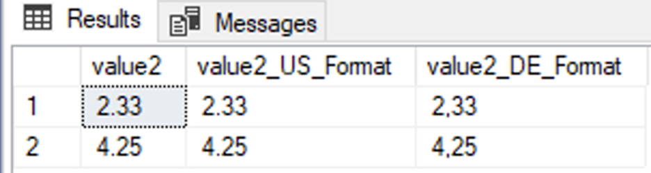

WHERE tagname = ? AND timestamp IS BETWEEN ? AND ? ORDER BY timestamp ASCIn this case, assuming the values and timestamps originate from the same table, the values.sql query might look as follows
SELECT
    value2,
    FORMAT(value2, 'N', 'en-us') as value2_US_Format,
    FORMAT(value2, 'N', 'de-de') as value2_DE_Format
FROM Table_1The output will look as follows:
