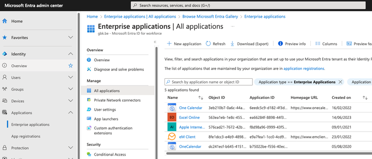

Browse to https://entra.microsoft.com and login with a administrator account that is having access to create new Enterprise applications and SAML configuration
Go to Applications→Enterprise applications

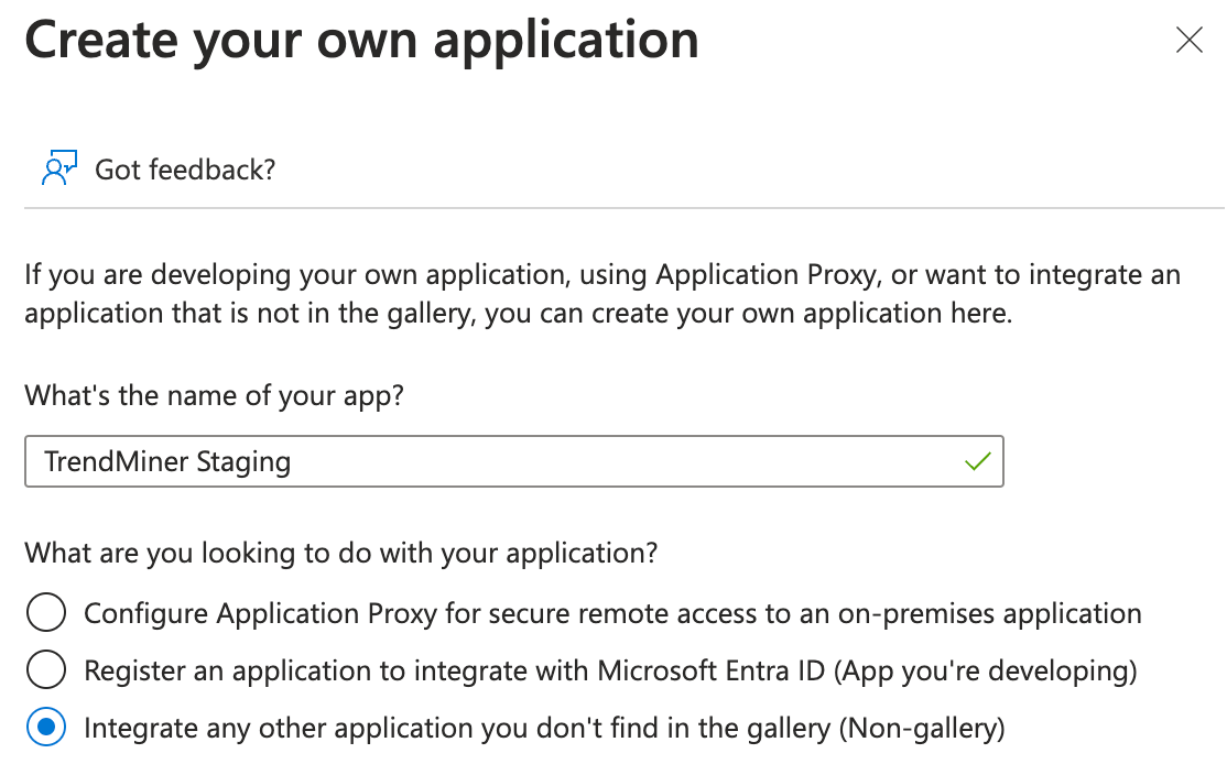

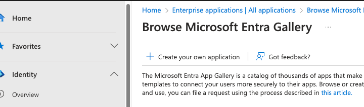

Click ‘New Application’ and then click on ‘Create your own Application’
Fill in the name of the application and select ‘Integrate any other application you don’t find in the gallery'
Click on Create

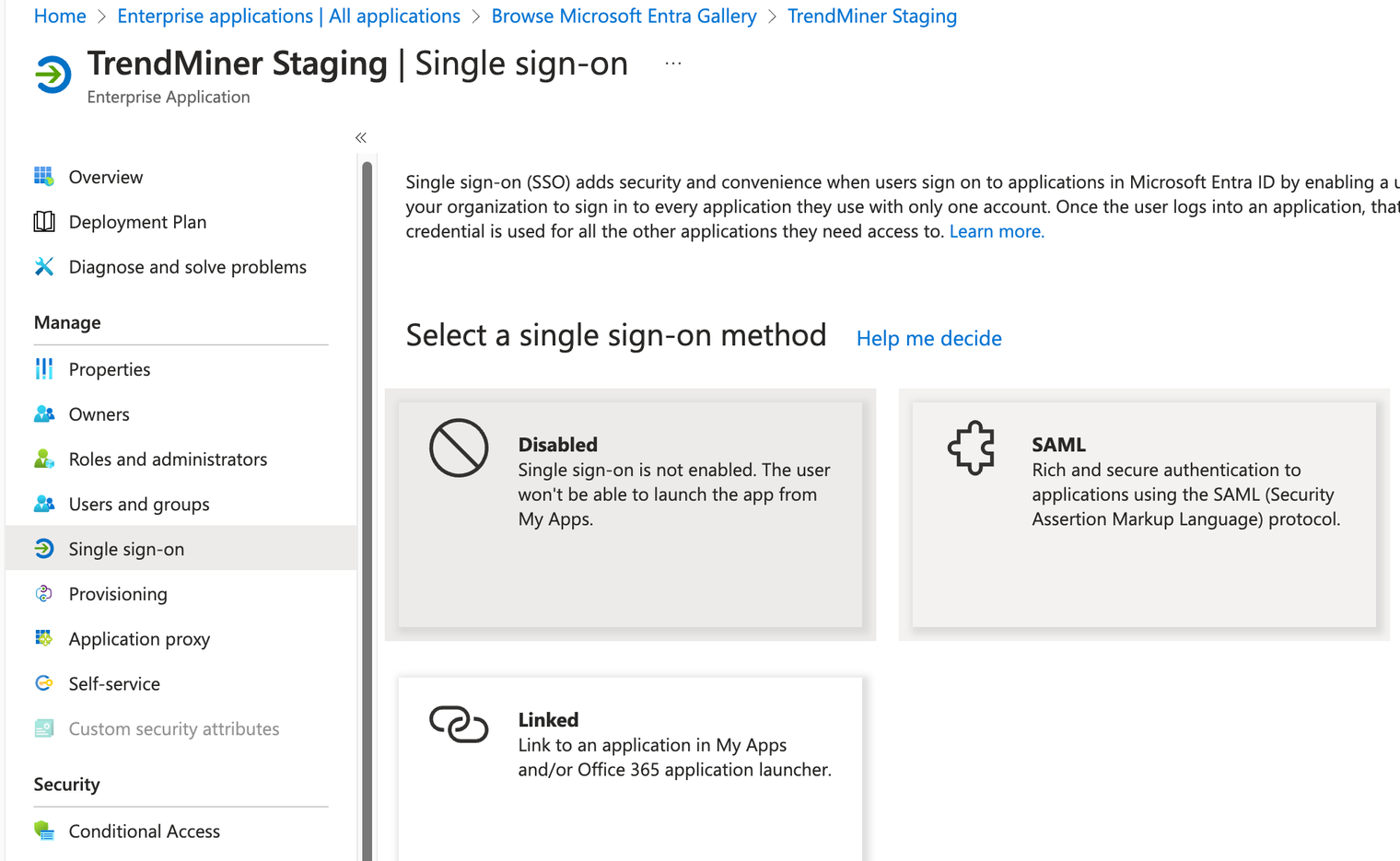

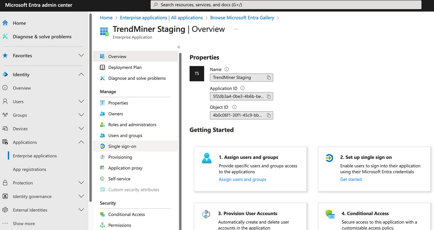

2. Setup SSO
Click on “Single sign-on”
Then Click on SAML

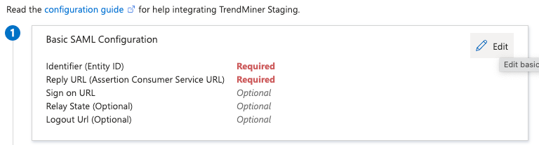

3. Configure placeholders for security claims

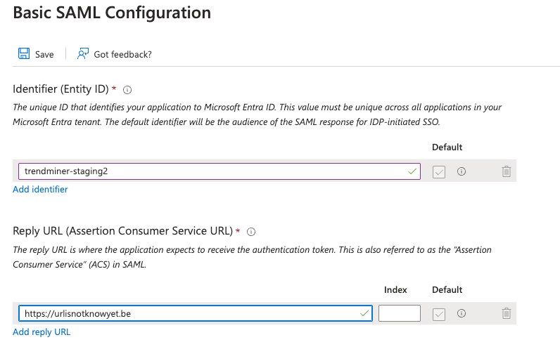

Identifier (Entity ID) and Reply URL
This step is required to be able to download “Federation Metadata XML” needed to setup TrendMiner
Click on edit
Fill in the parameters as below.
Identifier (Entity ID): Fill in some name, this is only used temporary and will be replaced.
Reply URL: currently not yet known, will be automatically fixed in the further steps.

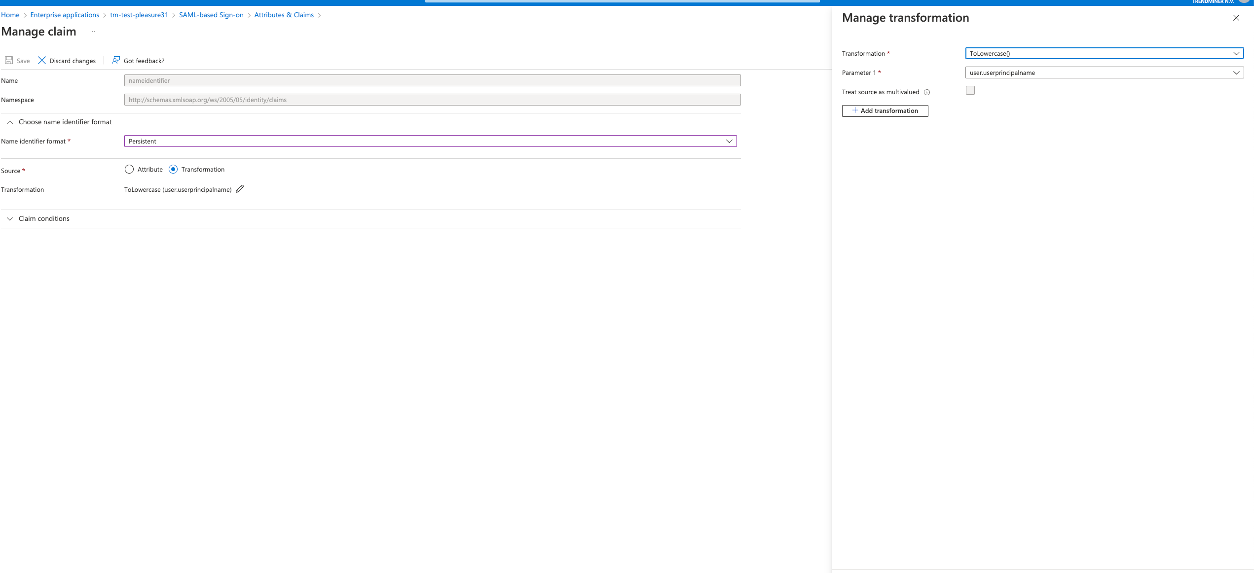

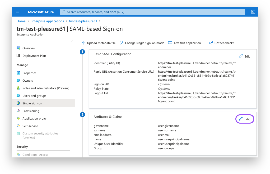

  1. Click the "Edit"-button under "User Attributes & Claims"

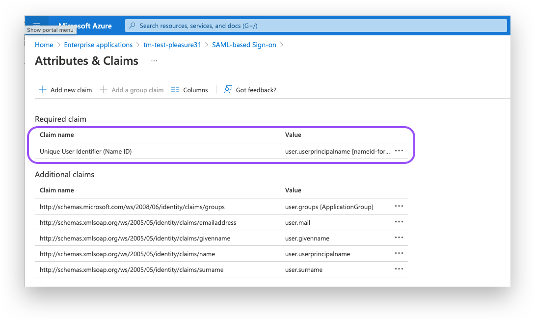

  2. Click on the "Unique User Identifier (Name ID)" option.
  3. Ensure the “Name identifier format” is set to a format of your choice. Note that the source attribute "user.userprincipalname" refers to the email in Azure. Under "Source" select ''Transformation" and add the "ToLowercase()" transformation for the "user.userprincipalname" as shown in the screenshot below.
    Azure AD - Name Identifier Format

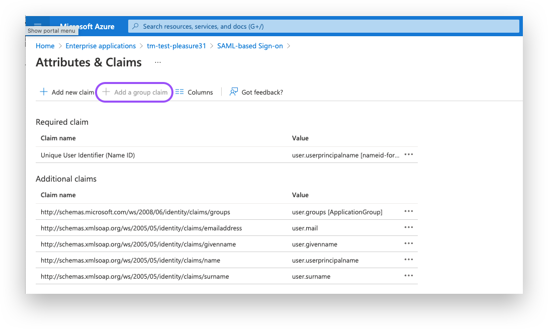

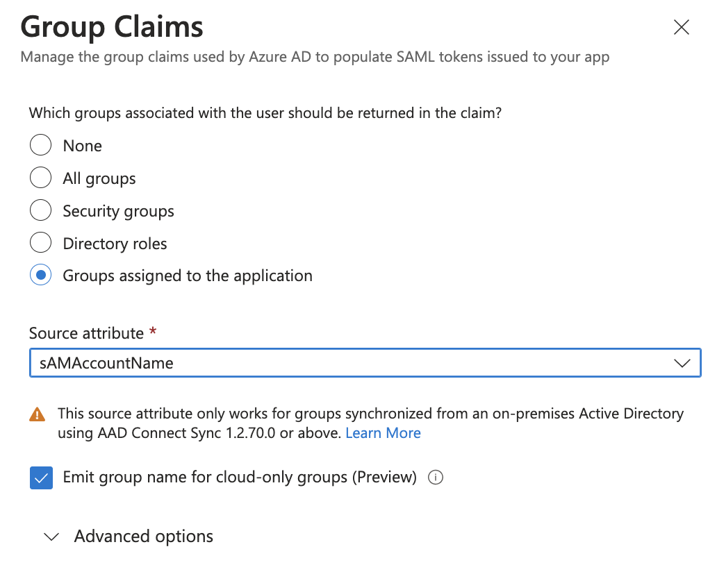

  4. Configure groups. This helps you leverage existing group memberships to set access rights to data sources automatically.
    2. Click the "Add a group claim"-option.
    3. Set the Group Claims as desired. An example is shown in the screenshot below; this needs to be adjusted to fit your preferences:
      • Associated groups to be returned in the claim: to avoid clutter, the recommendation is to select "Groups assigned to the application".
      • Source attribute: Select your preference according to the Azure AD documentation. In most cases, either sAMAccountName (for groups that are synchronized from an on-premise Active Directory setup into Azure AD) or Group names for cloud-only groups (for groups that were created directly in Azure AD) will be desired, as these return human-readable names that can be used in TrendMiner's ConfigHub.
      • Achtung
        By default, the Group ID will be selected as Source Attribute. This corresponds to the Object ID of the Azure AD group, typically a 37-character string in the format xxxxxxxx-xxxx-xxxx-xxxx-xxxxxxxxxxxx. The group will be identified in Confighub as this long identifier as well, so for human readability and admin usability, it is recommended to change the Source attribute.

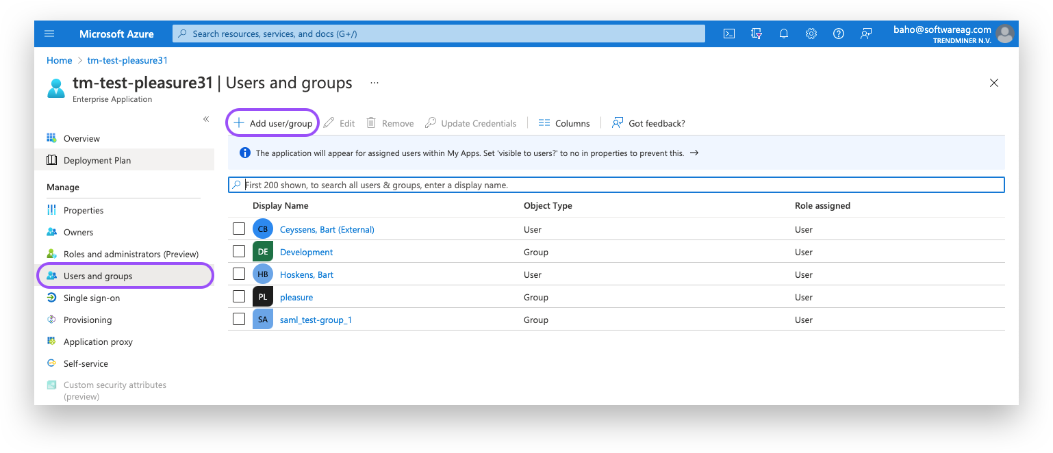

    5. Add users and groups to your application
    Add users/groups to the application. This enables the admin to provide explicit access only to those users and groups that should be able to use TrendMiner, according to the provisioned license capacity for named users.
    1. Navigate to "the Users and Groups" tab.
    2. Click the Add "user/group" button and add users/groups.

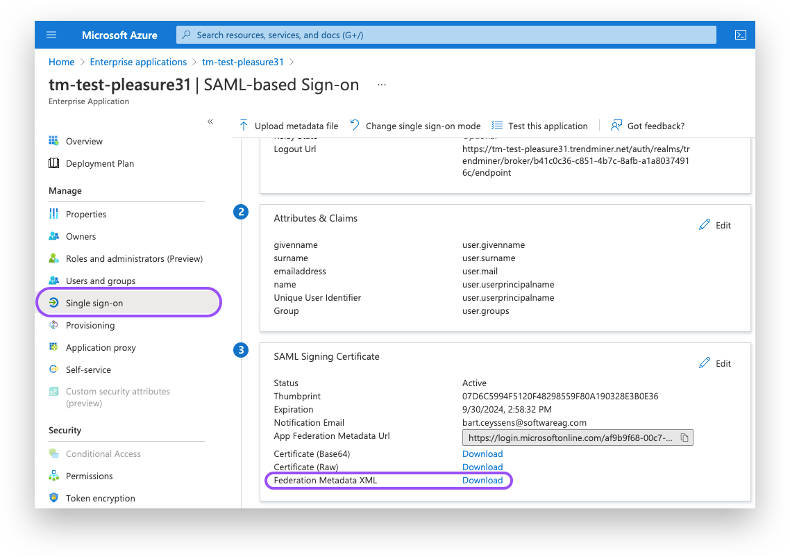

    6. Download the Federations metadata XML from Entra
    Navigate in Entra ID to your SAML application, and open the Single Sign-on section.
    1. In the upper section, "Basic SAML Configuration", leave placeholders for the required fields like Entity ID. These values will be overwritten in later steps when the metadata file from TrendMiner is imported back into Azure AD.
    2. Download the Federation Metadata XML. This file will be used to upload in TrendMiner ConfigHub in later steps.

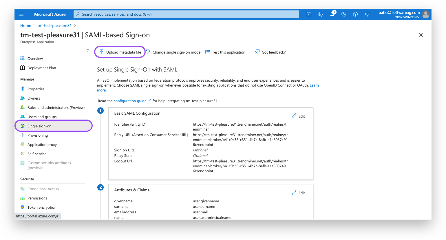

SAML - Configure Azure AD - Part 2
Now that we have the metadata file from TrendMiner (as generated in the previous step), we can proceed with finalizing the configuration on the IdP side.

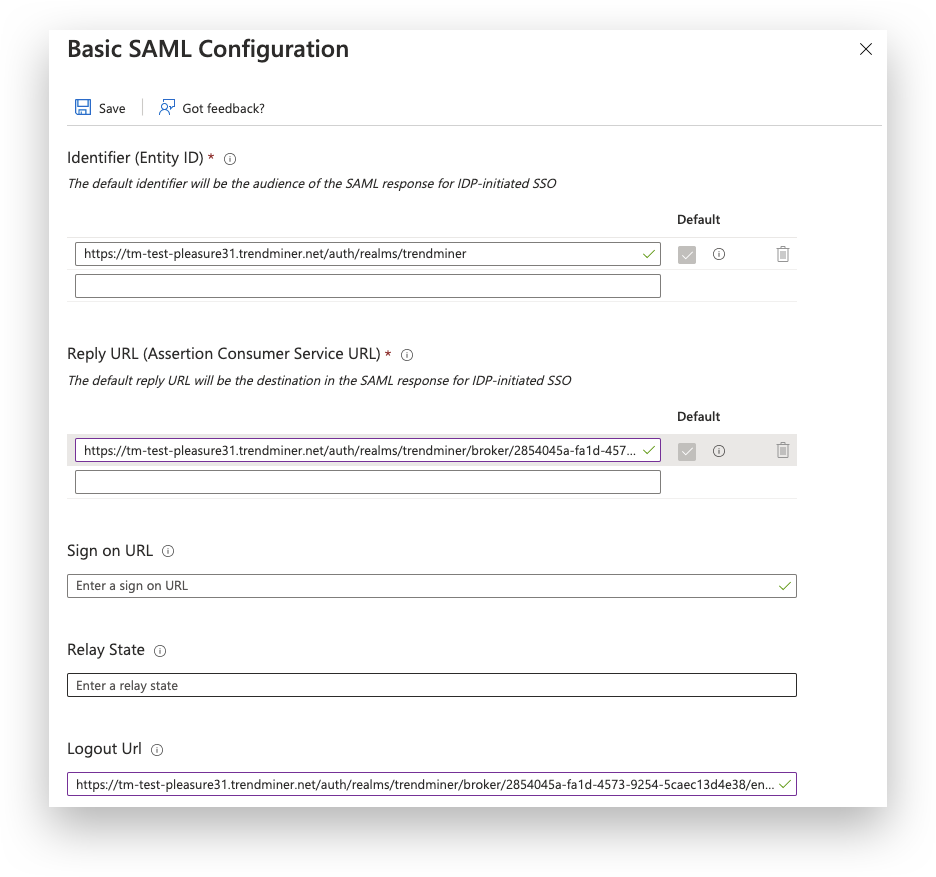

  1. Navigate in Azure AD to your SAML application and open the "Single sign-on"-tab.
  2. Click the "Upload metadata file" and upload the TrendMiner metadata file. This will fill out the required information where we placed placeholders in the first step.
  3. Check the entries - It might be necessary to fill in the Reply URL yourself. This is the same value as Logout URL.
  4. The SAML setup is complete and you should be able to login in TrendMiner. After logging in with a SAML user in TrendMiner the assigned groups should be synced and ACLs can be configured.
