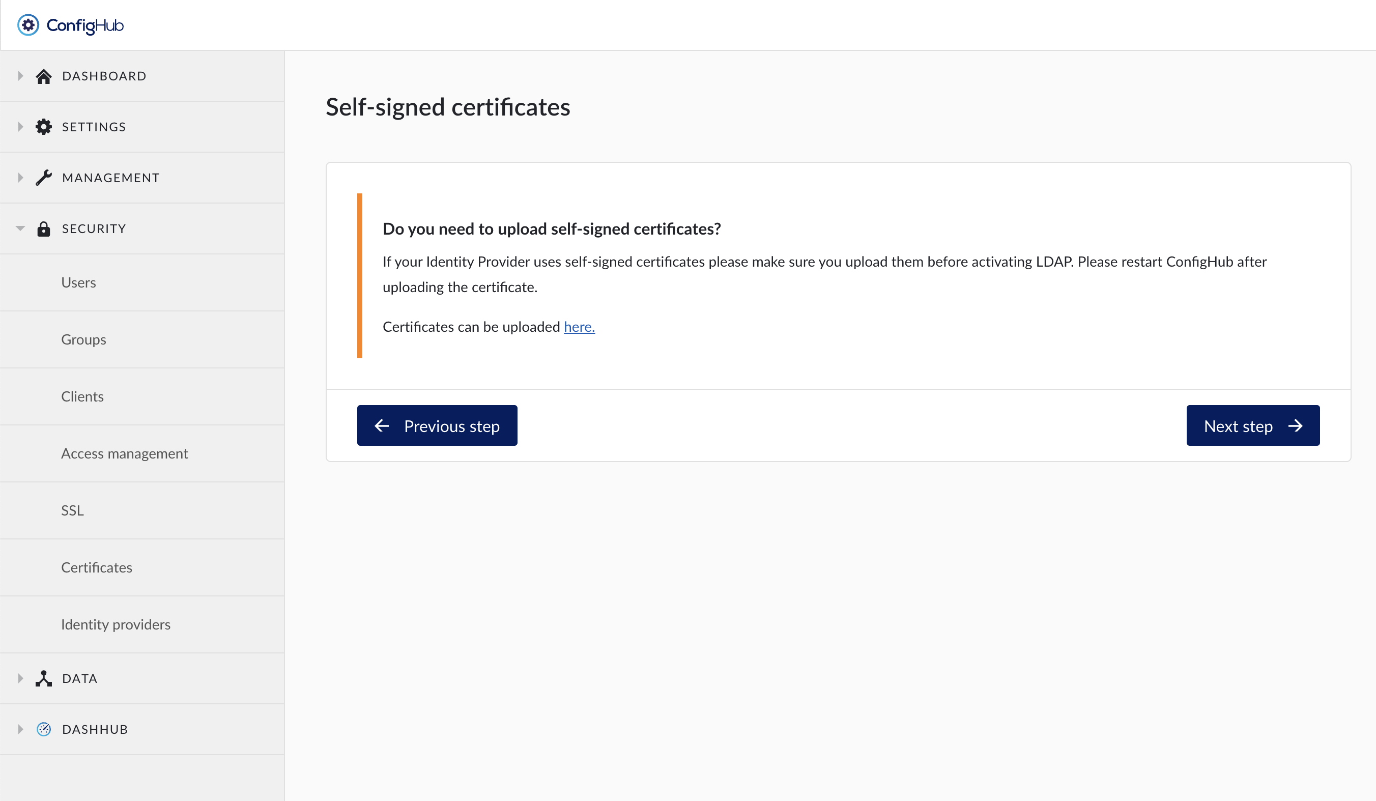

Import the right certificates (AD Root CA) into ConfigHub (certifications section)
Restart tm-keycloak

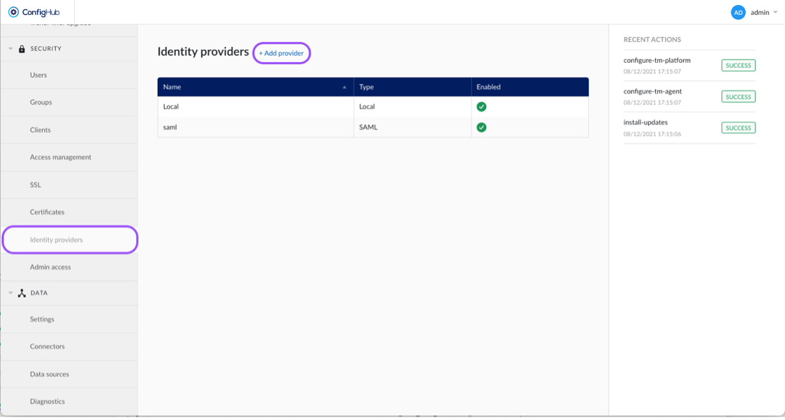

Change the URL in the Identity Providers session from ldap:// to ldaps://
ldaps goes by default through port 636 (ldap goes through 389), so this one will need to be open.
Select the "Active Directory / LDAP" option.

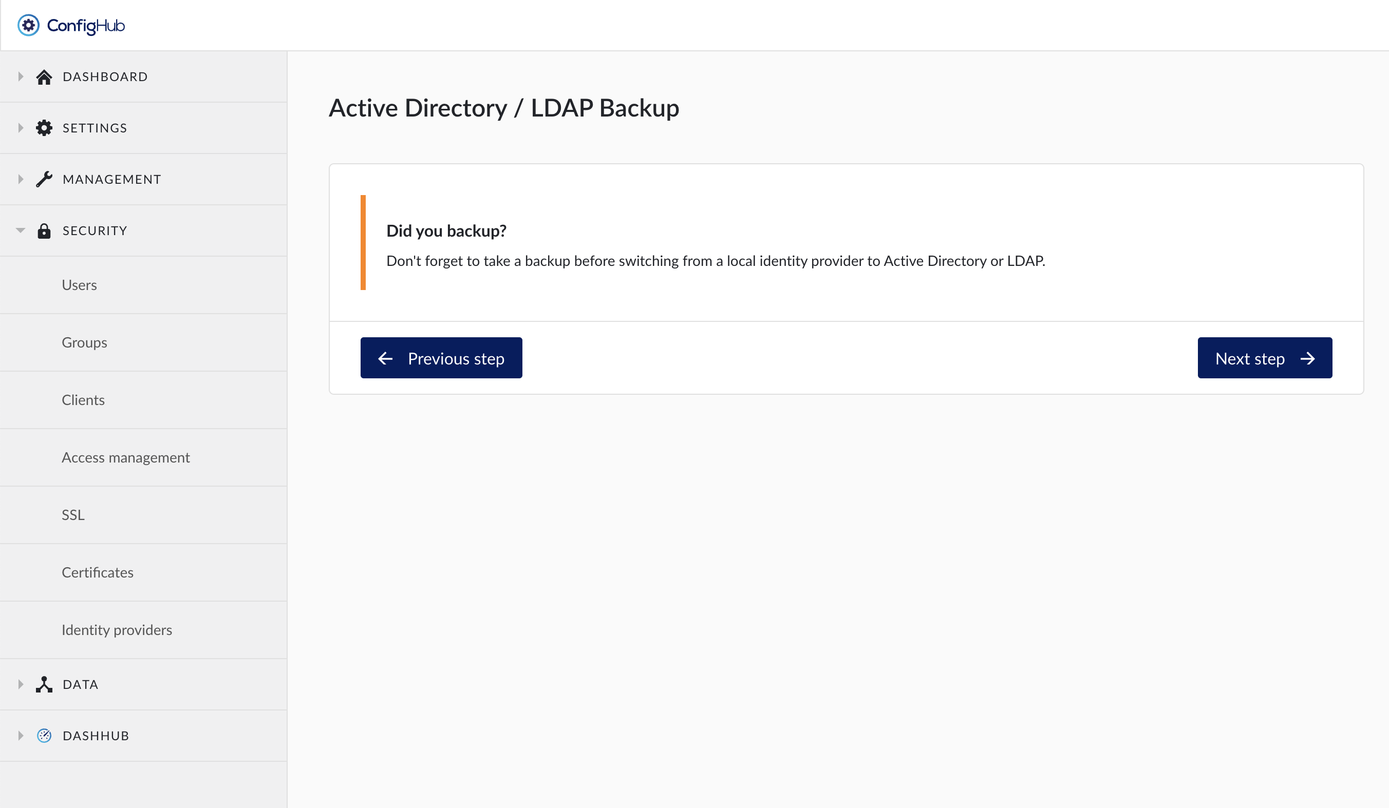

Create a TrendMiner backup. A backup allows you to rollback to the final non-AD/LDAP state.

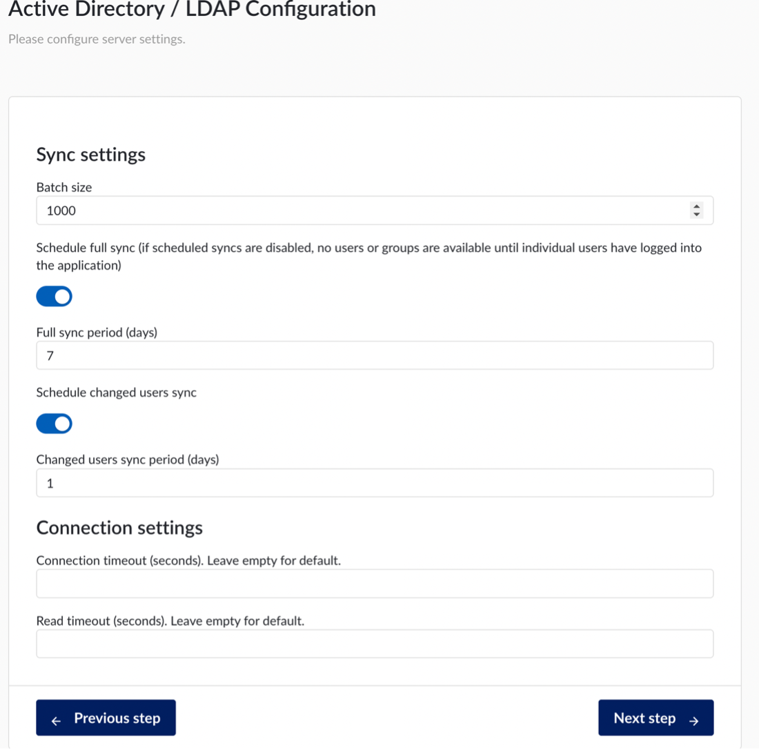

Configure the server settings:
Sync settings:
Batch size: Count of LDAP users to be imported from LDAP to TrendMiner within a single transaction.
Schedule full sync: Enable a full synchronization of LDAP users to TrendMiner. If scheduled syncs are disabled, no users or groups are available until individual users have logged into the application.
Full sync period (days): Period of full synchronization of LDAP users in days.
Schedule changed users sync: Enable synchronization of new or changed LDAP users to TrendMiner.
Changed users sync period (days): Period of synchronization of changed or newly created LDAP users in days.
A manual sync can be performed by the TrendMiner admin after the configuration is complete. After completion, the manual sync can be found in the LDAP details panel under "Options" -> "sync provider"
Connection settings:
Connection timeout: LDAP connection timeout in seconds. If empty (default) the connection does not timeout on TrendMiner side.
Read timeout: LDAP read timeout in seconds. If empty (default) the read request does not timeout on TrendMiner side.

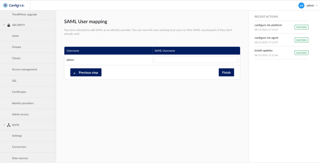

The next screen allows to map existing (local) TrendMiner users to the users of the LDAP provider.
The LDAP setup is complete and you should be able to login in TrendMiner.

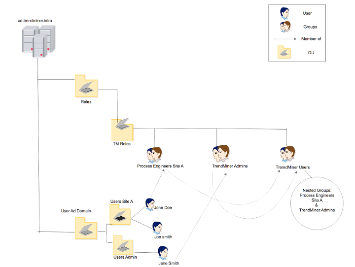

Two example configurations are described here. A first case describes a simple configuration where users of one group receive access. A second case describes a more advanced configuration where users of multiple groups receive access.Consider the following LDAP tree structure:
(objectClass=person)
The full filter becomes:
