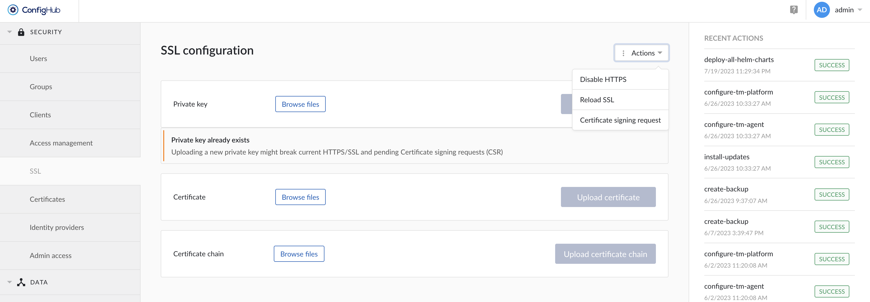

SSL can be configured in the 'SECURITY' section of ConfigHub. Via the 'SSL' menu a private key, a certificate and a certificate chain must be uploaded which will show up in the 'Certificates' menu under 'Trusted Certificates'.

Upload all three files (Private key, Certificate and Certificate chain)
It is important that 3 separate files are uploaded and that these files are in the correct format. More information on how to get these files can be found here:
Enable HTTPS from the 'Actions' dropdown button.
This action will trigger several tasks on the right side of the screen. Wait a few minutes until all the tasks change to the ‘SUCCESS’ status.
