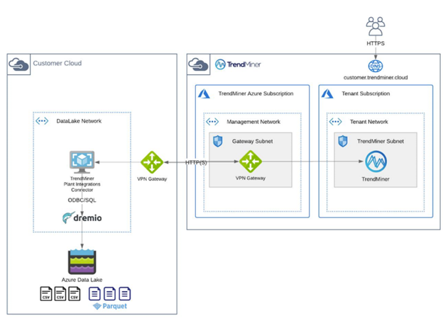

In this scenario, a secure connection needs to be established between the TrendMiner SaaS platform hosted in the cloud and data source(s), also hosted in the cloud. In most cases, this will be a data lake such as the Azure Data Lake. This is managed by setting up a secure VPN tunnel between the two locations.
Architecture schema
Example reference architecture for TrendMiner SaaS with a cloud data source (Azure Data Lake in this example)
The analytics platform is deployed in a dedicated customer tenant in the cloud. This instance is managed and operated by TrendMiner.
On the customer side, the data lake is hosted in the cloud as well. Data is available through a query layer. For Azure, this could be for example an Azure data lake with a Dremio lake house, or Azure Data Explorer offering the Kusto Query Language (KQL).
The need for the Plant Integrations module depends on the cloud data source. Many have a direct connection available that can be configured. For others, custom connections can be created. In this case, the Plant Integrations module needs to be installed on a Windows Server.
A secure connection needs to be created between the TrendMiner cloud tenant and the customer's cloud environment. For example, through an Azure Virtual Network Peering.

Datasource connection
The connection between the cloud data source and TrendMiner is usually done through a query layer. In general, this layer provides JDBC/ODBC connectivity and the ability to run queries (e.g. SQL or KQL) against the data source.
For the direct connections supported by TrendMiner (e.g. Azure Data Explorer through Kusto), the connectivity can be configured directly in TrendMiner, without the need for any additional modules.
For generic or custom connections, the installation of the Plant Integrations module is required. This module exposes access to read data over a REST-based API (HTTP or HTTPS). TrendMiner only accesses this connector, not the data source directly.

VPN connection
In order to set up a secure connection between Customer Cloud and TrendMiner Azure environment different options can be considered:
  • Azure virtual network peering
  • Azure private link
  • VPN with NAT
TrendMiner will work closely with Customer’s IT department on setting up this connection.
