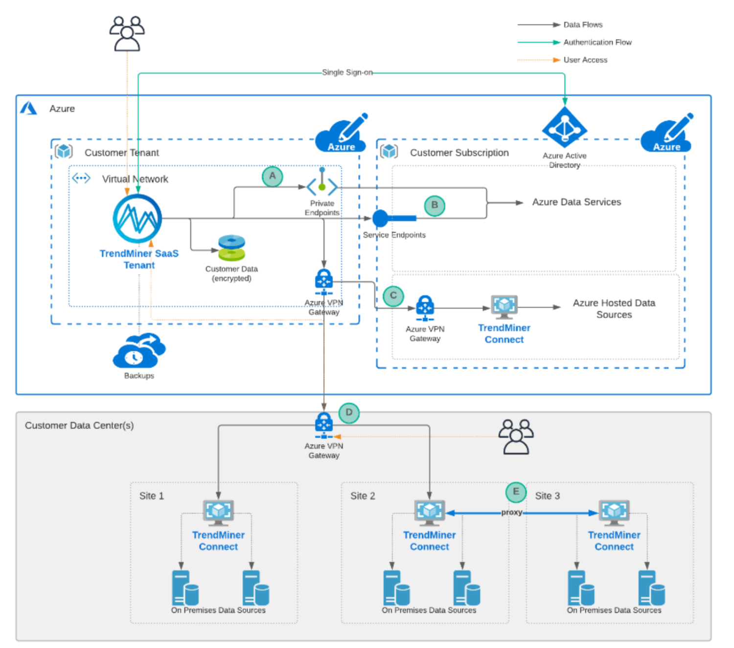

In this more complex scenario, a secure connection needs to be established between the TrendMiner SaaS platform hosted in the cloud and data sources, hosted both on-premise and in the cloud.
In most cases, the on-premise systems will be historians while the on-cloud data source will be a data lake such as the Azure Data Lake.
This is managed by setting up a secure VPN tunnel between the TrendMiner SaaS and the data source locations.
Architecture schema
Reference architecture for TrendMiner SaaS with hybrid data source integration
