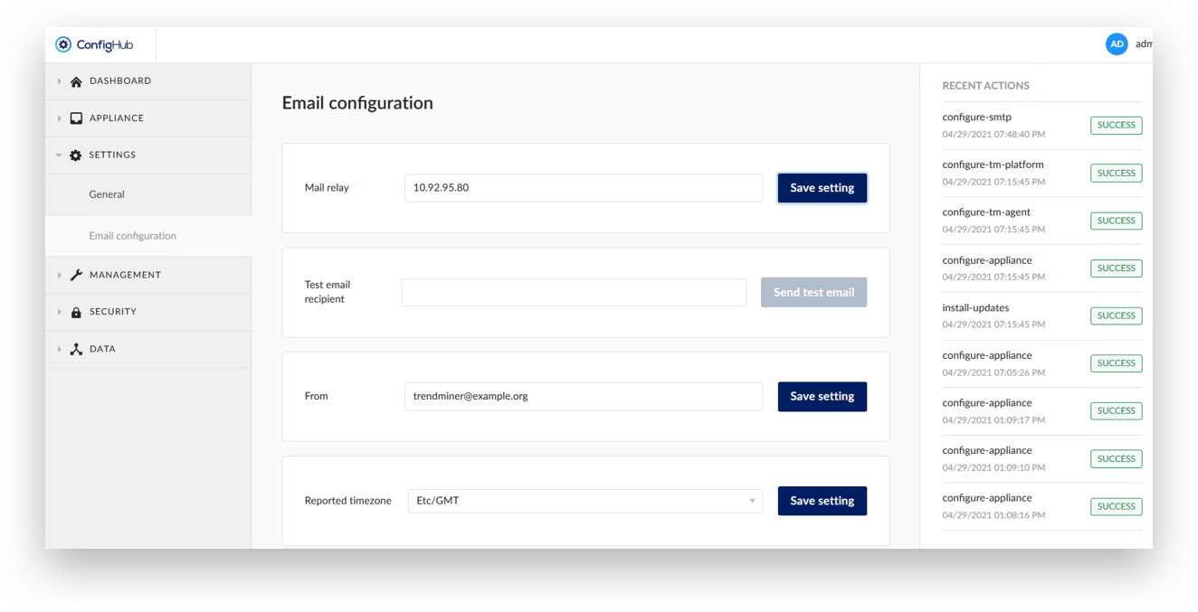

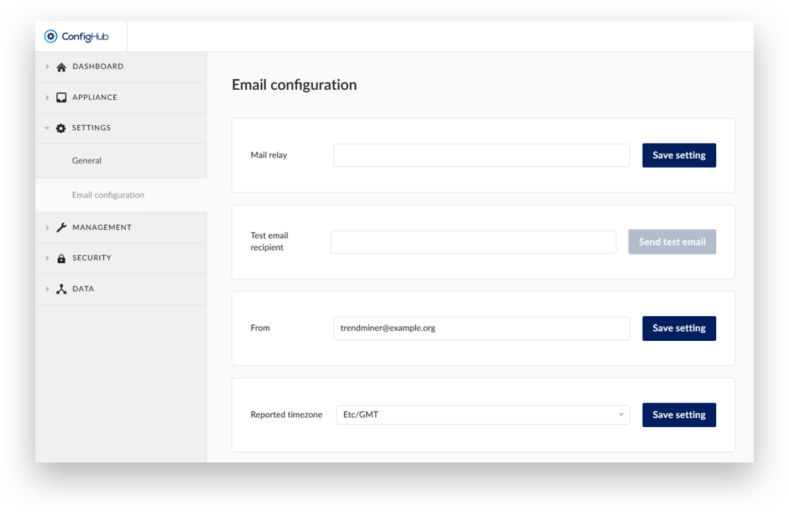

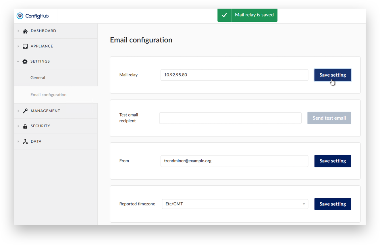

  1. Provide the mail relay server’s IP address and click ‘Save setting’. A green message at the top will say ‘Mail relay is saved’.
  2. This will trigger the ‘configure-smtp’ task under ‘Recent Actions’. Wait until the ‘configure-smtp’ task changes to the ‘SUCCESS’ status.

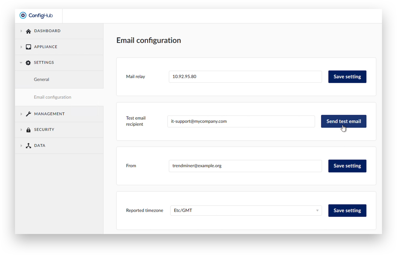

  3. To verify the email configuration, provide a valid email address in the ‘Test email recipient’ textbox and click 'Send test email'. A test email should be received at the given address.
