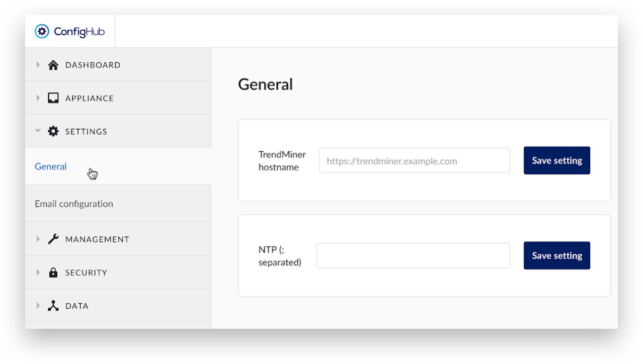

  1. Expand the ‘SETTINGS’ menu and click ‘General’ to configure the NTP server.

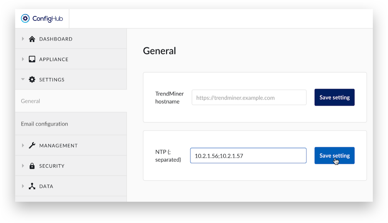

  2. Multiple NTP servers can be configured by separating them with a semicolon. Once done, click  ‘Save setting’.

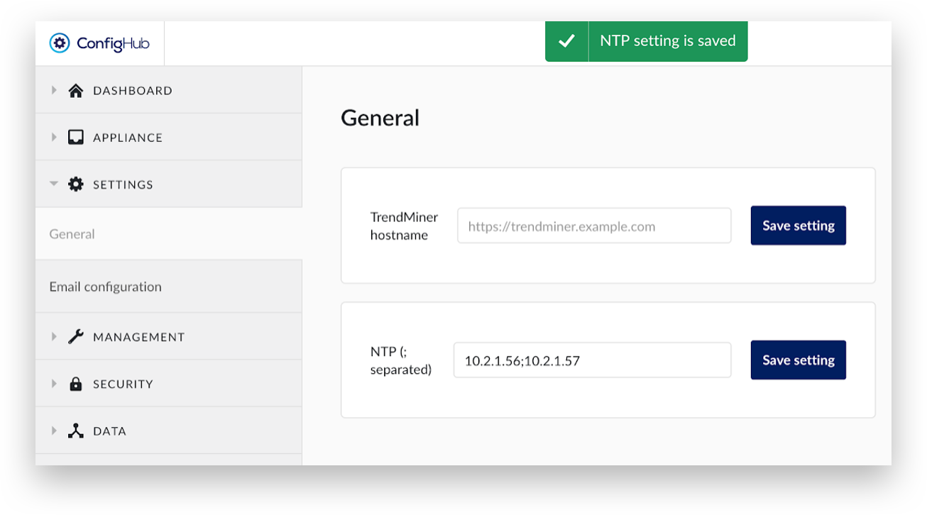

  3. A green message at the top will say ‘NTP setting is saved’.

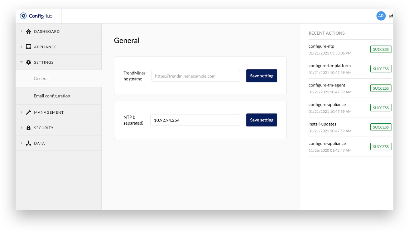

  4. This action will trigger the ‘configure-ntp’ task under ‘Recent Actions’ on the right side of the screen. Wait until the ‘configure-ntp’ task changes to the ‘SUCCESS’ status.
