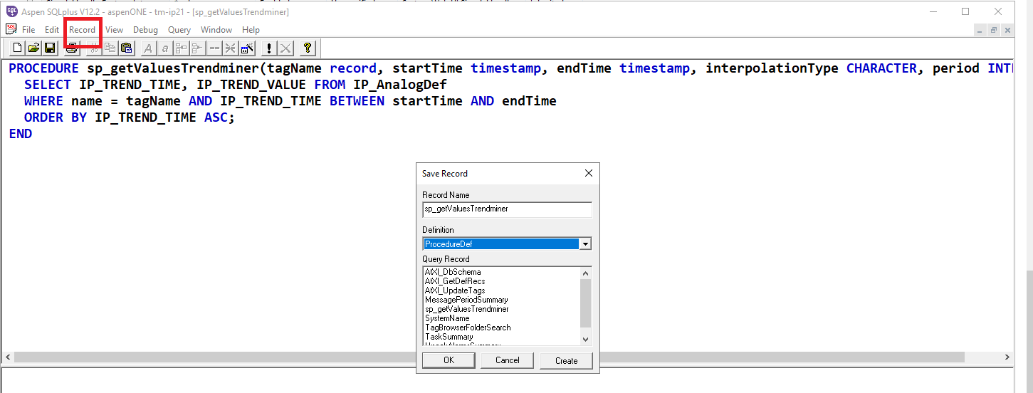

Open Aspen SQLPlus tool. Write the stored procedure, like:
PROCEDURE sp_getValuesTrendminer(tagName record, startTime timestamp, endTime timestamp, interpolationType CHARACTER, period INTEGER)
  SELECT IP_TREND_TIME, IP_TREND_VALUE FROM IP_AnalogDef
  WHERE name = tagName AND IP_TREND_TIME BETWEEN startTime AND endTime
  ORDER BY IP_TREND_TIME ASC;
END
Go to “Record->Save as” and save the SP with a given name.
The SP definition can be viewed from Aspen SQLPlus tool, Record->Open menu.
