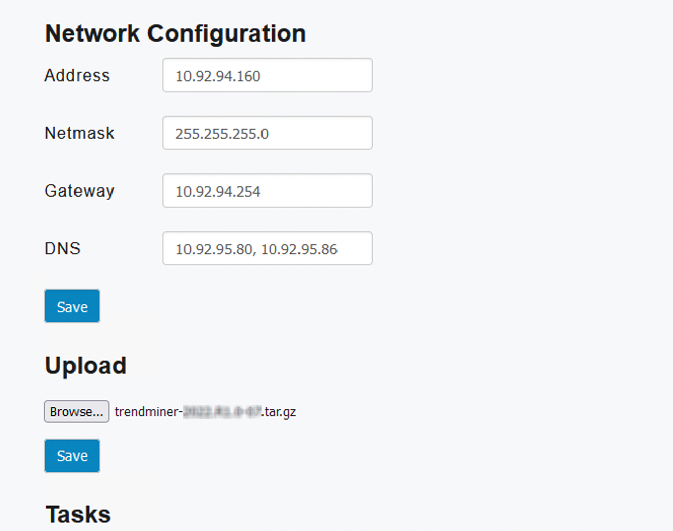

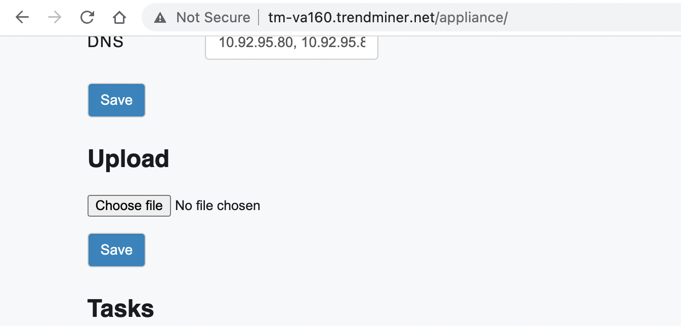

  2. Under ‘Upload’ click  ‘Choose File’.

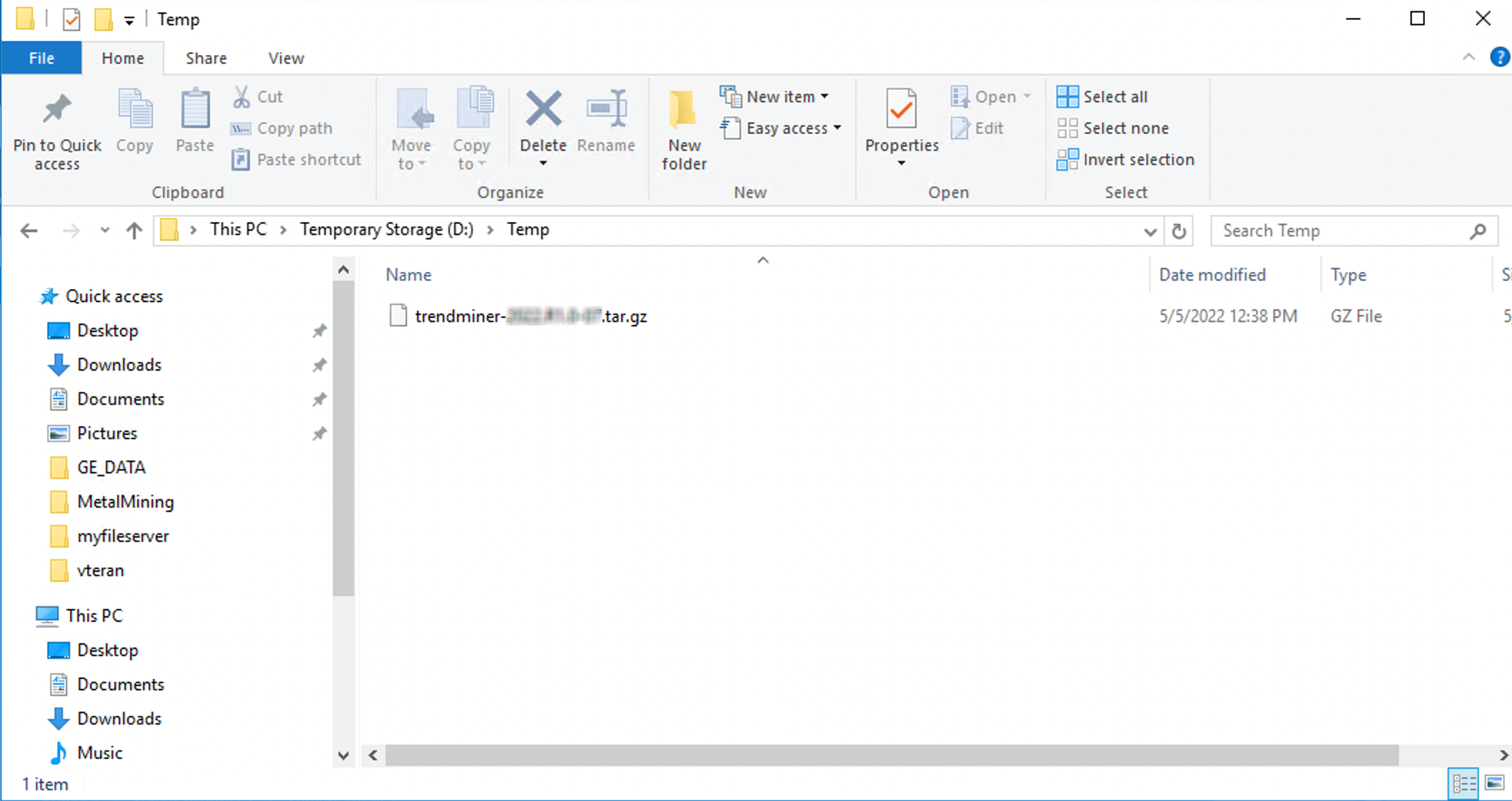

  3. Select the .tar.gz file containing the TrendMiner software and choose 'Open'.
  4. Click ‘Save’ to start the installation process.

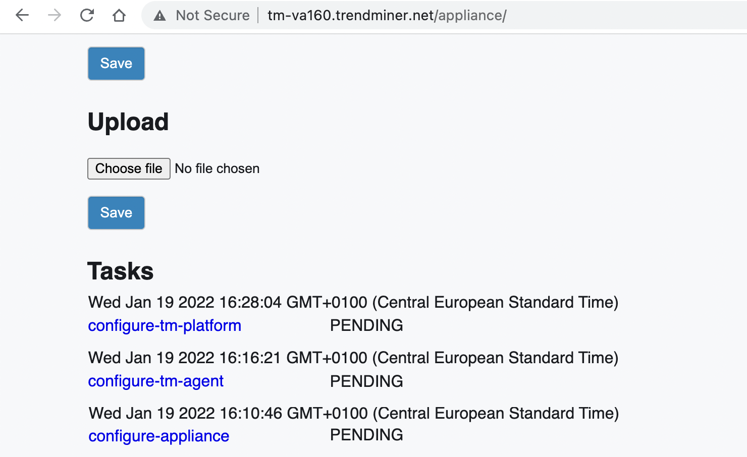

  5. Please wait until the installation file gets uploaded over to the TrendMiner server. Once uploading is completed, multiple new tasks under ‘Tasks’ section will be generated.
    Avis
    While the file is being uploaded there is no visual feedback on the progress. Since this file can be quite large it make take a while, depending on the network performance. Please do not refresh the page to not interrupt the upload.
    The 'Tasks' section displays the status of the most recent tasks. This may take a while.

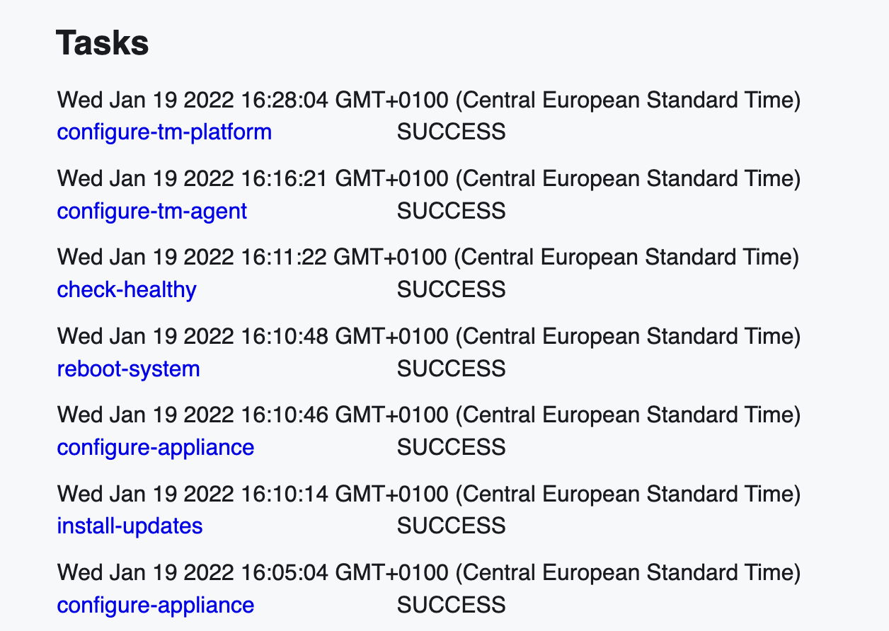

  6. Wait until all tasks show the ‘SUCCESS’ status.
