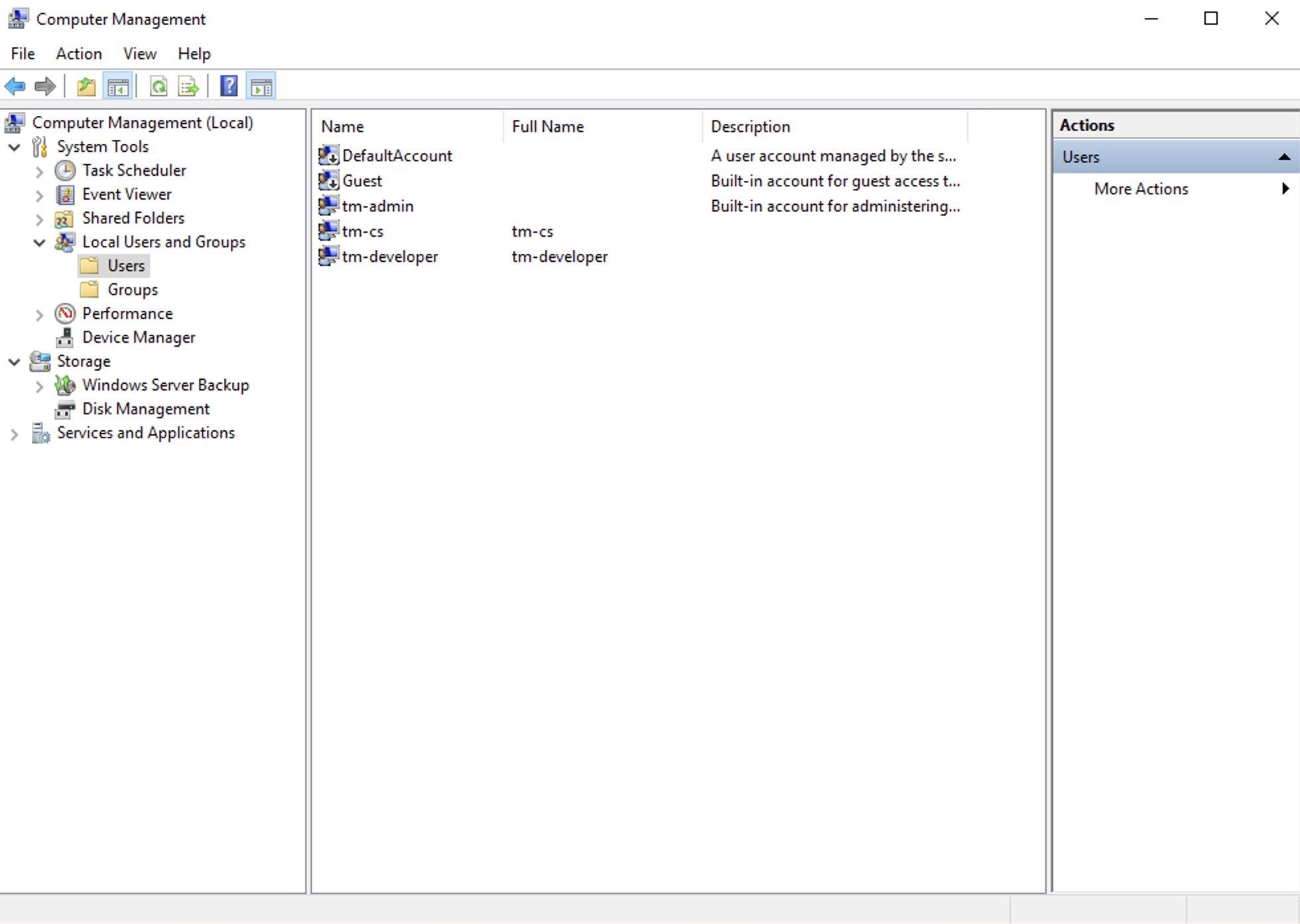

  1. On the Windows server, open 'Computer Management' -> 'Users' to add, remove and edit users and set passwords.

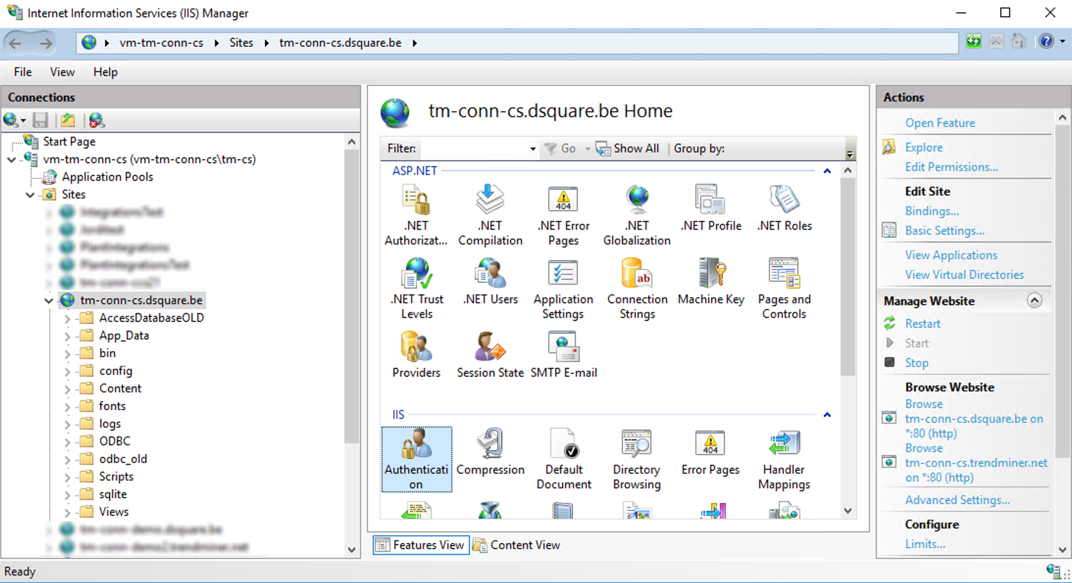

  2. In IIS, click on the connector (website) for which you want to enable basic authentication and open the 'authentication' menu.

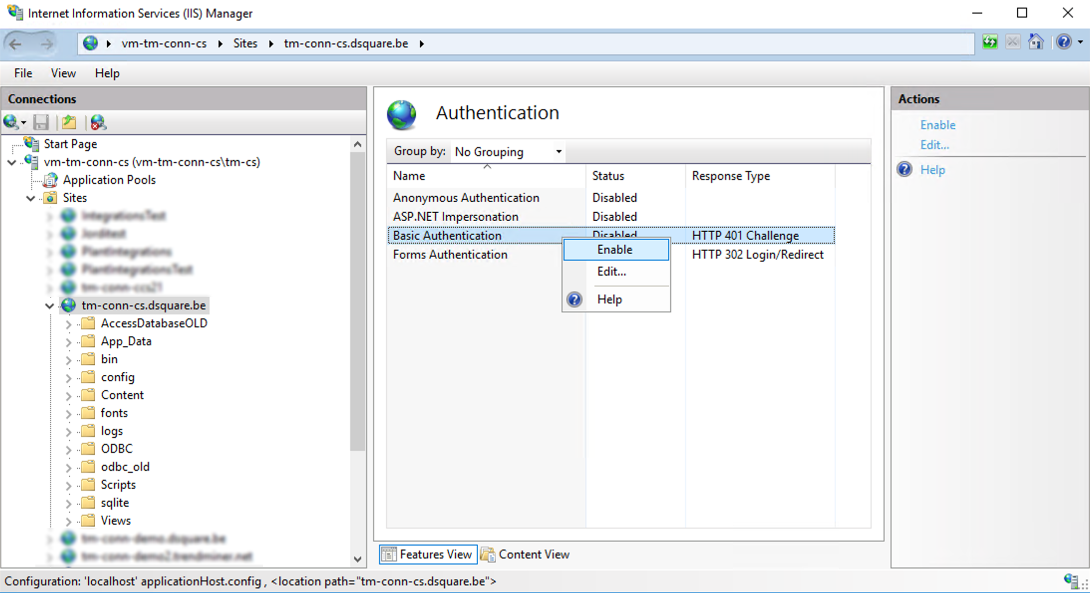

  3. Disable 'Anonymous Authentication' and enable 'Basic Authentication'.

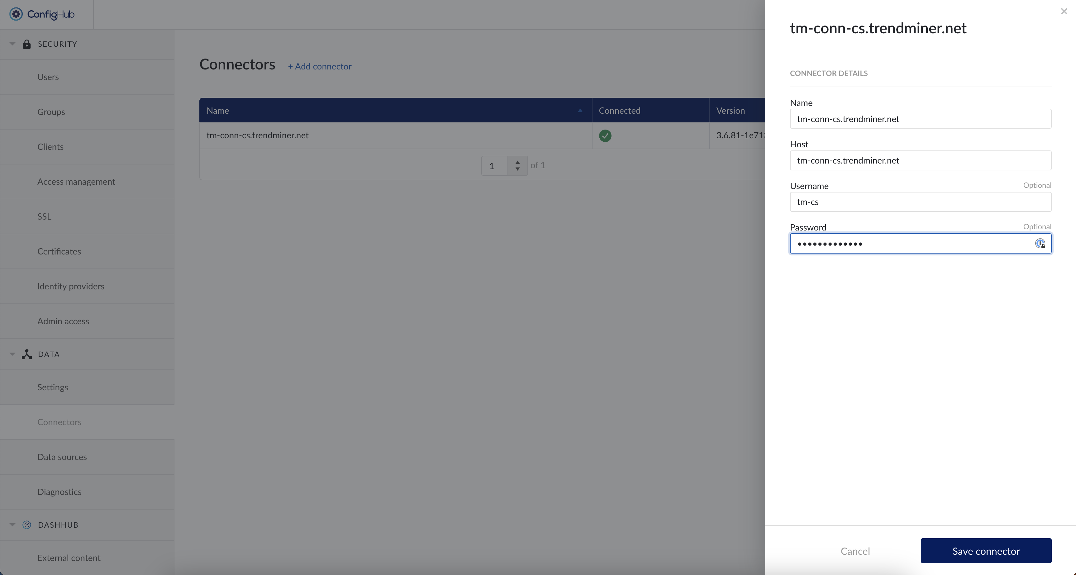

  4. In TrendMiner's ConfigHub -> Connectors, edit the connector details and configure a username and password.
