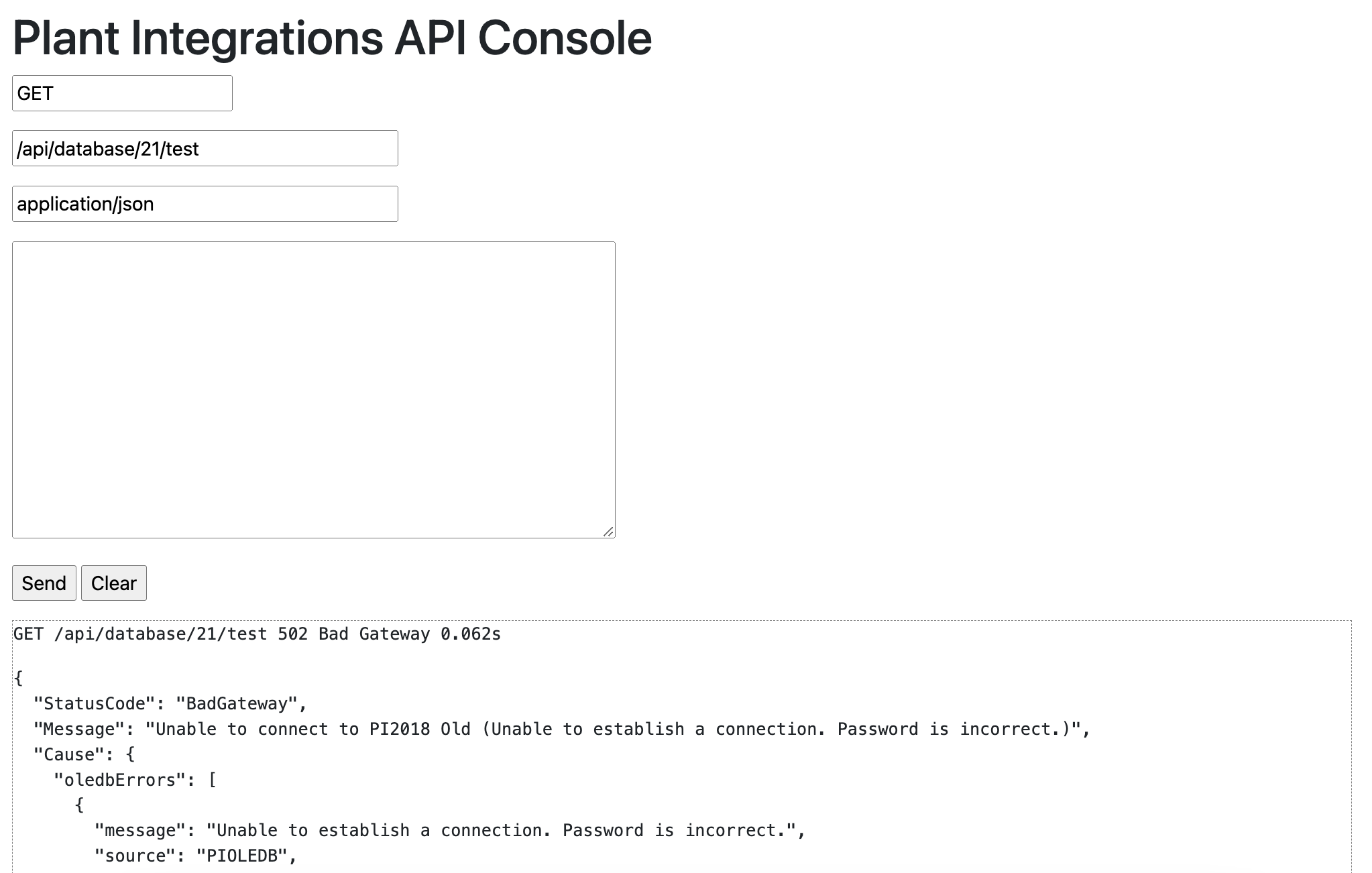

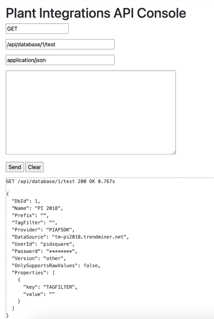

To know if TrendMiner can successfully connect to the data source a test endpoint can be called. If for example the wrong credentials are configured for that data source, the test will fail.
GET /api/database/<id>/test
Where <id> is replaced by the id from the data source, which can be retrieved with the database API call.
The result of this call shows the data source details, which indicates the connection was successful. If the test is unsuccessful an error will be shown, indicating the cause of the failure.
