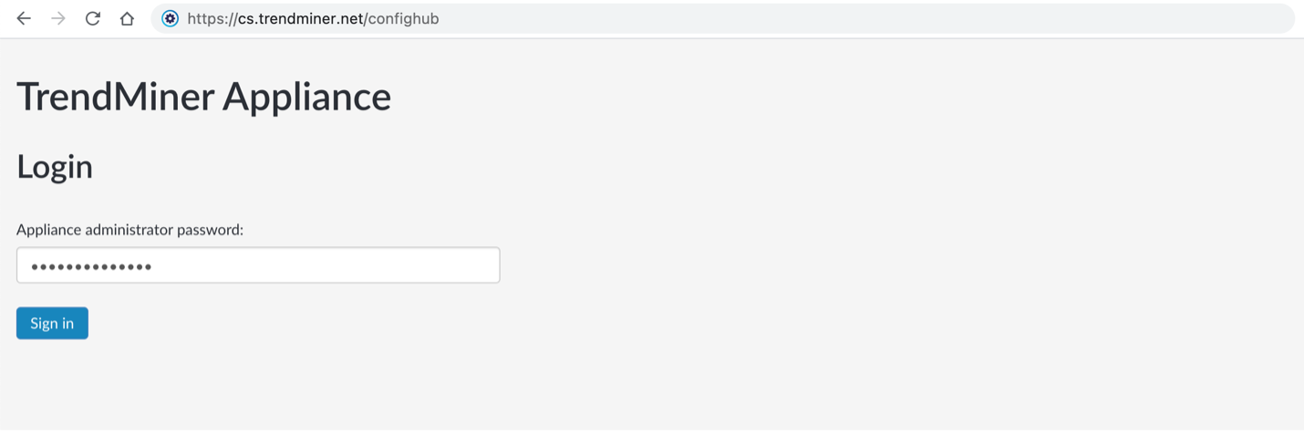

  1. Open the browser and browse to [trendminer_url]/confighub
  2. Enter the admin password for ConfigHub and sign in.

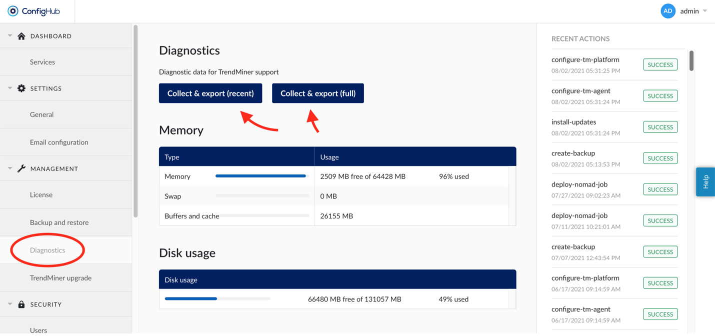

  3. Navigate to 'Diagnostics' and click on:
    1. 'Collect & export (recent)' for log files from an issue which just occurred (last hours).
    2. 'Collect & export (full)' for log files from the last 10 days for more elaborate investigation.

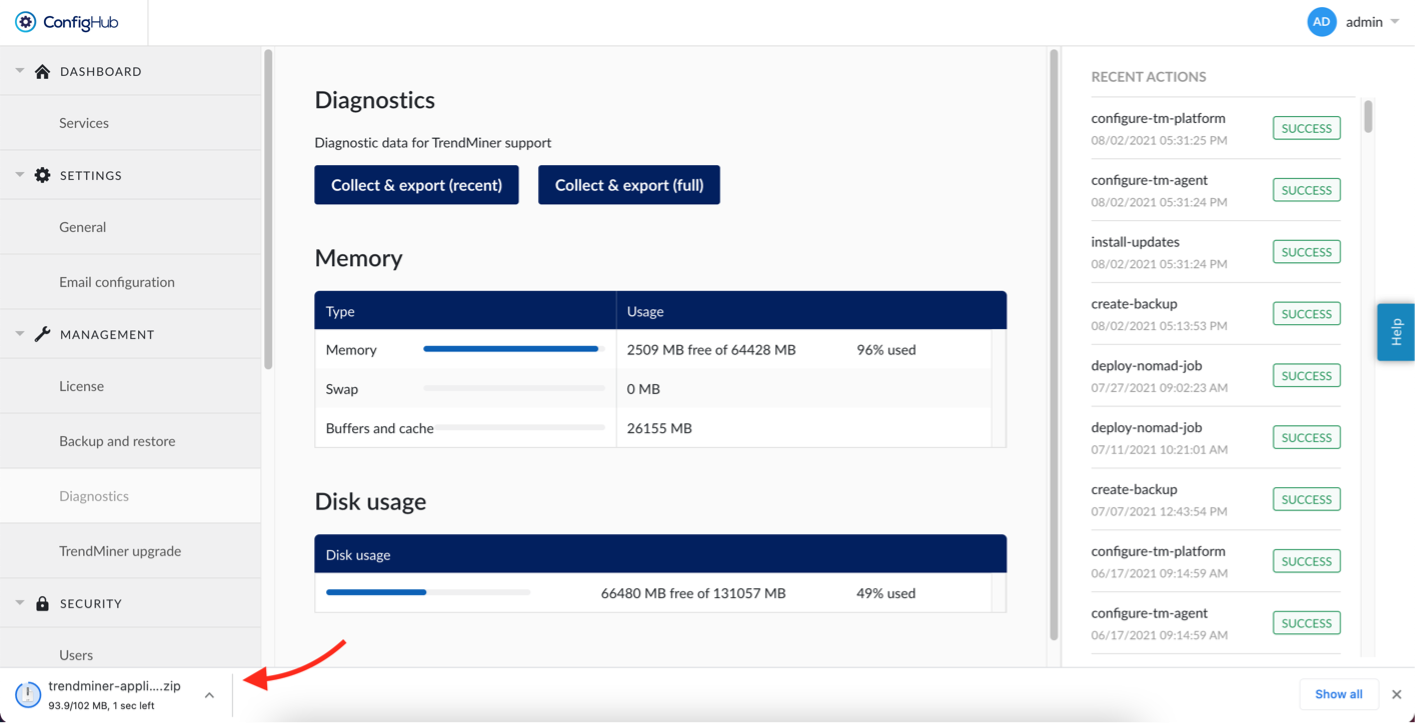

  4. Wait until the logs files are collected and downloaded.
