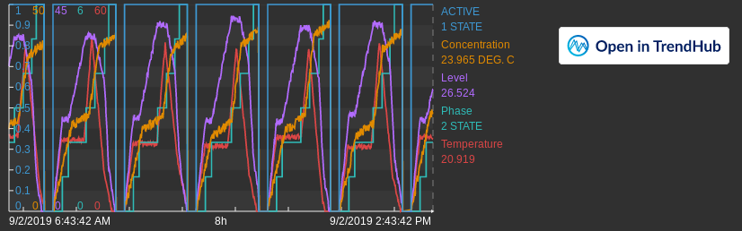

The TrendMiner PI Vision plugin enables you to send your data directly from your PI vision board to your TrendHub platform ready for analysis.
The advantage of this option is that there is now no need to look for your tags in the asset browser setup in TrendMiner, you select your tags in PI Vision and send them directly to TrendHub where they will be readily displayed for analysis.
With the first release of the PI Vision TrendMiner plugin, users can now access a PI Vision symbol in their symbol list.
The symbol can be configured with the url of your TrendMiner environment (cloud or on-premise) and optional prefix of the connected historian.
Once setup, the TrendMiner symbol in PI Vision can open up all the attributes on your PI Vision display in the TrendHub interface in the same time frame as defined in your display.
