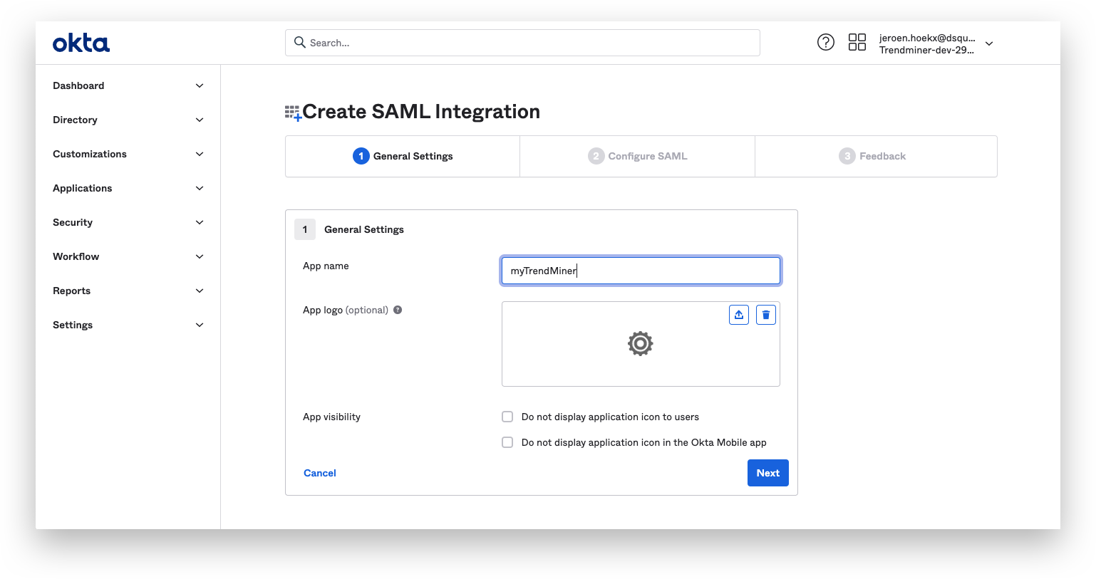

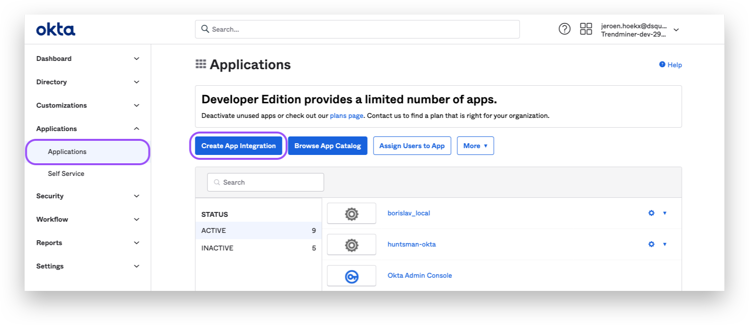

Create a new App Integration via the application menu.
Choose the SAML2.0 option.
Fill in your "App Name" and click next.

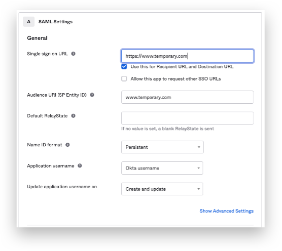

Fill out the details for the SAML settings and click on next when finished.
General settings:
Single sign on URL: Start by entering a temporary value. This will be overwritten at a later time.
Audience URI: Start by entering a temporary value. This will be overwritten at a later time.
Name ID format: Set to format of choice.
Application username: Okta username

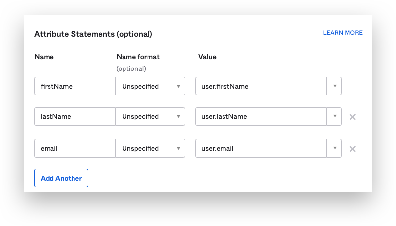

Add the following Attribute statements:
firstName / unspecified / user.firstName
lastName / unspecified / user.lastName
email / unspecified / user.email

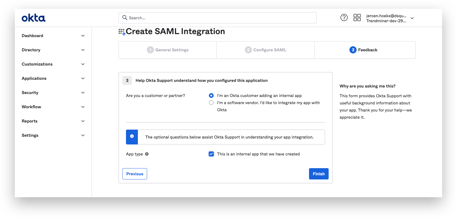

Select "I'm an Okta customer adding an internal app" + the "This is an internal app that we have created"-checkbox and click "Finish".

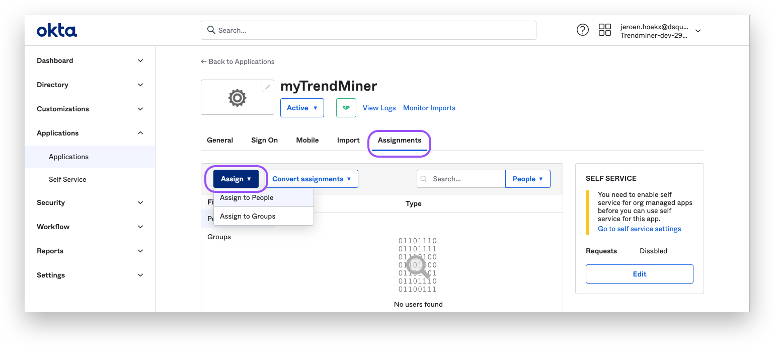

Add users/groups to the application:
Open the "Assignments"-tab
Click on the "Assign"-button to add users/groups to the application

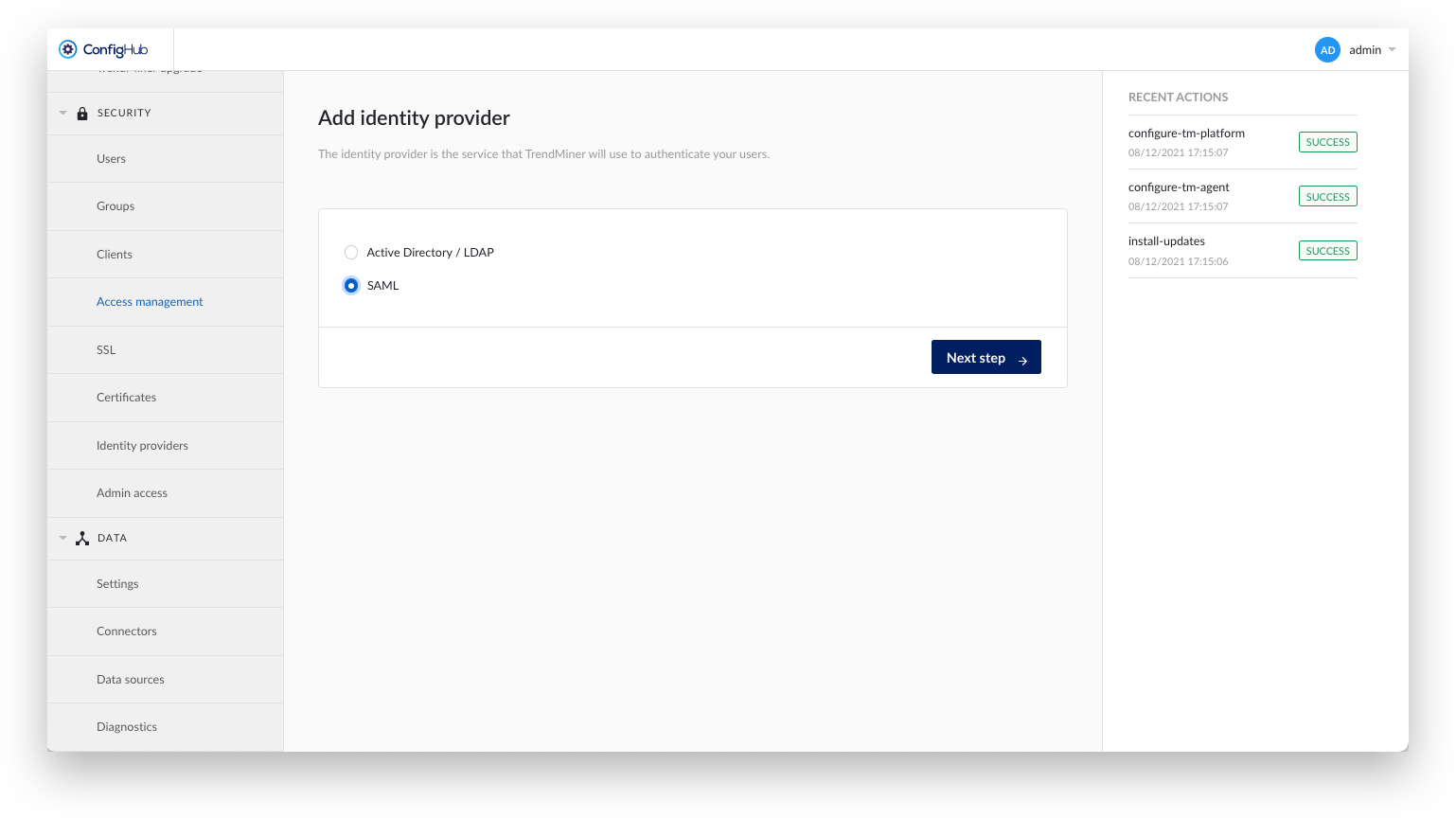

Select the SAML option.

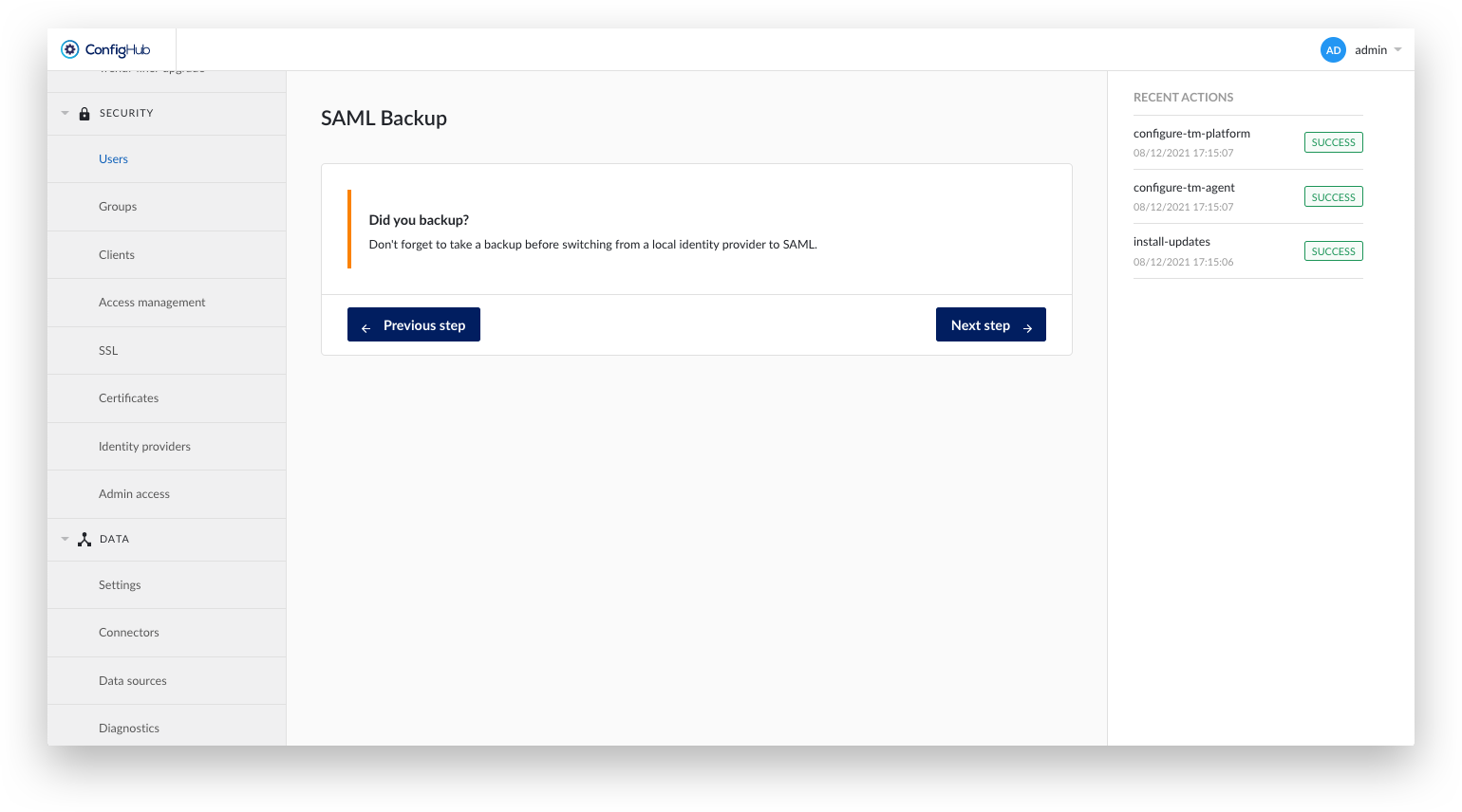

Create a TrendMiner backup.

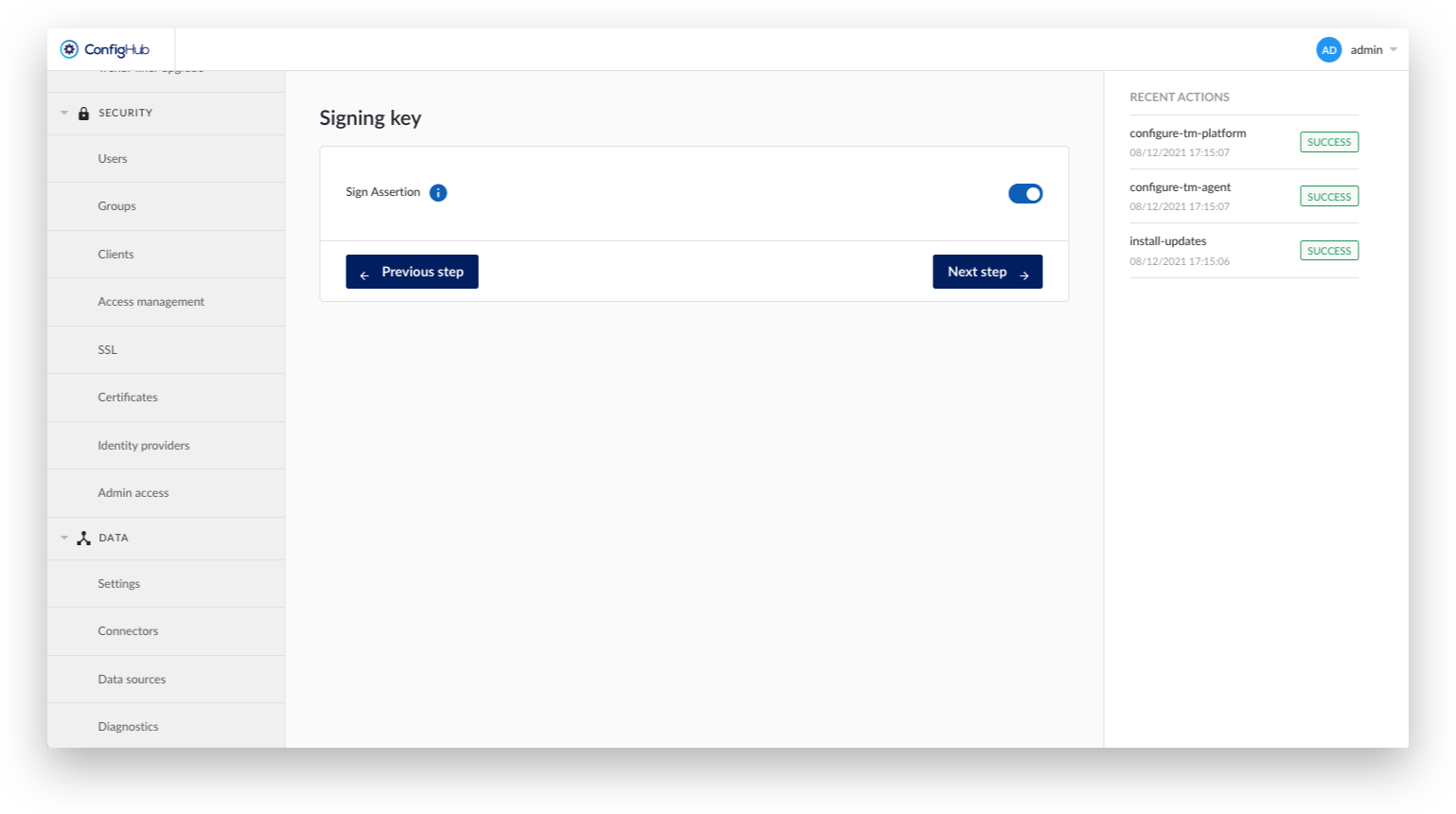

Indicate whether a signed Assertion is expected.

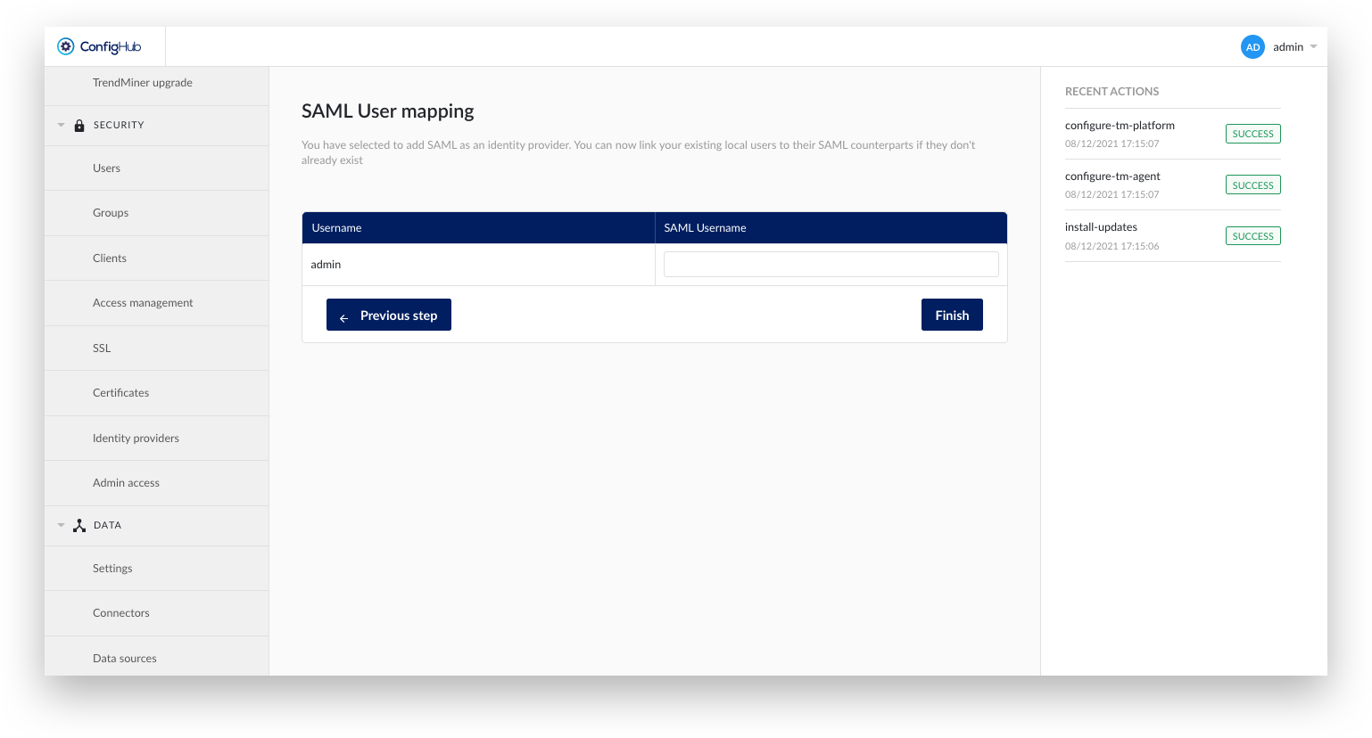

The next screen allows mapping existing (local) TrendMiner users to the SAML provider. The SAML username should correspond to the value returned by the IdP in the Subject-NameID tags. TrendMiner requests the NameId in the following format:

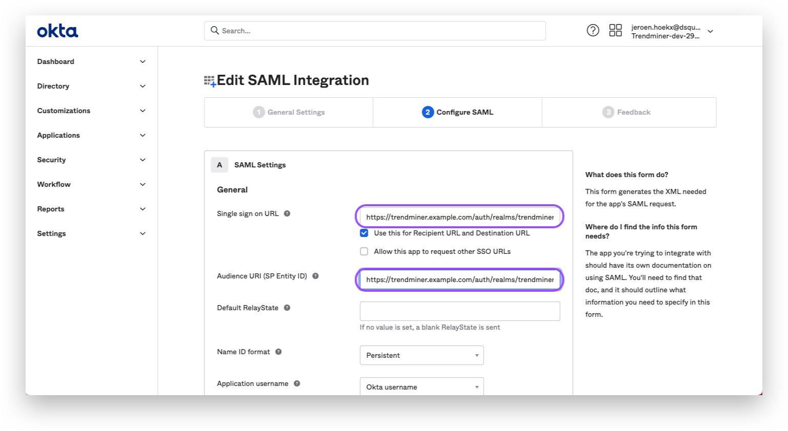

Copy the Location value from <md:SingleLogoutService>. In this example, this corresponds to: https://trendminer.example.com/auth/realms/trendminer/broker/7fc6524e-3d55-4ae2-9edf-3d678e376063/endpoint. This URL needs to be added in OKTA.

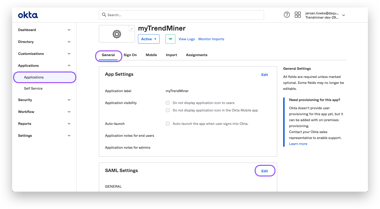

Navigate to your application in Okta and open the "General"-tab.
Click "edit" for the SAML settings and proceed to step 2 "Configure SAML".
Change the "Single sign on URL" and "Audience URI" to the copied URL.
