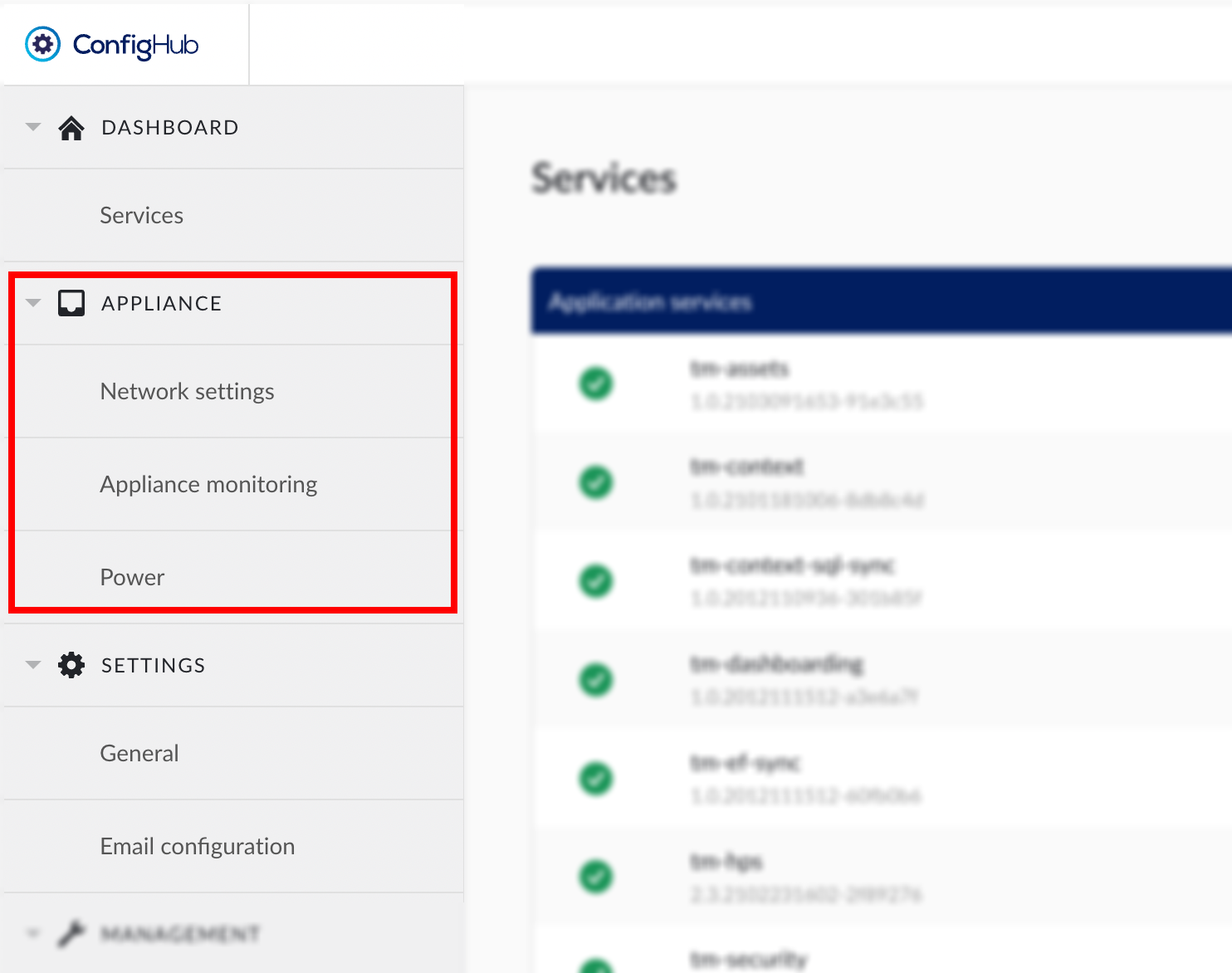

An easy way to check if you are running TrendMiner as a virtual appliance or a single node is by opening ConfigHub and checking the left menu. If you see a section called "APPLIANCE" you know you are running TrendMiner as a virtual appliance.
Single node installations will not show this section in ConfigHub.
