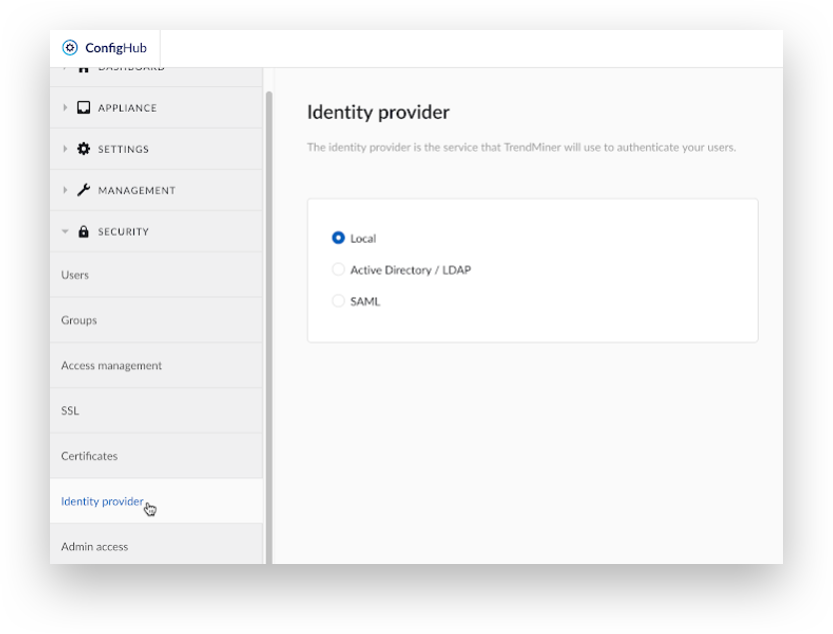

Go to the 'Identity provider' section under the SECURITY menu.
Select the ‘Active Directory / LDAP’ option and click ‘Next step’.
To allow rollback to the final non-AD/LDAP state, create a backup first, otherwise click ‘Next step’.

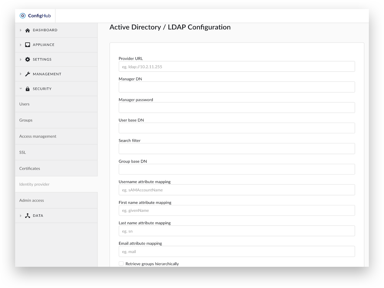

Fill Out the Active Directory / LDAP Configuration section.
TrendMiner integrates with Active Directory / LDAP for user management and permissions management. Users are found by starting at a configurable point in the LDAP tree structure. TrendMiner will then recursively descend the tree and select users that match a given filter query.
Provider URL: The hostname of the LDAP server, including the protocol ldap://
Manager DN: The user that lists the users that will receive access to TrendMiner. This user must have query permissions on this server. It can be specified by full DN or by domain\user notation. Typically a ‘service’ account with a password that does not expire is used.
Manager password: The password of the user.
User base DN: The DN of the starting point of tree walking for users. All users must be descendants of this node.
Search filter: A filter to restrict the users that are permitted to access TrendMiner (eg. (objectCategory=Person) will select all users).
Group base DN: The DN of the starting point of tree walking for groups. Groups are used for permission management in TrendMiner. This does not influence which users are allowed access.
Username attribute mapping: The name of the attribute that represents the username of the user.
First name attribute mapping: This attribute points to the user's first name.
Last name attribute mapping: this attribute points to the user's surname or last name.
Email attribute mapping: mail address of the user.
Retrieve groups hierarchically: enable to descend the tree for groups starting at the Group base DN.

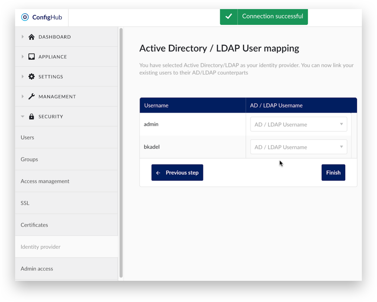

Click the 'Test connection' button to validate the configuration
Click ‘Next Step’.
A 'Connection successful' message will display at the top of the screen.

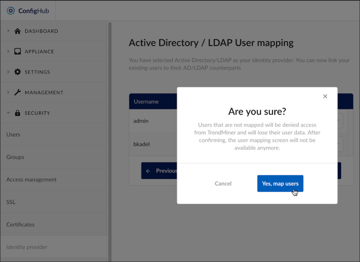

Select the corresponding Active Directory / LDAP user for each existing local user. Click ‘Finish’ to complete the user mapping.
Click ‘Yes, map users’ to confirm the user mapping.
At the top of the screen, a message saying ‘Users have been mapped and will be available in a few minutes’ will display. Local users that are not mapped to an Active Directory / LDAP account will no longer be accessible.
