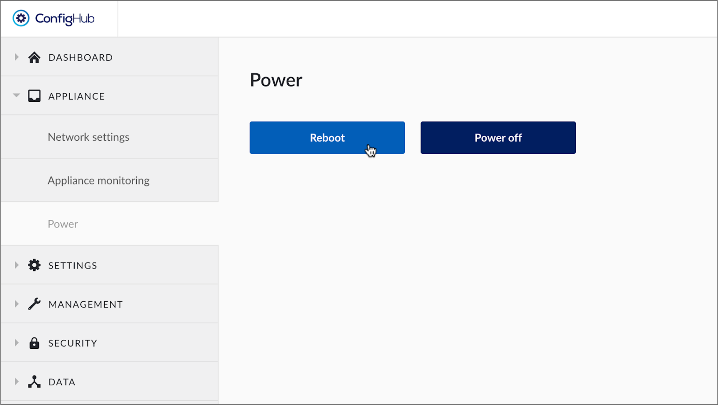

When not using the TrendMiner Virtual Appliance, please follow the existing internal procedure to reboot the server. Reboot the TrendMiner Virtual Appliance from the ConfigHub portal. Expand the ‘APPLIANCE’ menu and go to the ‘Power’ section. Click ‘Reboot’ button.

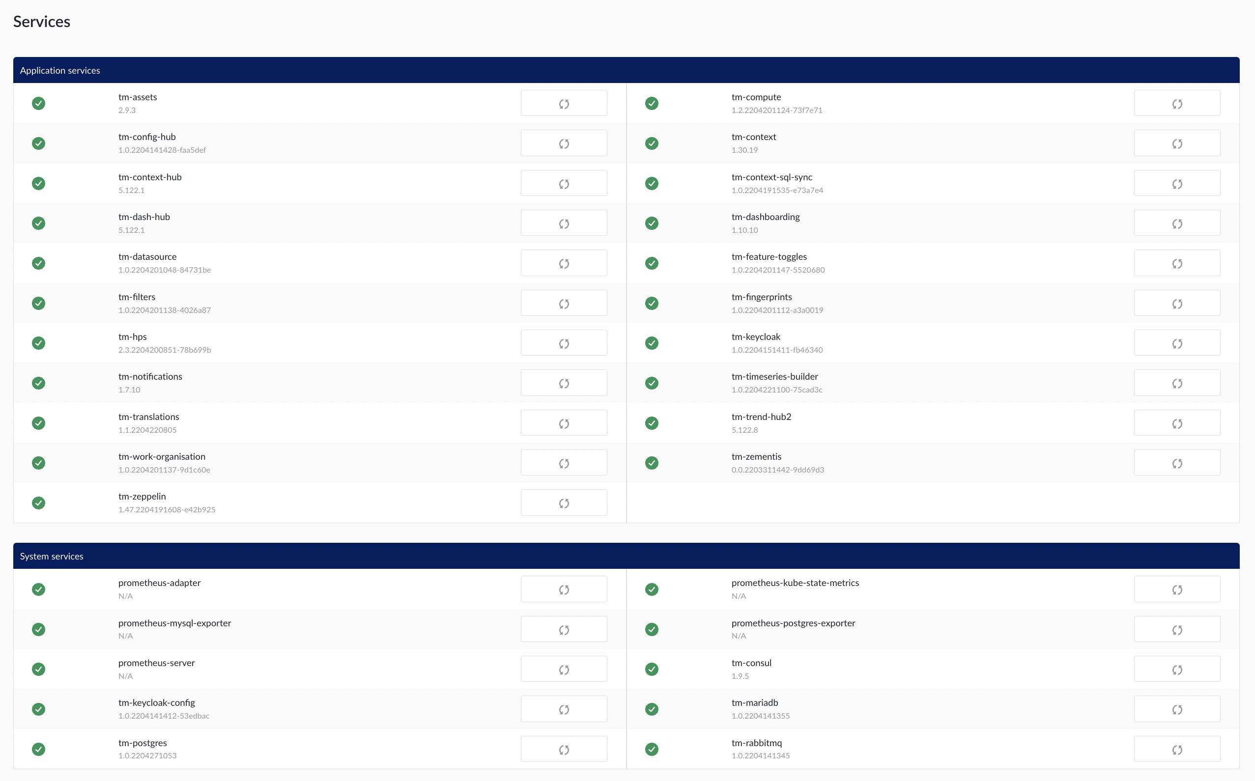

Once rebooted, make sure all the services are healthy in the ConfigHub ‘Services’ page.
At this point, you have successfully updated TrendMiner to the 2021.R3.0 version. If you experience any issues during the upgrade, don't hesitate to reach out to TrendMiner support.
